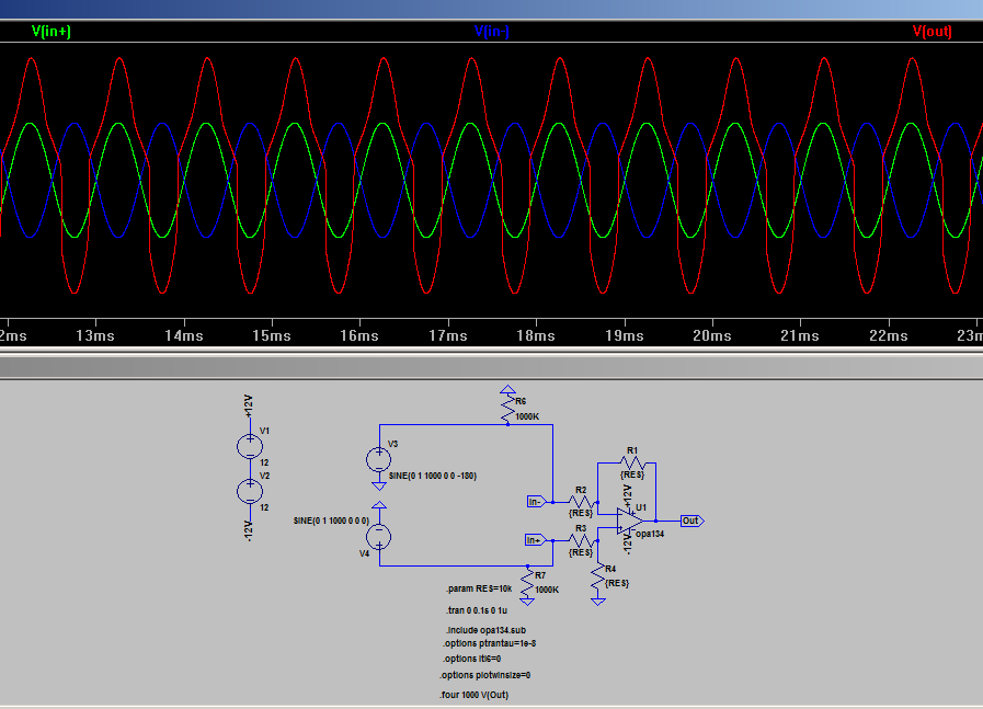

I tried a simulation today that gave me an unexpected result. I'm not sure if this is a case of:
a) I have no idea what I am doing
b) The opamp is not suitable for the task
c) the model is way off
d) there is something going wrong in spice
e) something has possesed my computer and thinks it is funny to turn sine waves in to condoms.
I'm trying to model a simple balanced to unbalanced converter. I bought some LM4562 Opamps which I blew up on the weekend 🙄 due to stupidity, so perhaps option a) is the most likely. I then re-read the datasheet and found that they were limited to 0.7V input so were not suitable anyway and decided to try with the venerable opa2134.
Anyway circuit and output attached. 27% THD! and what a horrid waveform....

Any pointers as to what I have missed greatly appreciated 😉
Tony.

Hi ... well, looks like a strange output waveform ... I'm not an expert on this and are not familiar with all of the spice directives you use. But I notice that the supply voltages you use are not grounded in between the two supplies ...
Also, if you are not familiar with the spice directives you use a basic testing state could be to only include the .tran & .include opa134.sub directives. Also, instead of the .param for the resistors you might just make them plain resistors.
Are you sure your opa134 model is correct?
Maybe just using one voltage source at the input could help - connected on both sides of the voltage source to the non & inverting pins of the opamp ... ?
Those are my suggestions ... good luck with it ;-)
Jesper

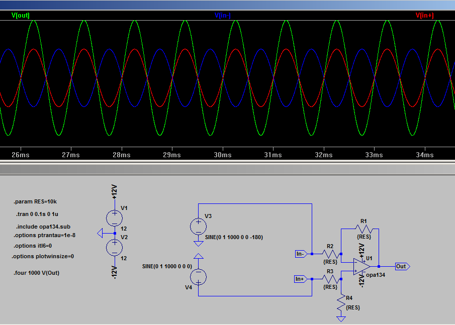

the prominent failures are the floating supplies.
Add a gnd-node between V1 and V2.
The resistors R6 and R7 are obsolete ... delete them.
I´ve seen the ptrantau command before, but couldn´t find its meaning at once.
What ís the second options command?
All else are correct commands.
Attached is a working sim.
To make my life easier, I´ve stored the complete command block with the supply and signal voltages as "sim basic params"-file.
So I can load the file, add the circuit and store the whole under a different name and have the most important sims right at hand.
The parameters for an FFT are automatically set.
You just need to define the parameter signal frequency (Freq) and signal voltage (Vin).
The DS of the LM4562 specs the Input Voltage Range on Page3 under Absolute Maximum Ratings to (V-)-0.7V and (V+)+0.7V and the Maximum Supply voltage Vs to 36V, with Vs=(V+)-(V-).
With symmetrical supply voltages this calculates to +-18.7V maximum input voltage.
jauu
Calvin

Thank you calvin option a it was. an ID 10T error 😉 R6 and R7 were added in a desperate attempt to work out what was missing, I had a feeling it was a ground reference problem (I tried a ground resistor on the output as well) but it was the most basic of ground reference problems. DOH!
Jesper, the various extra directives are things that make getting clean fft's easier. I think the ptrantou was actually to disable one of the solvers that was causing issues with my synergy active crossover sim (I just copied the options accross).
I simply added the ground between the voltage sources and it works perfectly (at least in the sim) 🙂

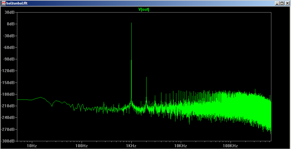

0.11ppm distortion !
the grass seems high in proportion to the measured harmonics, but the level is so low @ >-150dB that it's probably a good indicator that the sim is optimised.

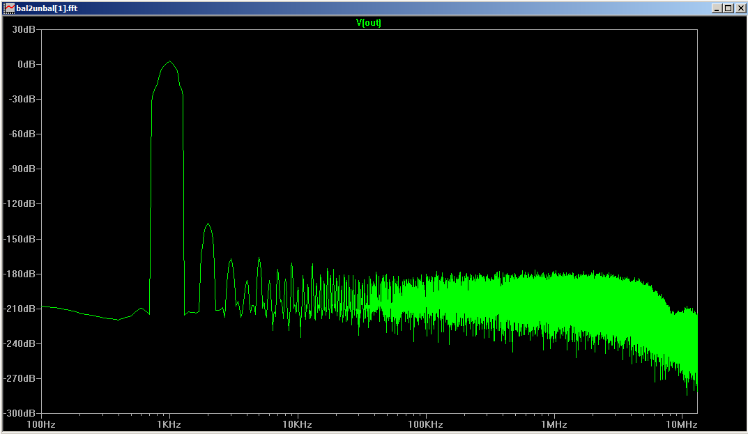

The sim could be optimized some more, I haven't done any tricky stuff like taking into account the period in the fourier statement. This was a quick and dirty one. I DID re-run the sim for the fft above, though changing to 0.6 seconds run time, saving from 0.4 seconds on. new .tran 0 0.6s 0.4s 1u
I normally use a 0.1u step for really fine ffts but it takes a long time to calculate.
I just ran it again with my "normal" long simulation command. .tran 0 220m 120m 0.1u part of the reason for all the grass in the above plot is the long time window for the fft (200ms)
Below is the result from the 0.1uS step 220ms run (saving from 120ms on), but only specifying 90-100ms in the fft and blackman windowing. It gives a much clearer view of what is happening with the harmonics. The fundamental is at +4db and the 2nd harmonic is at -135db so it is pretty much all 2nd harmonic that is giving the fft result of 0.000011%
Tony.

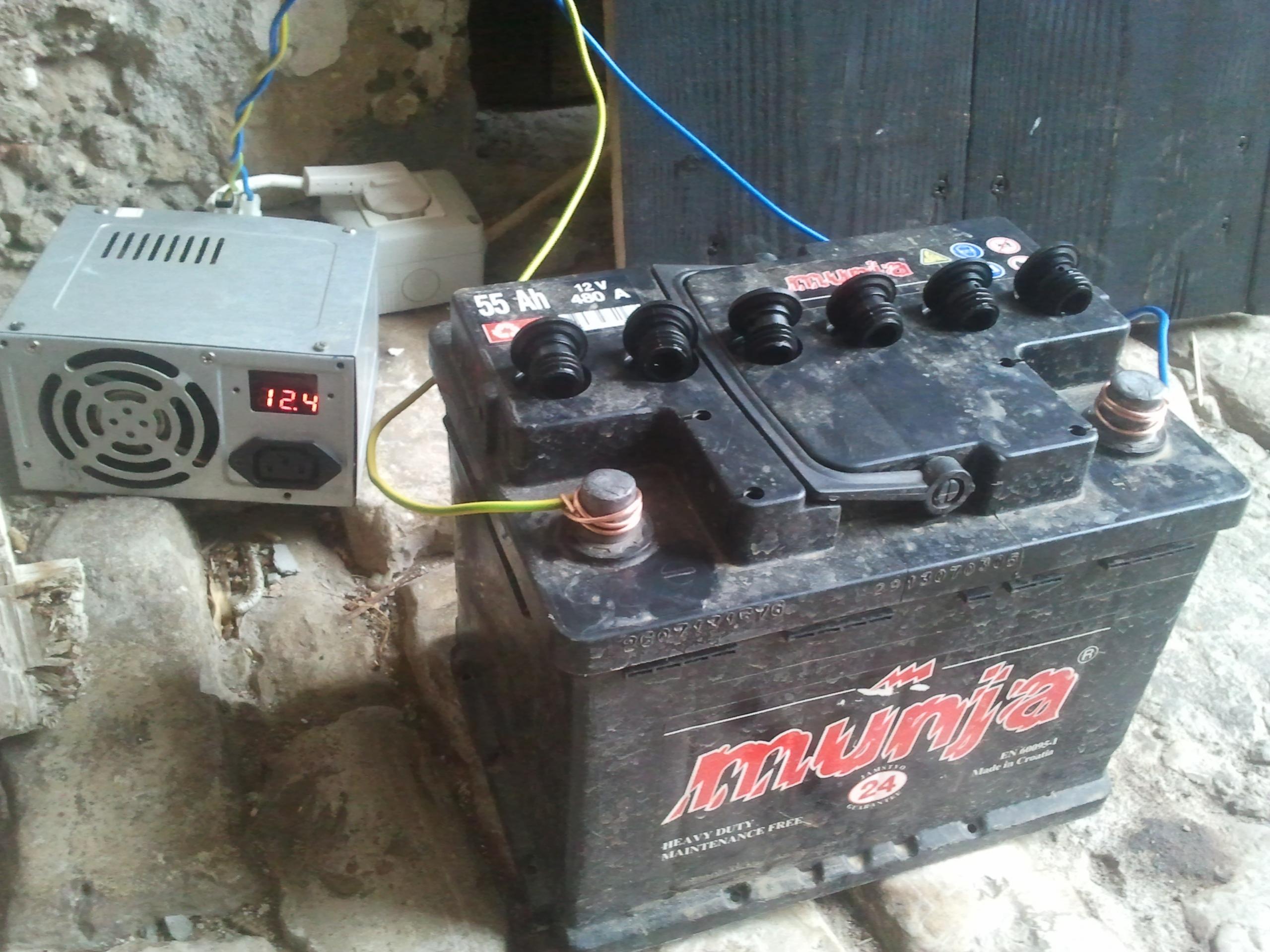

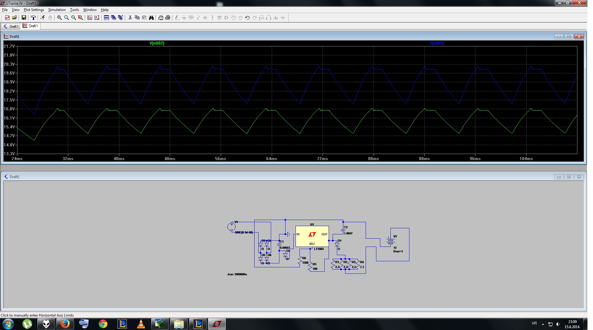

i used pspice to simulate car battery charger i make almost half year ago and it charged well every battery from small gel 7,2ah to 120ah truck battery, i was boring today and as i have no real life scope i try to make simulation in pspice and results are horrible(?) , now i am starting to suspect i missed something in actual charger and my first bet would be more capacitance before regulator what get me realy nice dc no ripple not like that picture here ,are this programs real accurate?
in attach pics and pspice model thank you for help
470uF is not enough for a very high output current, so for sure the ripple will be too large if your battery draws a lot of current.
thank you on fast answer, now when i look inside charger again i switched c1 and c2 when making it , and now when switched it back it wont work well there is more ripple on output , are this generic diodes in pspice ok ? and how can i edit them i have datasheet and .txt model of ones i am using?
Right-click on the diodes, click 'pick new diode' and choose a suitable diode. You can click on one lead of the diode, drag to the other lead and release, and this will show you the voltage across the diode.
The battery will charge fine with ripple on the supply. There are some techniques (probably discredited) for pulse charging batteries to get more power into them. The circuit is essentially a resistor limited charging circuit. It doesn't have any sophistication in limiting the current when the battery reaches full charge etc.
Most commercial chargers have just enough cap to function (more costs more. . .)
