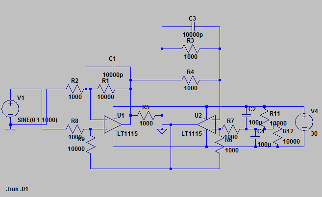

There is one other type of arrangement that I found also quite interesting, although not used much and not in commercial amps: it's a sort of bridge, with a class A amp, plus a plain class B on the other side that is used to drive the class A's rails to higher levels as needed when power increases.
This allows a more powerful class A amp without the drawbacks of very high dissipation and running hot when idling.
Those QSC amps are widely used and commercialized, so are the grounded bridges from crown and others, but that mix of class A and B in a bridge arrangement hasn't caught on. It may not be so practical after all. I think it was invented by a japanese. Very clever though.
