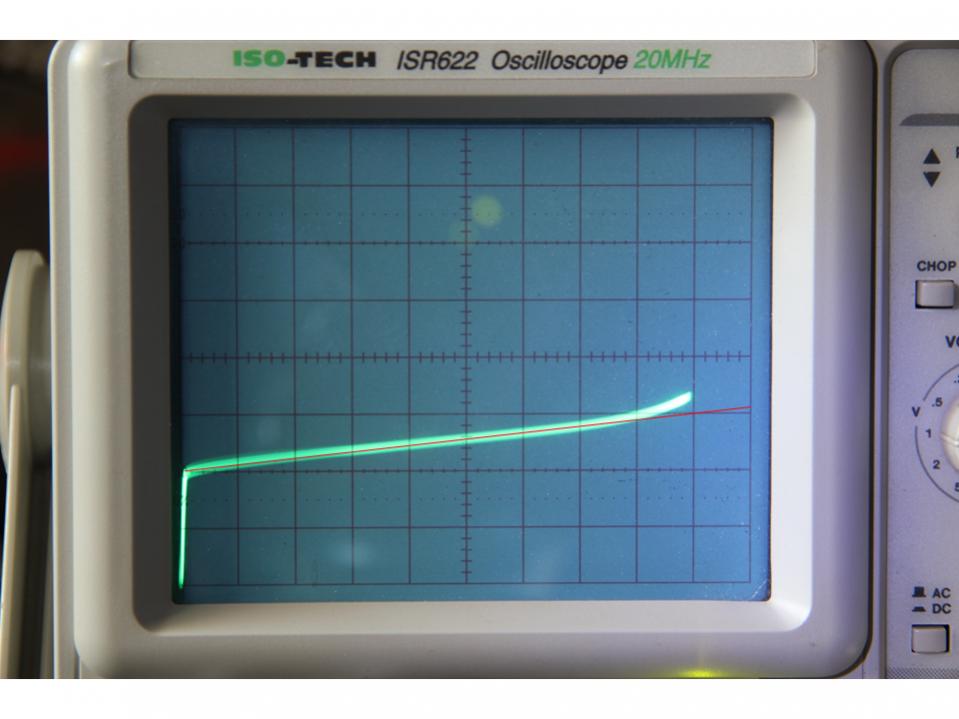

I've been looking for more reliable and confirmed good models for the 2N3055 and MJ2955, and what I found so far doesn't fare very well.
Some simulations deal fine with poor models, others completely crap out, and I have been dealing with a leach super amp simulation lately that I'm trying to get working with 2N3055/MJ2955, and none of the models I have allowed it to work properly.
I have simplified models from ST, which I put on a test rig and I can see it's way overly simplified. No wonder the sims can't deal with that.
I've used models from onsemi made by modpex, and those aren't very good either.
Plus there is always some confusion with the 2N3055 models, with some supposed to be for the 2N3055H, which did exist long ago, but now those models seem identical to the regular 3055. There is a 2N3055A, slightly different, and still not working out so well either.
Some are using the models for the TIP/MJE flavors, and they're somewhat similar, but not so good as well.
So I'm looking for more reliable models for the 2N3055 and MJ2955.

For 2N3055G I'm using ON Semi's model but with modified hFE (BF) obtained from the measurements of the real transistors.
This is the starting model:
This model is the one from modpex as is, and it is identical to the one I have, so it's un-tweaked.
Have you only tweaked BF ? By how much?
But I suspect there is far more to tweak than just hfe.
Last lot tested (2N3055G) had BF=78...110. Was a lot bought from China, very cheap but also low quality.
You are right, probably we should redraw the operational curves of each transistor in order to build real models but I didn't find any reason to do this. I use Multisim only to check how the circuit is working, as a preliminary test before build.
But this info can help, along with the datasheet data, to come up with typical/average values that can be expected from parts in the wild, and we can plug this into the models to tweak them to better reflect the real thing.
There are many parameters though, so it's not that easy. The gain is an easy one to tweak.

Here is a photo of an ON Semi 2N3055 operating at 200mA swept up to 90V.VAF=31.1252
The red line is my simple gradient detector and fitting the parameters to this gives VAF=181V.
Some difference.
