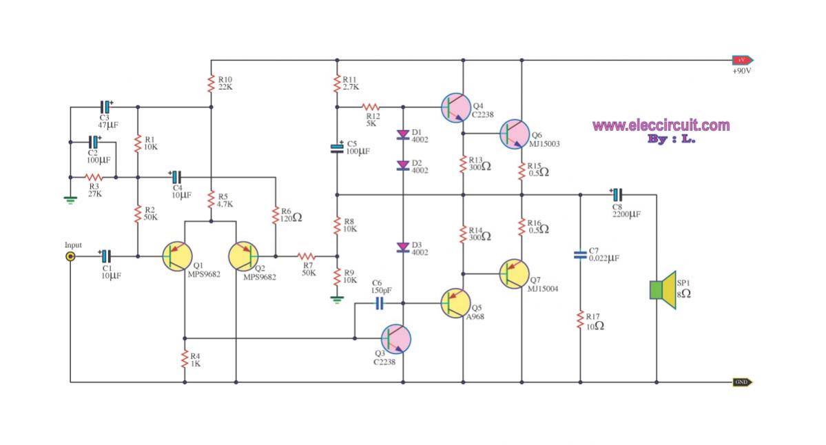

I'm trying to simulate a very simple power amp and am getting bogus results. I've got the actual circuit working, but when I plug in the values I used, the output is driven to the negative rail.
I've tried this with Falstad's circuit simulator and SIMetrix with similar results.
I've checked and checked my schematic capture and it is like the amp I built. Unfortunately, the simulator thinks the circuit doesn't work.
It's my first time with a simulator and need some help. The Falstad circuit simulator is quick, easy and very cool. But the output is suspect. Because I get similar results with two simulators, I'm thinking it might be me.
Is this the right thread to ask for help?
Circuit
Thanks for your offer to help. Here is the picture:
The following is the net list exported from the Falstad simulator. You can run the Java applet at falsted.com. To import you would just paste the following into the import window in Falsted.

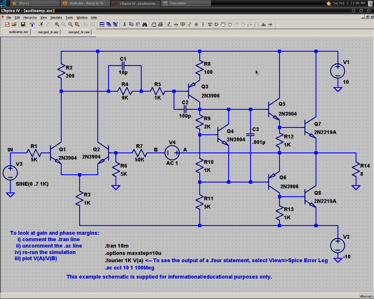

It looks like the schematic is drawn wrong. You circuit is a jumble of at least 3 different topologies in a way that can't possibly work. Why don't you post your inspiration for the circuit, or find a proven schematic online to work with?
LTSpice is what I use, and it has an Education folder with a simple power amp example.

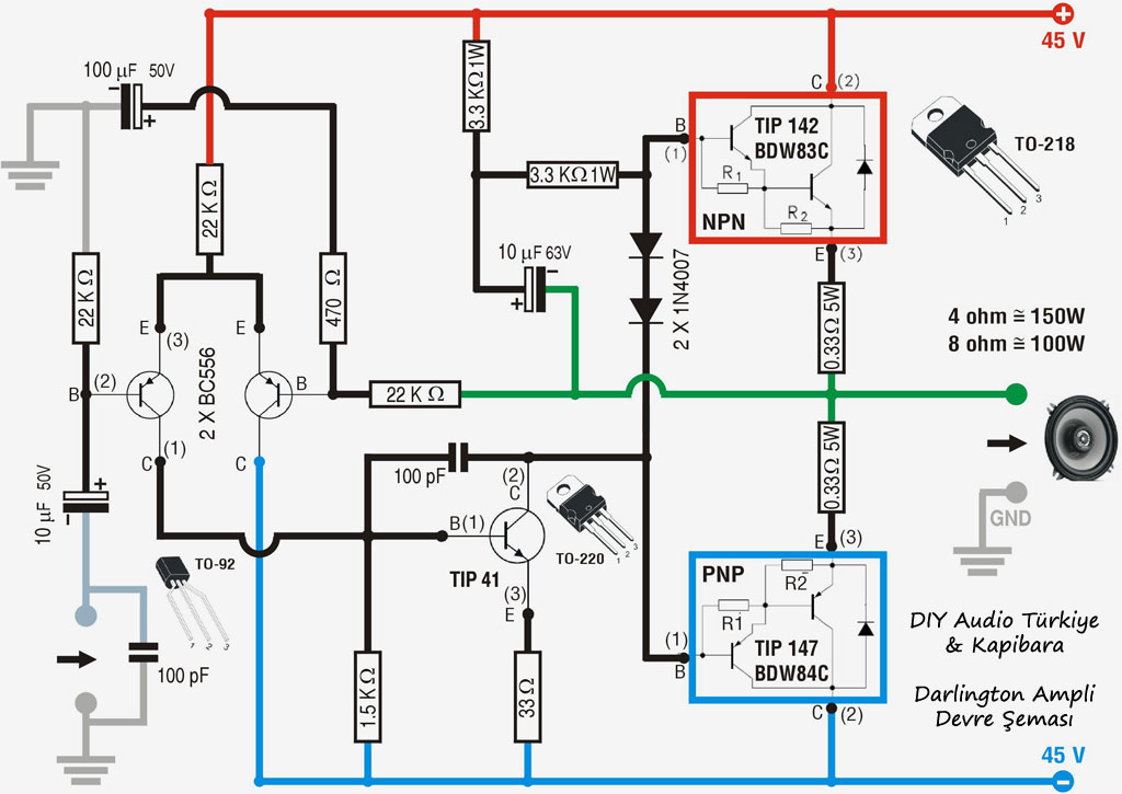

Original Inspiration
Here is the original inspiration...
Here's another one very much like it...
In my schematic, I simply made the TIP142/147 darlingtons into discrete pairs. That was after I tried single transistors with very high hfe. That didn't work either.
Yeah, I might have drawn the schematic wrong, but I can't find the error.

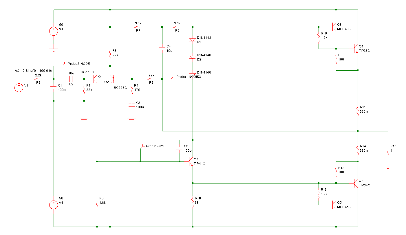

I'll try LTSpice again. I installed it but stopped working with it because I don't get the user interface. I entered the schematic, but can't figure out how to get steady state plots in Volts for a transient analysis.
Here's my LTSpice schematic. This is just a text file saved from the original ASC file. If you save it as an .asc file, LTSpice will open it.
View attachment SOCheap150.txt
I found one small problem in the Falstad circuit. It's the 10uF cap between base and emitter of the driver. It should be a 100pF between base and collector. It doesn't make much difference in the simulation. Here's the corrected circuit:
