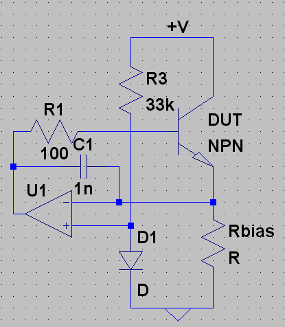

Think of a CCS. An opamp is ideal here rather than the normal double-diode base bias because of the enormous amount of current the transistor will suck through its base at high currents (wait, who said anything about high currents? I think I'm confused).
Anyways, if I wanted to test at high currents, I would use something like the circuit attached.
I suppose it all depends on what parts are at hand. It's not totally important, as long as Ic is roughly constant and we can measure the Bf at that point. If you say what parts you have on hand it should be easy to throw something together.

50Vce & Ic=10A equates to 500W.(wait, I just had a thought though. Wouldn't Bf increase anyways if we increased Vce because we would be heating up the die?)
How few microseconds (us) can you pass this power and what duty cycle and yet still take measurements without exceeding SOA when Tj<=150degC or Tj<=70degC or Tj<=25degC?
My plan would be to test at a level within the SOA for about 1 second, and see how the voltage used and current generated compares to the hfe at higher levels.
that is precisely where he wants to measure hFE.
Datasheet shows single shot 10ms pulse with Tj=25degC @ 50Vce
I suspect the graph label Tj should be Tc=25degC.
Single shot pulse of 1second limits the current to 3A @ 50Vce.

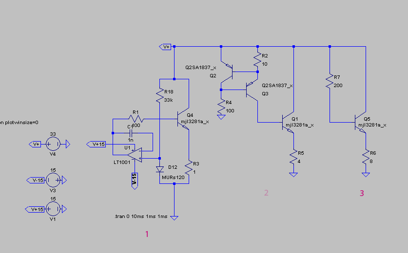

I tried three different layouts. I have a 33v supply, and a 8ohm resistor array rated at about 240watts. Schemes 1 and 2 don't get me very close to the current without lowering the resistor R3(scheme 1) or R5(scheme 2) below the 8 ohms. Scheme 3 simulates fine and resistor R7 isn't disipating too much heat (174mw). Scheme 3 does 3.28A and can be dialed up via R7 reduction. Is Scheme 3 crazy? My supply is robust, but, I don't want to blow up a capacitor or something...
I'm going to look at my DMM and see if it has a peak sample type function. Then I could pulse the switch and dial up the current.

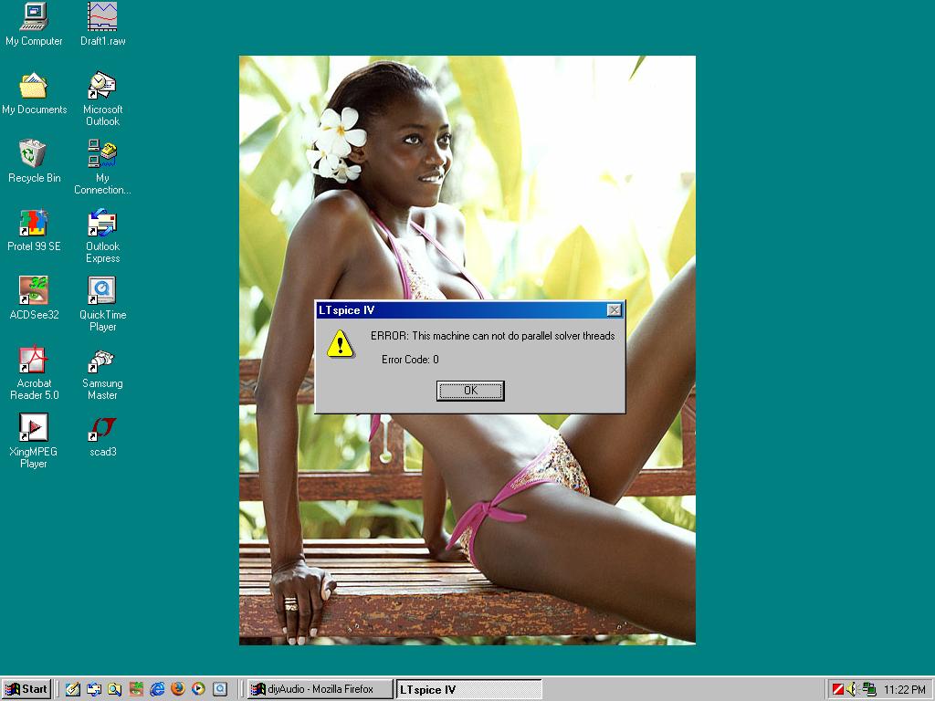

I recently upgraded from Win98 to Win98SE (very "up-to-date", I know) and now whenever I wish to run LTspice I get this.
So what is that and what impact is that going to have then?
Try right mouse button the icon of the program LTspice properties >> compatibility >> execute in compatibility mode.

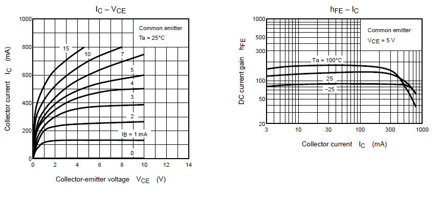

I have only just now found this discussion, and wanted to say, why try at such great currents? The effect of VCE affecting hFE would also be present with much lower currents, without fear of blowing things up or requiring 200W resistor arrays or overheating transistors which will definitely push hFE high and is not what we are trying to measure.
SPICE seems to think this is the case; even at very small currents of a few mA, hFE shoots up with VCE.
I have measured one transistor, MJE15030 I think, and it moved by 1%, not by 50% as SPICE reported.
This weekend I will try to measure more transistors, and see what the effects are. I have a bunch of unused power transistors (200W or thereabouts) and semi-power ones (50-100W) and smaller ones to play with.
not necessarily SPICE itself, but more likely a poor transistor model. very poor, because usually device models tend to be on the "rose colored glasses" side of things.
I have tried at least a dozen models, sources from various places, and they all suffer the ridiculous VCE/hFE change. Now someone posted a datasheet for Toshiba trannies that actually includes the graphs for hFE/VCE and in that graph the changes are ridiculous too, it makes the hFE/Ic graph look irrelevant in comparison.
On the Toshiba graph I attach look at the curve when Ib=15mA - a couple of volts change in Vce and hFE is all over the show. Is this right? My tests (on other transistors) show that it is not. SPICE models seem to want to follow the graph. So, what gives?
why would you think that behaviour of hFE vs Vce at low current and low temperature would be an good indicator for what happens at high currents and high temperatures.IThe effect of VCE affecting hFE would also be present with much lower currents, without fear of blowing things up or requiring 200W resistor arrays or overheating transistors which will definitely push hFE high and is not what we are trying to measure.
just go and look at the way the curves of hFE vs Ic cross over each other at high temps and high currents tells you the behaviour has changed from the pattern shown to hold for low temperatures/currents.
