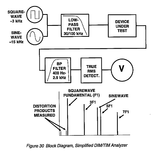

jcx said:Hi John,
I believe I could implement Bob's "PIM" measurement in LtSpice
See this to measure TIM
i've been experimenting with a program called "Spectrum Lab" available as freeware here:
http://freenet-homepage.de/dl4yhf/spectra1.html
it has a DSP function block that you can create custom signals and filters with, and it seems like it would be simple to implement an IM analyzer with it.

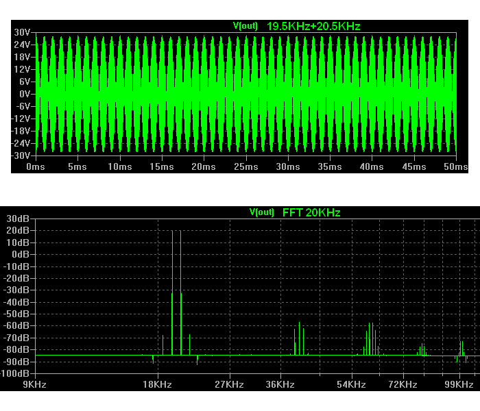

Hi
I wonder if someone did simulation of IMD in LTspice?
http://www.diyaudio.com/forums/showthread.php?postid=1349571#post1349571
I'm trying to do, but I do not know if is correct(Attached)!
that looks about right. you may want to set your minimum timestep to about 1us or so and make sure you have data compression turned off. also, look up some of the standard tone pairs used for IMD measurements, as there are some like SMPTE using 60hz+7khz in a 4:1 ratio and measuring the sidebands of the 7khz tone, or ITU-R which uses 19khz+20khz in a 1:1 ratio and measuring any 1khz component that turns up. if you have heard test signals such as the two-tone test used as a warning signal in the Emergency Alert System in the US, it's usually 900hz+1khz in a 1:1 ratio, and any 100hz (and sometimes the 1900hz) component is measured. such a two-tone IMD test is primarily used for radio equipment with a limited audio bandwidth (2khz to 5khz).
Yes I'm doing it, and disabling the compression with the command:unclejed613 said:that looks about right. you may want to set your minimum timestep to about 1us or so and make sure you have data compression turned off. also
.options plotwinsize=0
unclejed613 said:look up some of the standard tone pairs used for IMD measurements, as there are some like SMPTE using 60hz+7khz in a 4:1 ratio and measuring the sidebands of the 7khz tone, or ITU-R which uses 19khz+20khz in a 1:1 ratio and measuring any 1khz component that turns up. if you have heard test signals such as the two-tone test used as a warning signal in the Emergency Alert System in the US, it's usually 900hz+1khz in a 1:1 ratio, and any 100hz (and sometimes the 1900hz) component is measured. such a two-tone IMD test is primarily used for radio equipment with a limited audio bandwidth (2khz to 5khz). [/B]
I read that in LTspice that is only as possible to measure in frequencies next.
this website is IMD measurements (Graf-6)
http://www.littlefishbicycles.com/poweramp/
I want to know is how to analyze the graphic, would be the amplitude of residual?
-seems that there is any way to get the value of IMD in %
your fft plot looks like you need to improve the "noise" floor
use max time step < (analysis length)/(fft bins)
use a window - I like Blackman - you do need >4x fft length to reslove the frequency components (more than 4 periods of the lowest frequency component)
use integer number of periods of both frequencies in .tran length or a really long record and good window
if you have turn-on settling issues you may need to allow some sim time before collecting data for the fft (tstart)
its possible to do very complex "analysis" with behavioral sources performing math on the waveform:
http://www.diyaudio.com/forums/showthread.php?postid=1333137#post1333137
the basic pattern could be used as a basis for a 2-tone signal analysis
the sidebands in the residual after subtracting the test tones could be rms summed for a % output
I've mentioned earlier that the IMD could also be separated into "AM" and "FM" components
change the scaling in the graph to log scale rather than db. calculate the RMS sum of the distortion components and divide by the RMS sum of the test tones. then multiply the result by 100.
