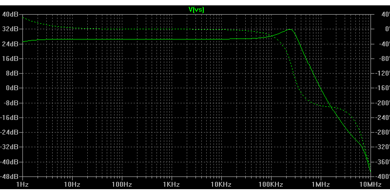

Oscillation...
Hi
I added more transistors output, is showing a peak in the dc closed-loop this indicates a local oscillation?
The original circuit has the resistors of 10 ohms, the base of the transistor output.
unclejed613 said:
yes, that peak shows instability. and i suspect your input signal was 0.5V or less? and that the gain was still greater than 1 when the phase line crossed the 180 degree mark.
I have noticed, that exceed the response in frequency (>800KHz in closed loop)even with good phase margin, always have this peak.
I have to limit the response placing a capacitor short circuit ratio
To simulate the correct, I would have to include a mathematical model thermal output stage?
http://peufeu.free.fr/audio/articles/Thermal modeling of power systems.pdf
just because you have instability, doesn't mean it will always show up as oscillation under normal operation of the amp into a resistive load, however 2 different operating conditions might cause oscillation, running the amp into a moderately capacitive (around .01 or ,02uf across the load resistor) load, or running the amp into clipping, with the worst case being clipping into a capacitive load. loads tend to get capacitive for two reasons, long speaker cables and crossover networks in the speakers. the first, you have some control over, the second you have less control over. as far as clipping goes, the only way to avoid it completely is by using a dynamic limiter that lowers the gain of the amp before it clips. this is a form of compression, and works well for average listening, but sounds artificial if you try to push the amp. the other way to keep the amp out of clipping would be to use "soft clipping" which clips the input signal before the amp outputs reach saturation. both of these methods are in use by various manufacturers. Peavey and Fender use the first method because some of their solid state amp designs tend to misbehave when they saturate. NAD used (maybe even continues to use) the second method, but it's a user settable option. NAD's amps are usually pretty stable so they dont require the use of soft clipping, but they include it because some listeners prefer the smooth tube-like clipping to transistor saturation clipping.
your simulation data shows another indication of instability that you never hear much about. the slope of the gain rolloff is -48db/decade. -20db/decade (IIRC) is normal for a stable amplifier. the steeper the slope, the more unstable the amp is.
This brute rolloff (48dB or even more), is due to peak in closed-loop, if I limit response in frequency in closed-loop, the curve rolloff improves
actually it's there for the same reason as the peak, the amp is under compensated, and adding an integrator cap in the feedback is just a bandage on a sucking chest wound. get to the root cause, increase the compensation cap, or increase the diff amp current or both. i don't know why the first response of most experimenters is to add an integration cap when the problem lies elsewhere. two root causes of instability exist, 1) compensation, the dominant pole cap is too small, or the diff amp )LTP) current is too low, or both, and 2) grossly mismatched input stage and output stage slew rates ( for a detailed discussion of this go here: http://www.linear.com/pc/downloadDocument.do?navId=H0,C1,C1154,C1009,C1028,P1219,D4138

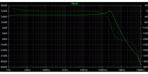

Attached is my simulations (Middlebrook and closed loop), the closed-loop the response in frequency to 1.2 Mhz -3dB, This brute rolloff , I think that this frequency is very high for an power-amplifier, I would have problem?
