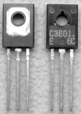

original?
Hi Alex,
After your description I'm quite confident that it's an original part.
Below one more picture taken with other light.
As you can see the three circles are not that shallow.
Also the line across the upper right corner circle is clearly visible.
Thanks a lot.
Edmond.

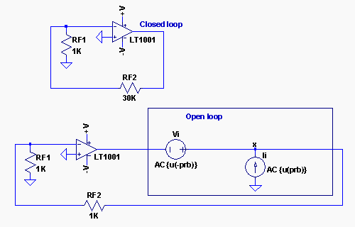

Open loop measure
Hi
I am using method Middlebrook to simulate ( LoopGain2.asc in LTspice).
By this method I have to set the in open loop, gain= 1(RF1=1K and RF2=1K), I am sure ?
Measure open loop is with load or without load?
Diagram:
