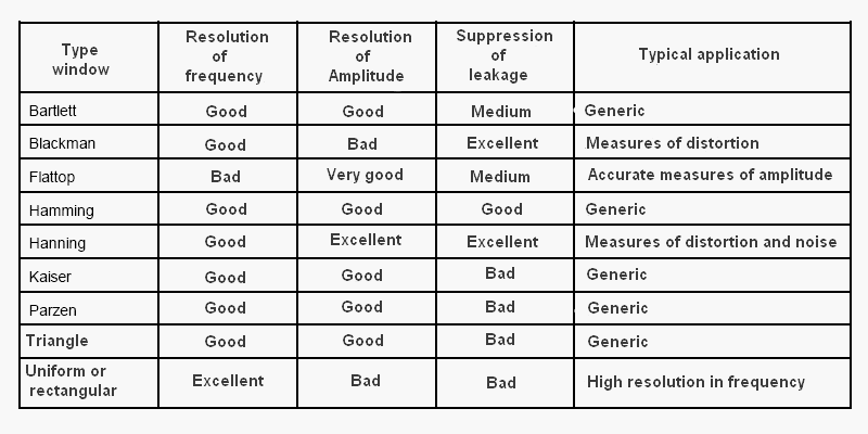

Window in which used fft ? I have an article in portuguese it has windows for measuring instruments in fft, I put only the table
Note:Leakage, behavior is not predictable where the signal is not zero(Ex: pink noise) this"leakage"just damaging the samples following.
Table:

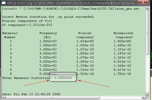

Oh, that sine_gen.zip is just something I threw together real quick to help OS troubleshoot a problem he was having with a high FFT residual a while back. It wasn't meant as some kind of model for how to do things in the most general way. I've attached a new one in which the frequency and number of FFT points are parameters, which makes it more general. The one OS posted works best only at 1 kHz.
The idea is to have the max time step be one period divided by (num_FFT_points - 1). I've also set it up to do an automatic THD calculation without having to do an FFT from the graphs. Run the sim and do a view, SPICE error log to see the zero percent distortion of the source in text form.
When doing an FFT from the graph, LTspice chooses 0 dB as 1 VRMS. Since 1 VRMS is sqrt(2) Volts peak, that's what I chose for the amplitude of the source. So when you do the FFT from the graph, the source will be normalized to 0 dB.
Edit: OS, I think you put the old sine_gen.zip on your site? I hadn't meant it for reference, just a quick fix. The one attached to this post is more general.

Hmm, I'm not sure what you mean by that. Could you explain a bit more? The number of harmonics defaults to 9 if not specified. You can specify the number of harmonics you want displayed and included in the calculation. See the docs of ".FOUR" for how to do this.
looking at the data , it seems as the distortion readout sums the fourier phases. could comments be added to give H2 , 3,5 and 7 , too ??
The Fourier phases don't play any part in the THD calculation. THD is calculated by taking the square root of the sum of the squares of the distortion component amplitudes, dividing that by the amplitude of the fundamental, and multiplying by 100 to get percent.
I might be misinterpreting your question though. I don't know of any way to change the distortion display in the error log other than specifying the number of harmonics that's included.

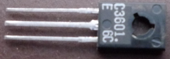

I have just compaired to one other sanyo devices I have here, if its not original its the best copy Ive every seen, the front marking style is identical to mine, and has the line accross the right hand corner circle, something a contact at sanyo told me to look out for.
The circles look a bit bigger and more shallow but this could be because of the pic. Ill take a pic of mine with webcam, see how this comes out but Ill have to reboot to install cam drivers.
Pity Im looking for some too, Im waiting for a contact which is trying to locate some in Asia. I can still find the odd loose ones here but matching is problem, would have to match gain groups to get even close. Dalbani in uk also sells authentic but they expensive.
Sorry Edmond the cam is useless for this, cant focus close up but Ill say with 99,999 percent surity thats the real deal. Even the face where the markings are is slightly lighter in colour, that widening at the top of just the middle pin is identical and the lettering is identical in style too. All my sanyos look like this and most came direct from factory through a agent to me.
