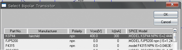

By aska - I've found that if Ic and Vceo come up on these models as zero, then the model is bad
Not always true , hugh... The ( ) header is what gives LT
the data to place device info in the listing. All the generic
ones that come with LT have it , but some (almost all)
of the 3rd party .models omit it.
The fairchild models have extra data and show more
realistic conditions within a design..
As a test I designed a new amp with MPSA 94/44's
using the old models .I had a easy time getting it to be
stable, but when I switched to the new fairchild KSP94/44
(2007 models) ,my triple OPS oscillated and saturated.
(in a quite realistic way 😀)
Thank you andy for new 4793/1837's ,old japanese models
I have are much less verbose (data wise).
OS

That's very informative, much appreciated.
If you want to correct this small inconvenience ,here is an example...
.MODEL KSP44 NPN
+ IS=2.4446E-13 BF=184.79 VAF=100 IKF=9.6380E-2
+ ISE=2.8775E-12 BR=0.17129 VAR=100 IKR=2.2351
+ ISC=6.0845E-10 NC=1.5000 RE=0.1 RB=4.7095
+ RC=2.7922 CJE=1.0100E-10 CJC=1.9010E-11 VJC=0.66207
+ MJC=0.40238 TF=1.1000E-8 XTF=10 VTF=10
+ ITF=1 TR=3.86493E-5 FC=0.5 XTI=3
+ EG=1.11
+ Vceo=400 Icrating=.3 mfg=fairchild
The last 3 entries is the data the LT device listing reflects
(+ Vceo=400 ,Icrating=.3 , mfg=fairchild)
It works good ..as reflected here: (attached)

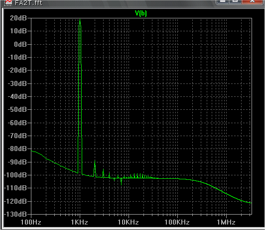

Hello
I would like to know, as you are to measure FFT in LTspice-IV, is there any setting to set simulation?
I put a source in 1KHz and only one resistor, and the result 3,1% distortion 😕
I could get the graphics of the harmonic only EX: 2nd in 20-20 KHz?
Thank's
Good advice.. turn off all compression..🙂
I was just doing some FFT's and noticed this thread..
Andy C. has a good way to do it.
Add this as a general LT comment:
.param timestep 1m/65535
.tran 0 10m 0 {timestep}
.options plotwinsize=0
.four 1k
Notice the {timestep}....
add this to the AMPLITUDE of your signal source;
{sqrt(2)}
The "2" will drive the amp to about 30 db , near full power
depending on the amp. (A '1" in the equation will give the 20db
below)
simulated by itself the signal source has noise level of -200db
, Much better than a "strait up" generator.
here is what you might see (-110db .0001%)😀
os
