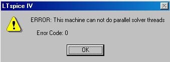

I just let my ~400 day old version of LT spice run a "sync release" update (about 5 Meg).
After all that the program doesn't appear to be any different, with the exception of the error message attached, which appears each time the program is run.
Anyone have any idea what this means?
