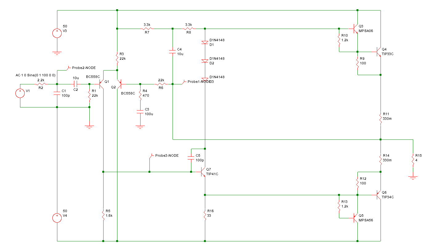

The placement of the 33R resistor, R13, and Q5's base are wrong.

Wow, that's very cool Jon. It works! The big difference I see is the value of the Rbe in the darlington pair. Although it looked fishy, I plugged it in as shown in the Multicomp datasheet, http://www.farnell.com/datasheets/296716.pdf. Now I see that STMicro has a different opinion, one that aligns with yours, http://www.st.com/stonline/books/pdf/docs/4132.pdf.
Other than moving that pesky capacitor, did you do anything else?

Oh, I see... you also changed the driver to be a common emitter as opposed to an emitter follower. That's probably the big change.
Yeah, this corrected circuit works in all three simulators I was trying. Silly me. I built this amp and it worked perfectly. I just couldn't see my drawing error. Thank goodness I'm a little better with the soldering pencil. I am really grateful for your help.

The main problem with your simulations was the VAS connection.
Also the power transistors you'd chosen aren't a complimentary pair which resulted in asymmetry in the output so I just left them as generic npn and pnp. Some of the capacitors values appeared with some extended character set characters instead of u in the uf so I corrected these and changed the input filter to a non-polar 100pF. I connected input and output test points and change the simulation parameter to do a 1 second transient run instead of a frequency sweep. That's pretty much the extent of my changes.
I didn't change the topology of the output stage but I would recommend you use some different transistors for the VAS and the output stage and then run the simulation again. There is some crossover distortion at the moment because the biasing of those 3 diodes isn't correct.

Right, I knew the transistors weren't right. The standard libraries have so little. I joined the Yahoo group & learned how to add the SUBCKT darlngtn.lib library so now I can use the TIP142/147 pair. Also updated the standard.bjt & standard.dio.

As for topology, I'm not working on the amp, I'm working on short circuit protection schemes. So I wanted a simple amp to start with.

your problem here seems to be that the base of Q6 should connect to the collector of Q7, not the emitter. (that's the most obvious one, the implementation of the darlingtons is another one)
Thanks Jed, Jon got me pointed in the right direction.

still, having the base of your negative side output effectively tied to the negative rail through a 33 ohm resistor is going to make the sim not work... it should be on the collector of the VAS, which is where the voltage swing is developed
