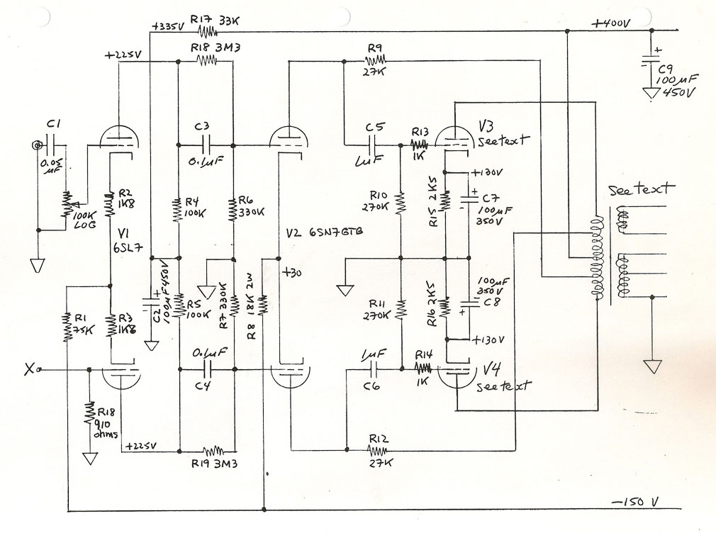

6DK6 PP in Triode First Pass
Altho I have data sheets from JJ, Amperex & Svetlana none shew the value of triode mu. But from previous experience & some other clues taken from the information available it appears the mu is 2.5>3.0>3.5. I've set mu at 3 for the simulation. Other than max plate dissipation the results are much like what is possible with the 6080/6AS7G family.
For the conditions shewn about 28 Watts is available at clipping. I've used a 6BL7 instead of a 6SN7. The 6BL7 is like a 6SN7 on steroids.🙂
Fixed bias on low mu triodes makes me nervous, thermal runaway is always a possibility.😱
More later.

A Comparison
Over time I'd seen many attempts to drive low mu triodes such as the 6AS7A/6080 series. None appeared adequate in one way or another. Some were simply brute force. The most difficult part to design in these amplifiers was the driver. There had to be a better way.
McIntosh, Electrovoice & the Circlotron all used boot strapping for the driver stage, why had no one tried that on the 6080 series. So I wired a rough version using the UL taps on the OPT to provide the boot strapping. On the bench, the results were very good.
For the final version the OPT is a Hammond special H300429 set for a plate to plate impedance of 2150 Ohms. The UL taps are at 40 %.
The resulting amplifier has a Damping Factor of 3 with no NFB. With 13 db the DF is 15. This amplifier was published in Glass Audio Magazine, May 1999. Depending on the power supply, 25-30 watts is available at clipping.
The Final Amplifier claims a DF of 40. I think that to be very unlikely. UL usually gets a DF of approximately one for internal impedance of 8 Ohms on the 8 Ohm tap. NFB of 10 db would reduce the internal resistance by a factor of 3.16, so the internal resistance would be 2.53 Ohms. That would be a DF of 3.16. Perhaps the original measurement yielded a DF of 4 for the Final Amplifier.
My thoughts, anyway.

Thanks for sharing your simulation results. Is this what you expected? And thanks for your simulation input file. The latter I would find it very useful once I become Spice-capable.
Meanwhile, where do you think most higher power distortion originates, is it the UL EL509 power, phase splitter/inverter or 12AT7 voltage amp sections? What did you use in your simulation for the inverter tube?
The Final Amplifier claims a DF of 40. I think that to be very unlikely. <snip> Perhaps the original measurement yielded a DF of 4 for the Final Amplifier.
Thanks for reminding me of your published design of this bootstrapped 6AS7 amplifier in Glass Audio. I remember seeing it back when. I will have to dig my old copies out. What distortion did you measure just before clipping at 25-30 watts? I assume this was achieved with the two triode sections of each 6AS7 tube in parallel.
Do you think bootstrapping would be a good approach to improve the performance of the “Final Amp” EL509 amp? I guess the Final Amp design is not so final yet 😀 It would be nice if Mr. Kjeld Pedersen would join the discussion. Perhaps he could clarify the DF also.
Thank you Mr Stewart, may I ask you why?The Final Amplifier claims a DF of 40. I think that to be very unlikely.

Please read #64 carefully. If you differ tell us why & give a technical account of your thoughts.🙂Thank you Mr Stewart, may I ask you why?
The products listed on that web site are very impressive. Throw enough money at a project & anything is possible. For the amps shewn the 6336 family is a very good starting point. Six of those in PP I think 100 Watts is not a problem at all.
The DF of 70 would be difficult even with triodes. But no circuit information is given. I'll have a look at that with some simulations sometime in the next few days. Winter is coming here, there are other things to do.
