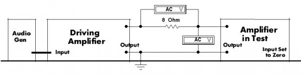

Quote- Very low Z-out. Damping factor about 40 and current to keep it there
How was the output impedance of the amplifier measured?
but without the UL tap %, that would be difficult to replicate your work unfortunately. I understand you may not recall.
40%

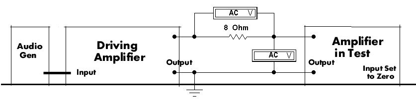

Determination of Damping Factor...........The Easy Way
All we need is a reliable AC VM & a load resistor. And another power amp. Referring to the attachment, one amplifier is used to drive the output of the amplifier in test. The amplifier in test is not driven, the gain control set to zero. The driving amp can be any amp of reasonable spec, very little power is required. Cranking up the signal generator, if 8V appears across the 8R resistor there is One Amp passing thru the secondary of the OPT of the amp in test. Then measure the volts developed across the amp in test secondary terminals. As an example, if that measures one volt the resistance at the amp in test terminals is One Ohm. If the measurements were made on the 8R tap the Damping Factor is 8/1 or simply 8. If a second amp is not available on the shelf, call your buddy!🙂 And don’t be surprised at the results, might not be as good as you had supposed. SET amps without NFB manage DF of 3 if not biased off too far. SEUL amps without NFB might make DF of one. NFB will push the DF up.
A damping factor of 40 on a 8 ohm load implies an output impedance of 0.2 ohm...
Now that's easy... for a SS amp... But a tube amp... I'm a bit skeptical.
For this test, I used the PPUL 33 amplifier, something I’d built about 20 years ago. Maximum power output for a triode occurs when the load resistance is two times the plate resistance. But the distortion is high, good practice tells us to increase the load resistance to about three times the plate resistance. If the OPT was perfect, DF would be 3. The transformer winding resistances are part of the final result. The measured amp signal at the input is set to zero. The driving amp feeds into the measured amps OPT secondary. The resulting voltage & current are used to calc internal resistance on the 16R tap. For this OPT the primary resistance is 290R, the secondary about 0.5R. A MetraHit 29S Precision DVM & Wattmeter was used. The 33 amplifier is setup to run into Class AB2, so that the output tubes are running at a rather higher plate resistance. The results show that to be the case. 33 PPUL Amplifier Internal Resistance Tests PPUL 33 Amp Test Results. Formatting failed on the last post.😀 Not sure how to clean up what that left.
