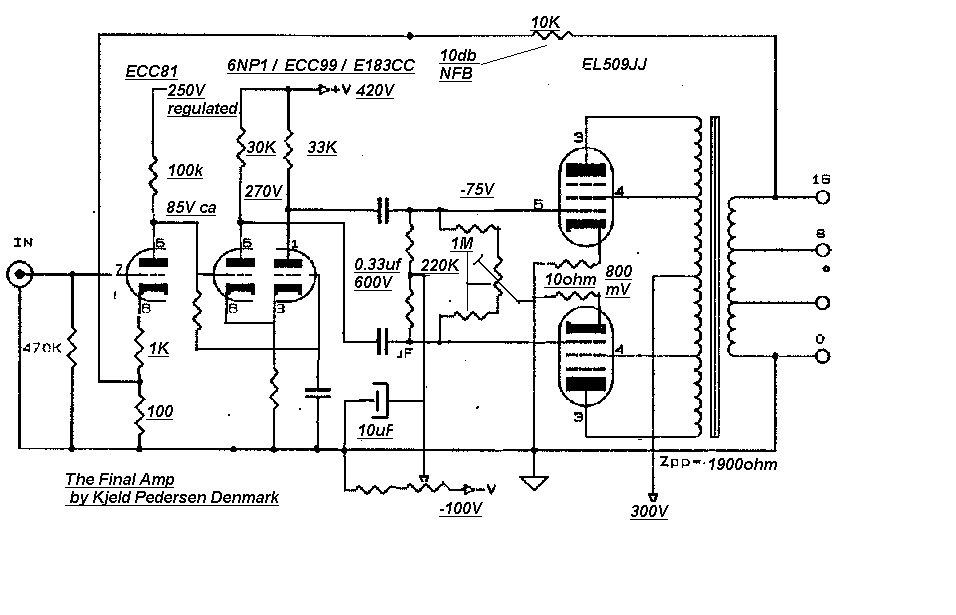

Thanks Koonw,
I'm using your PL519 model in the attached schematic.
This is the FFT at 100 Wrms:

Thanks Koonw,
Zintolo,
Thanks for sharing your simulation results. Is this what you expected? And thanks for your simulation input file. The latter I would find it very useful once I become Spice-capable.
Meanwhile, where do you think most higher power distortion originates, is it the UL EL509 power, phase splitter/inverter or 12AT7 voltage amp sections? What did you use in your simulation for the inverter tube?
The resulting amplifier has a Damping Factor of 3 with no NFB. With 13 db the DF is 15. This amplifier was published in Glass Audio Magazine, May 1999. Depending on the power supply, 25-30 watts is available at clipping.
The Final Amplifier claims a DF of 40. I think that to be very unlikely. <snip> Perhaps the original measurement yielded a DF of 4 for the Final Amplifier.
Thanks for reminding me of your published design of this bootstrapped 6AS7 amplifier in Glass Audio. I remember seeing it back when. I will have to dig my old copies out. What distortion did you measure just before clipping at 25-30 watts? I assume this was achieved with the two triode sections of each 6AS7 tube in parallel.
Do you think bootstrapping would be a good approach to improve the performance of the “Final Amp” EL509 amp? I guess the Final Amp design is not so final yet 😀 It would be nice if Mr. Kjeld Pedersen would join the discussion. Perhaps he could clarify the DF also.

Roberto,
Still pondering your simulation work and how to interpret the results. What does the widely varying phase degree (last column) mean?
I noticed that the original poster Tube Mania (in post #1) measured .5% distortion at actual 26Vrms output (~85 watts into 8 ohm I assume). Your simulation shows 2.5 time that distortion at 80 watts. Any thoughts on the cause of the difference?
If I understand it correctly, your simulated schematic shows Vbias as -90V and ~65 ma bias current, while Tube Mania has -75V bias on the output tubes, with 80 ma current. Could this be it? I’m not sure how the UL output is simulated though.
Kind regards,
Francois
I saw it in many simulations. Pass talks about the importance of the phase of the second harmonic (most people prefer it negative in blind tests), but not so much about others.
LTSpice models, working points, approximations (it could have been optimized in real life to cancel harmonics)
at -75V the bias was too hot in the simulation, that's why I lowered its value. I will do some more tests for sure!
