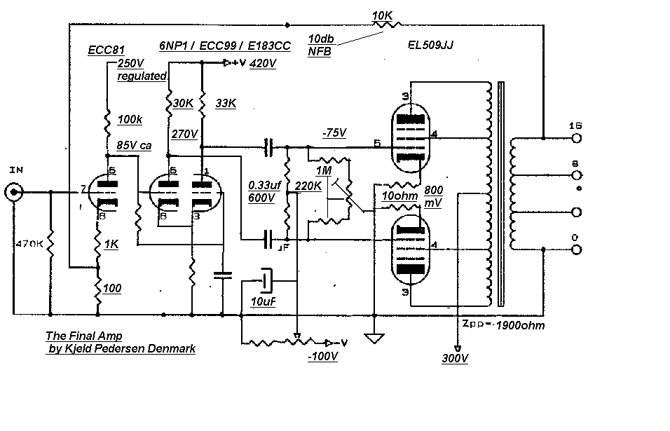

Tube mania i believe has given enough information to go by...
Tony, could you then kindly fill in the gaps around the second 6NPi tube in the listed schematic? Providing the specified voltages is not a problem, values of resistors and caps are. Btw, I realize “6NPi” is a typo in the original schematic.

Could we use this thread to work together on a great UL amplifier using those tubes. The problem of course, is the relatively low voltage these tubes can tolerate in a UL design, due to screen voltage fragility. This to me, was the contribution by Tube Mania’s “Final Amp”.
yes, since plate voltages are given, the for the LTP, plate current is 420-270 or 150 volt, now 150/30k is 5ma, so then tail current is 10ma,..since the plate voltage of the input voltage amp is 85 volts, i assume that the cathode voltage of the ltp is at 90 volts, so then the resistor needs to be 90v/10ma or 9k, 9.1 is the nearest standard value and it needs to be rated for 3 watts, the resistor is dissipating about 980mW...
the other resistor can be 1 meg, and the cap at least 0.47 ufd /250vdc at least...polypropylene film caps are getting smaller now...
i think the excitement here would be in the power supply, mosfet regulation for the first voltage amp and another mosfet regulation in the LTP, maybe i going to use a series shunt reg here ala Salas...….
i have a design running in my head as i type this....i will put it into paper...
he says he disliked seriesed psu caps, i can not say i disagree....
but just like in life there are things that you have to do given very limited choices...
sorry FrancoisG, i am not a fan of ultralinear amp, either you go triode or go pentode, there is no middle ground for me...
300vdc finals b+ and 420v b+ for the phase splitter LTP is what i really like, it goes away from traditional designs of the past....i am sure PRR will be happy with it...

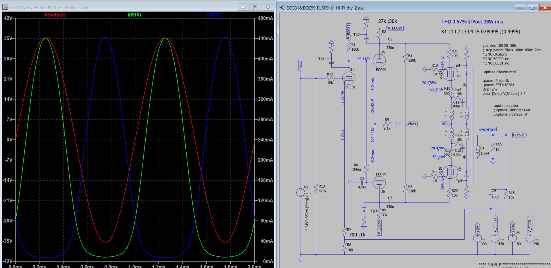

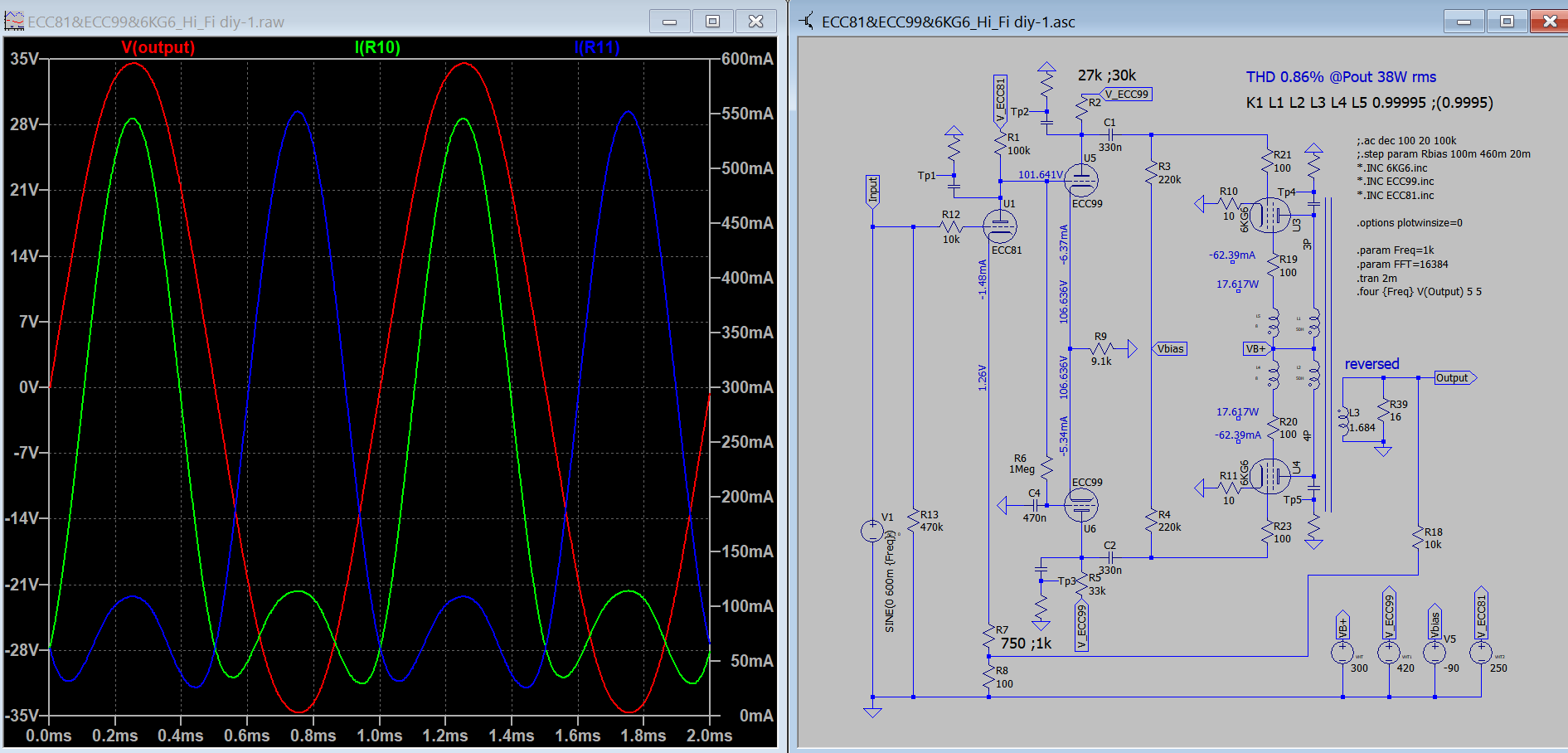

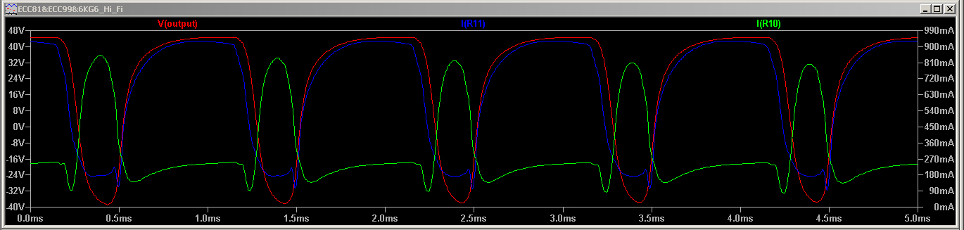

Hi, I've used the following LTSpice models:
...but results are not good on simulations.

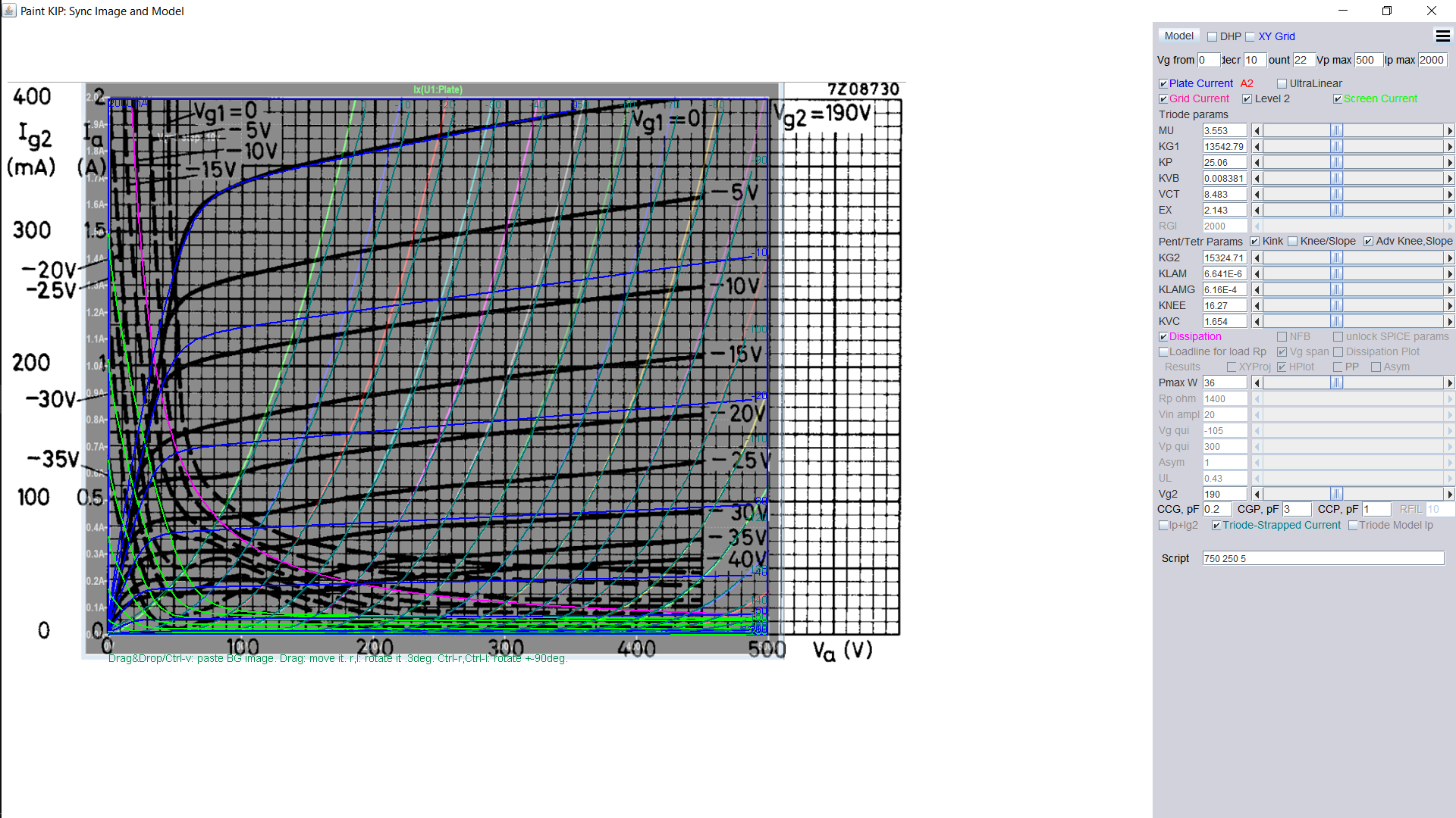

Koonw here ( Vacuum Tube SPICE Models ) posted some solutions to improve the design based on the available LTSPICE models:
I will update the asc file this evening and upload it.
I got a slight different result using PL519 model, the hump in the cathode currents are now gone, Thd down a bit from 0.8% to 0.5%. Please try this model I have revised since Jan 2019.

*** PL519_P ******************************************
* Created on 10/07/2020 21:23 using paint_kip.jar
* [url=http://www.dmitrynizh.com/tubeparams_image.htm]Model Paint Tools: Trace Tube Parameters over Plate Curves, Interactively[/url]

Thanks again Koonw,
with your model I can go up to 70 Wrms with around 0,24% THD and no oscillations occur.
I tried to lower the idle current, but if I go below -75V for power tubes' grids, no more data is shown. Do you know why?
