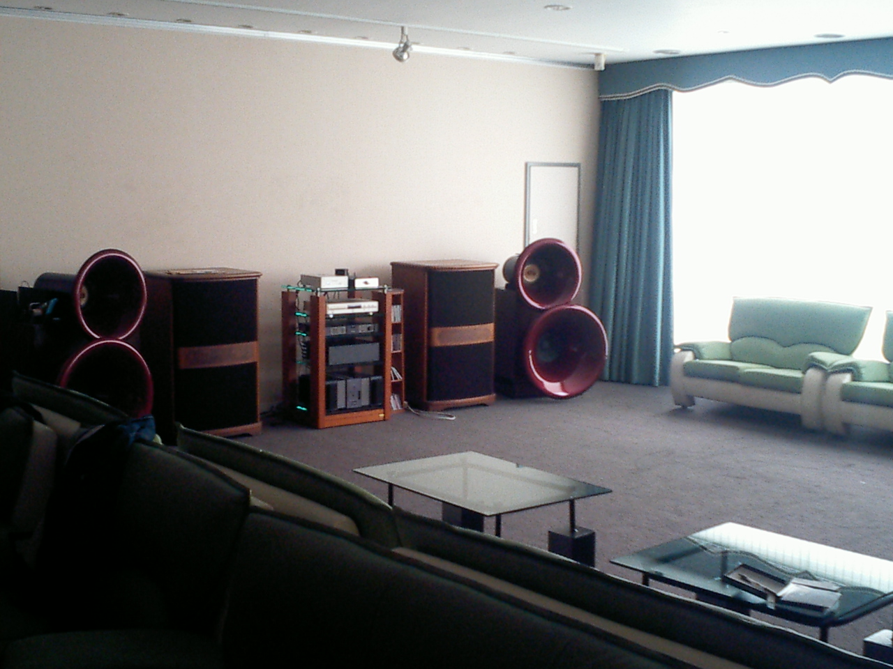

I just remembered that these Oris horns with 15" woofers will be beautiful with any Pass amp especially SIT. Only woofers are actively driven by the high-level crossover from the speaker line. 2 watt was enough to make a dancing club.
My problem is that I do not have them and space anymore.🙁

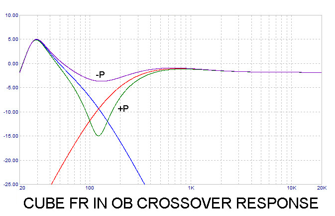

Can u inform us about 2 way open baffle design and cube audio drivers performance over lowther pm6a
We are talking about the Cube Magus 8" in Slot loaded open baffles,
as described in the SLOB article posted at FIRST WATT
If you have a B5 crossover, set it to 80 Hz / 12 dB low pass, 160 Hz
12 dB high pass, and a shelf at –2dB above 2.5 KHz.
You can also build this with the analog (Linkwitz style) crossover
available in the store.
Attached is a circuit schematic with the values, and a graphic showing
the response curves and their +/- phase sums. Also you can see the
response to 20K and a bass response view.
You will have to double check the polarity, as I didn't make note of it -
One way it has a big dip around 100 Hz, the other way not.

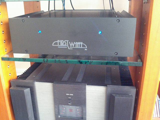

I think any mid or high efficient speaker of high quality can be used with the pass amps or the First Watt amps.
I heared Pass Labs Xs 300's (their topmodel) drive Tannoy Westminster's and that sounded wonderfull. Idem with First Watt F1's driving Altec Lansing 604E's in a 620 cabinet. My ex had B&W 800D's driven with Pass Labs X250.5's wich were also a great setup. And i recently heared an Alpeh J driving a Lowter OB (with an Alpha 12A woofer with a seperate (Ncore) amp wich was also good.
In general all Pass amps are easy to couple with speakers as they are build to be flexible. So get the speakers you think sounds the best, and try it. The chance is very big that you will love this setup if you like Pass amps.
I'm more a tube amp guy, but if it ain't a tube amps, give me a First Watt or Pass Labs amp, and i'm almost as happy as with tubes...

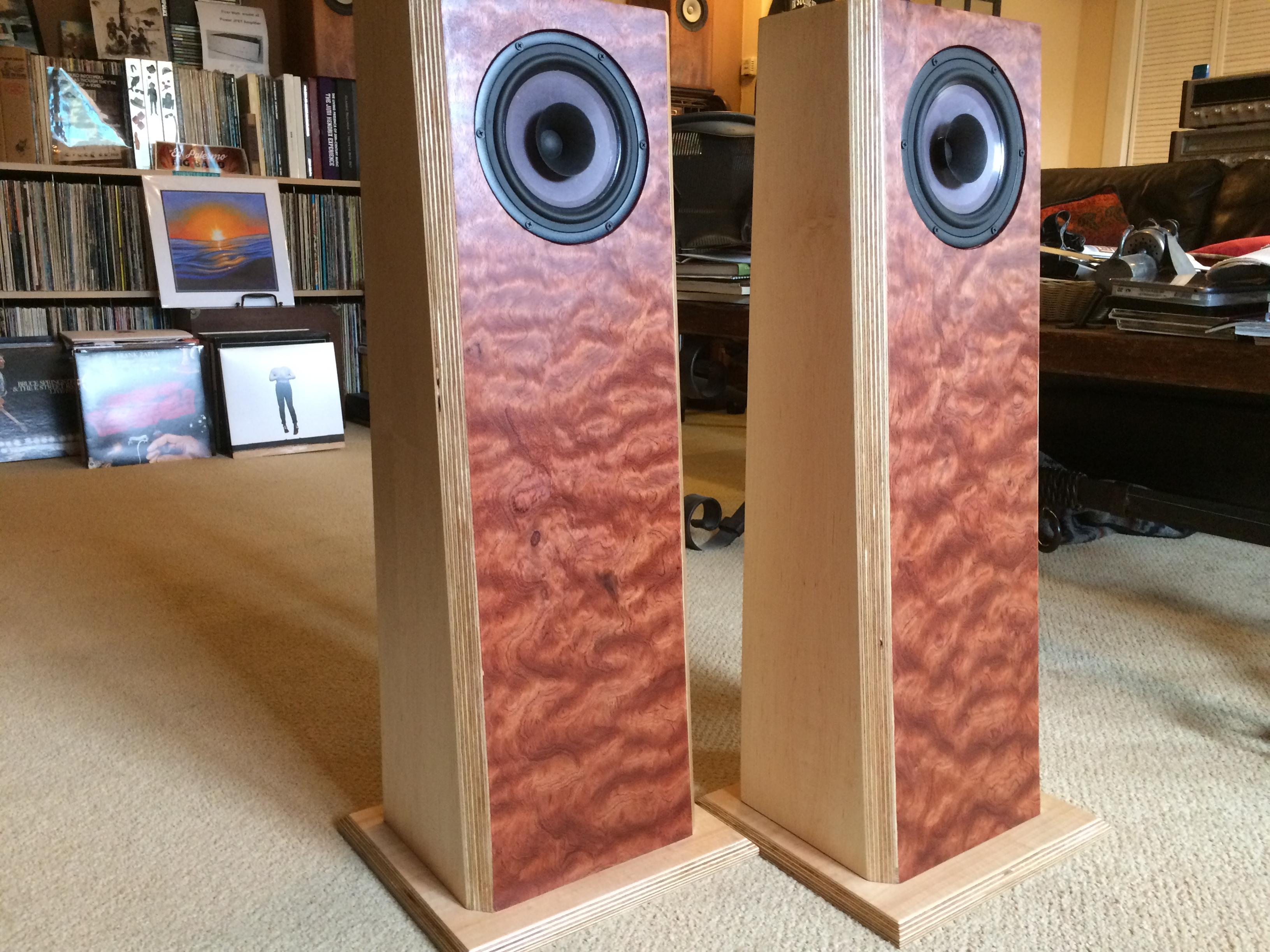

I think you had a lot of full range drivers. Which one is the best in overall performance apart from the their price?
At $200 each, the 6.5 inch SEAS H1794-08 FEA18RCZ are hard to beat. I heard them in toobhead's beautiful compact floorstanders powered either by the F7 or DEF amp. They had the line level EQ that smoothed out the peaks and if I remember correctly, improved the low bass response. I have to say that they are one of the most impressive FR speakers I've heard.
I also heard the Cubes which were beautiful, but 4 time the price. The SEAS performance was so close they get my vote!
