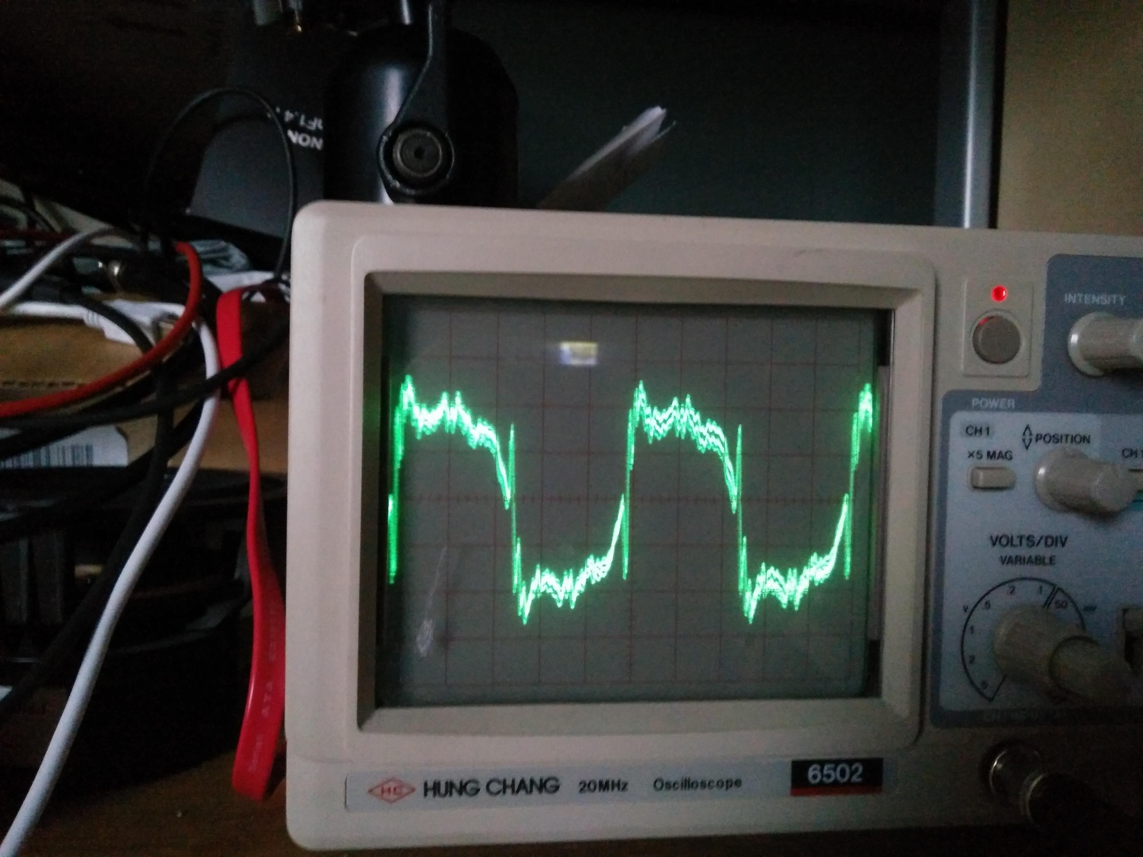

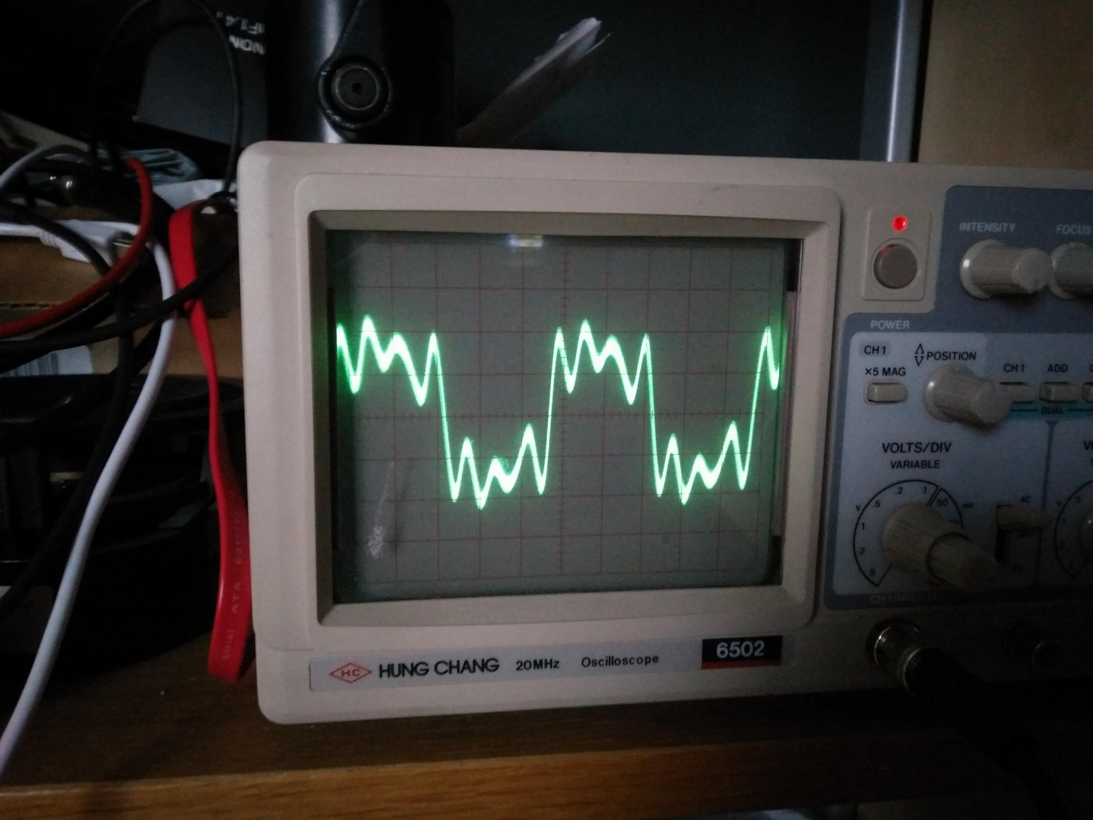

^ Hmm... Square wave testing in the last linked file... Why haven't I ever done that?
I couldn't come up with an excuse as to why I hadn't done such testing, so here are a couple of scope pics. I did this as just a quickie experiment. Test setup was a Siglent SDG830 arb generator running into my desktop system amplifiers input, from there to my desktop speakers, measured with an ISEM microphone and amp, whose output was fed to my PoC old analog scope.
Device under test here is not the 15" B&C mentioned here but rather an 8" coaxial from 18Sound, the 8CX401F, with crossover by humble ol' me.
Scope shots are at 400Hz and 2kHz. In the 400Hz shot the low frequency noise from my room can be seen. I was actually quite surprised how close to a square wave they seem. The 400Hz sweep exhibits "drooping" of the wave's tops and bottoms, which is a result of the loudspeakers low frequency response not being infinite. The ringing seen in the 2kHz sweep is what should be expected with finite top end extension.
