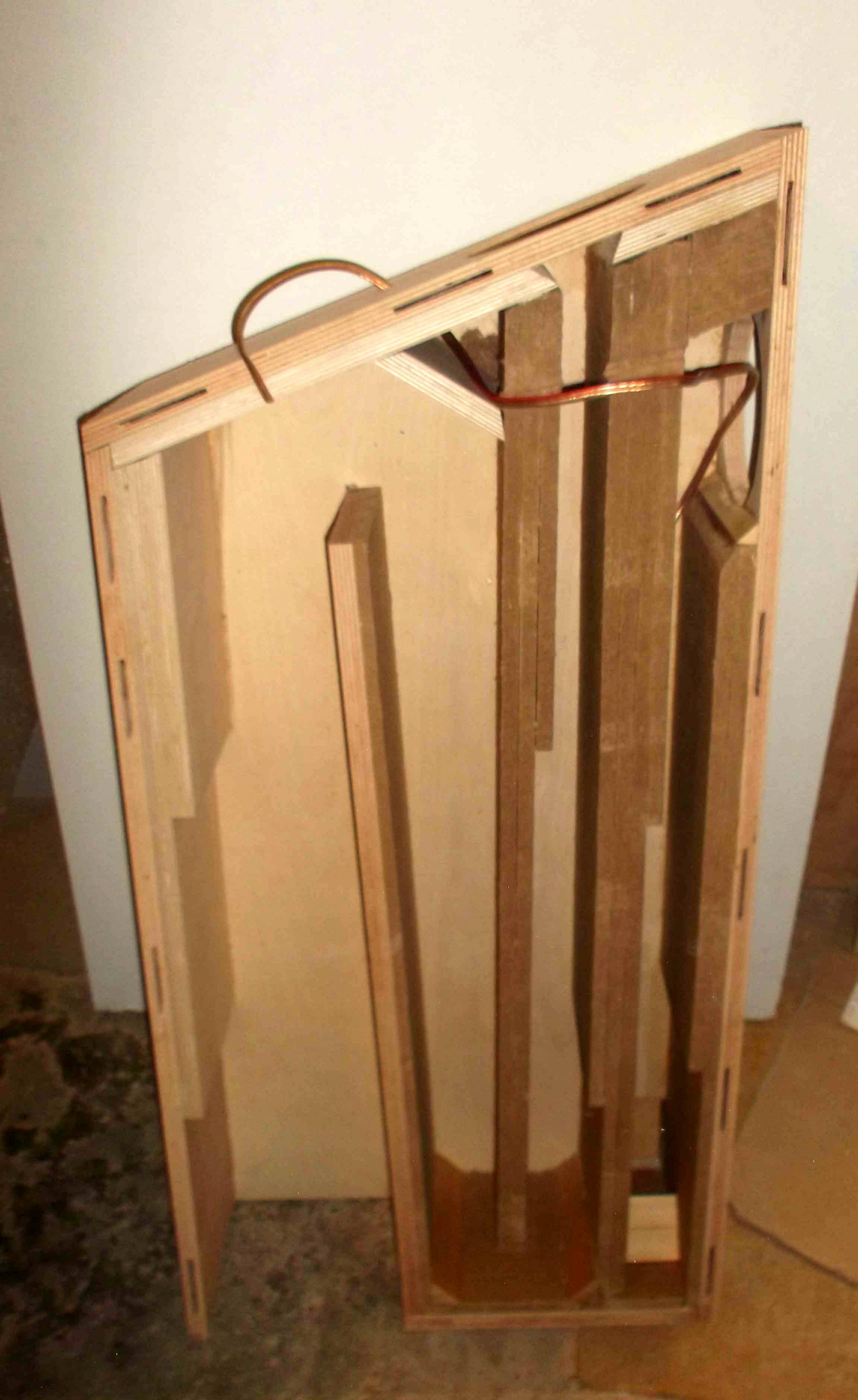

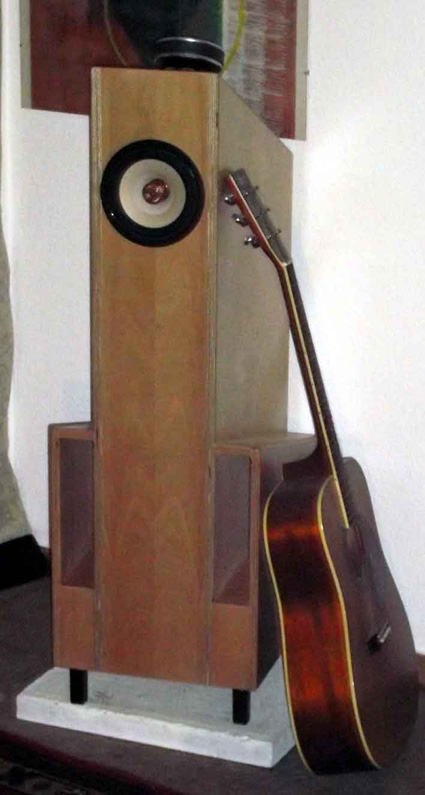

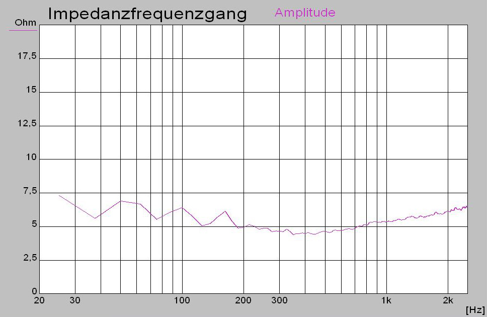

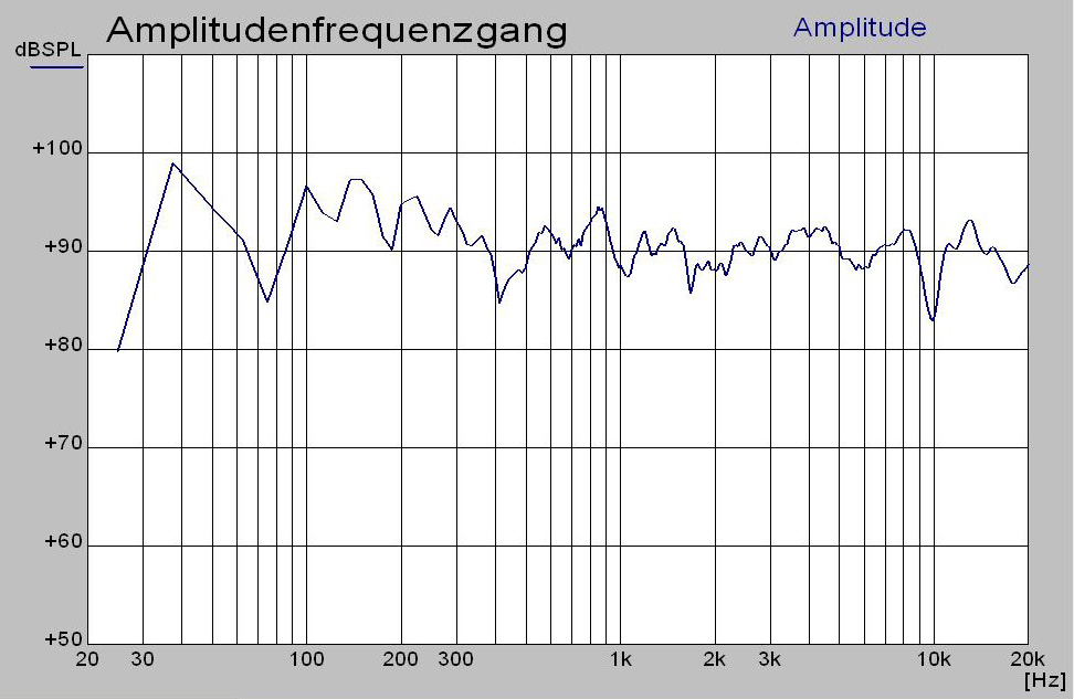

Hello,
one of my last project were the KANGLING,
double horn, two 6"5 driver, best ever seen Impedanzplot
superb for Tube amps,
compair it to all other solutions,
and for classic take a look of the Rms of the driver, find one below 1,
B200 has 0,4, W8-1772 ~1,6!
i sold the prototyp to a classic listener, he is lucky as can be.
take view
