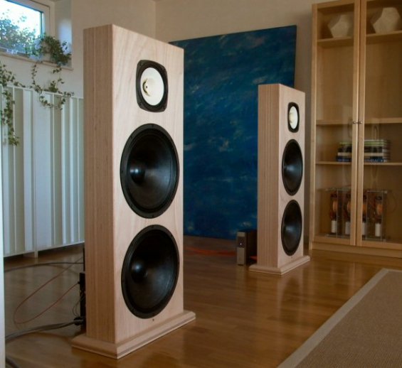

I think the FAST option is a good one. But...don't know what to chose in terms of Fullrange drivers and woofers.
Or SS 10F/8424 and RS225-8

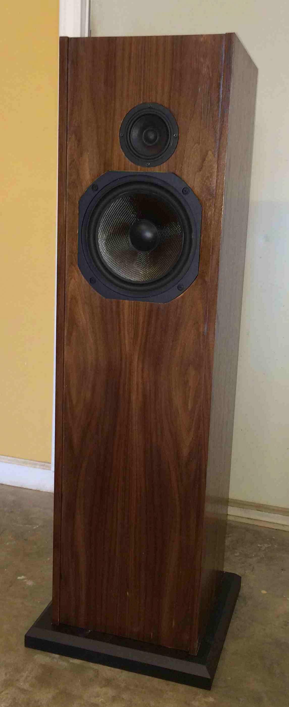

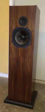

I admit that the RS225 in a sealed box with Linkwitz transform to achieve deeper bass runs out of steam. It does so by then you get great transients and low group delay. One can make this a dual 8in woofer and that will help a lot with 6dB more sensitivity for same drive voltage. Changing to a dual driver tapered TL alignment will also work well and still achieve pretty low group delay. Here is a speaker I made with only a 5.25in woofer in a tapered TL and it digs deep and double bass sounds great - it's for near field though. So same technique with RS225 can yield substantially deeper more relaxed bass.
http://www.diyaudio.com/forums/multi-way/281778-low-cost-pmc-inspired-tl-monitor-dc130a-dc28f.html

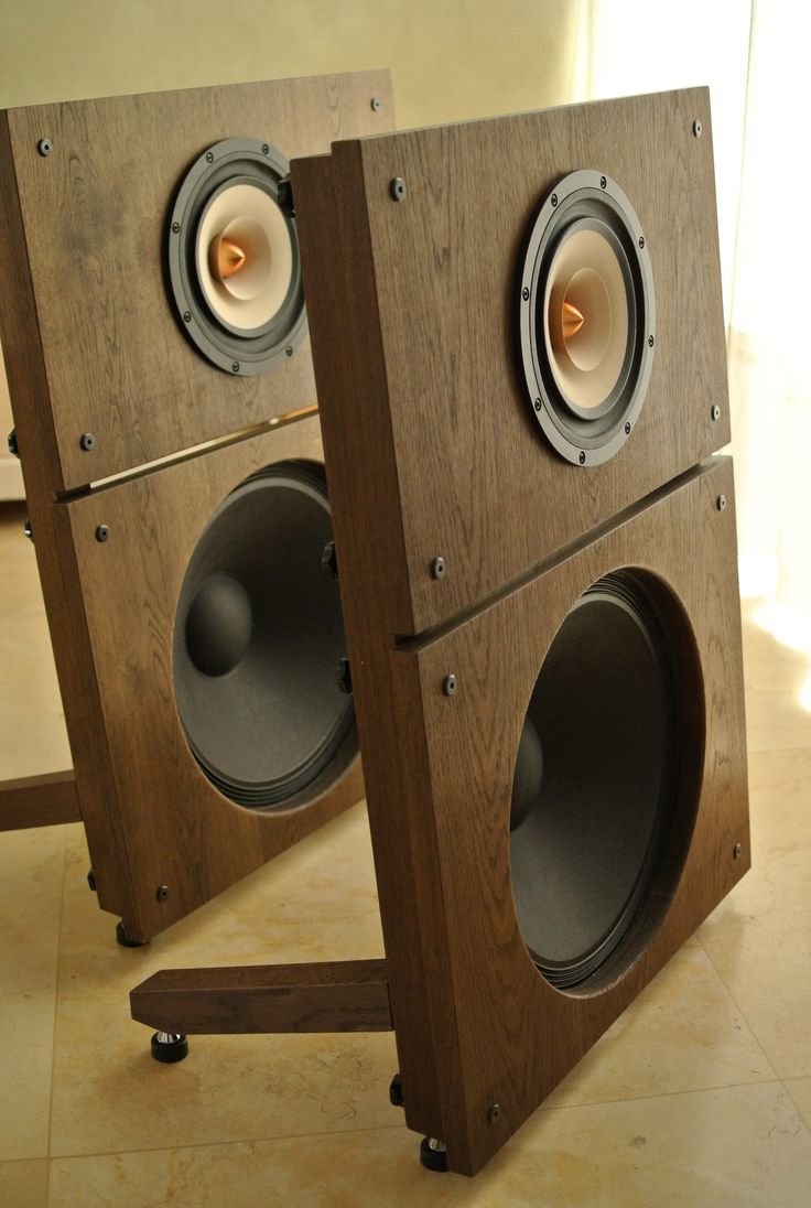

You can use most any full range driver as the top end of an open baffle fast but the question is not if open baffle fast is the way, but is it the way for you? There's not much middle ground when it comes to these speakers. Some love them and some hate them. What's nice is that it's so easy to try and you can always use the h-frames to support whatever speaker you settle on. Conventional wisdom says your room is a little small but there are those who ignore this advice and are quite happy with the results.
Here's another. I think this one is about as small as you can do for an open baffle with full range sound from treble to bass (aside from slotted designs, but that's another story for another day). Select your main driver (I prefer full range drivers) and add an Eminence Alpha 15 along with a powered subwoofer amp.
