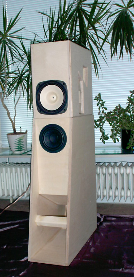

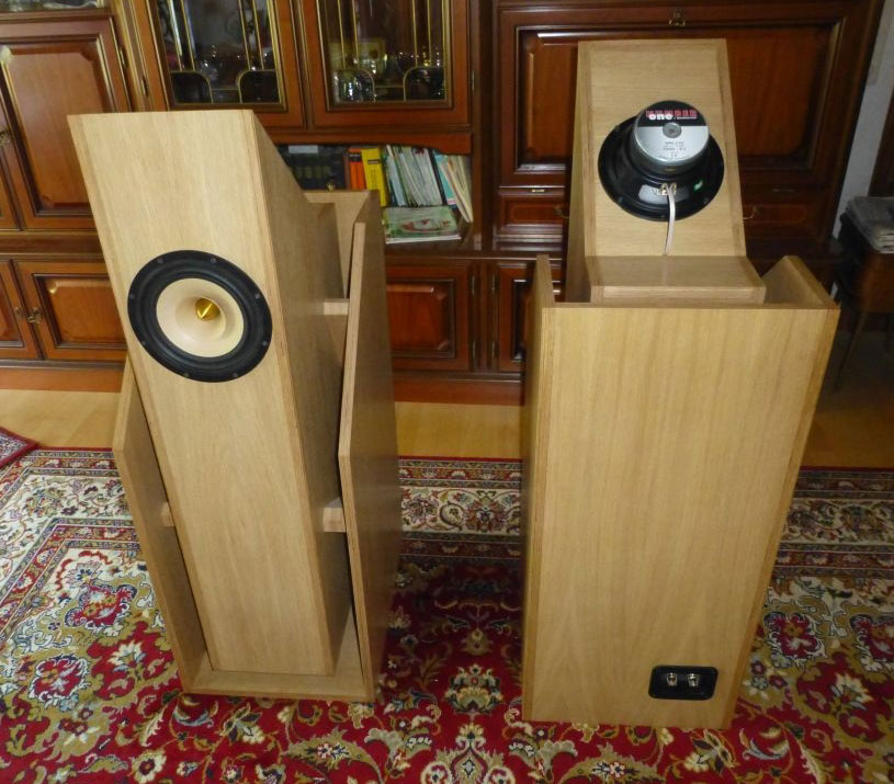

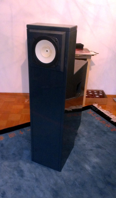

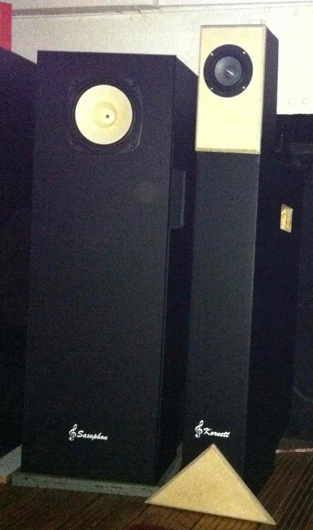

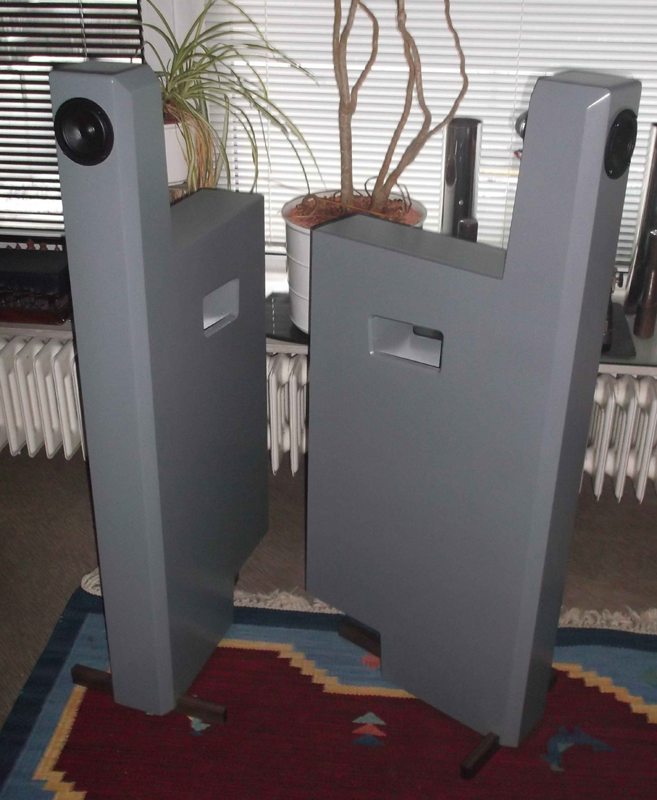

Hello,
look a few of my double horns,
best Impedanz , NO bass resonanz.
for classic i would prefer the B200 Visaton.

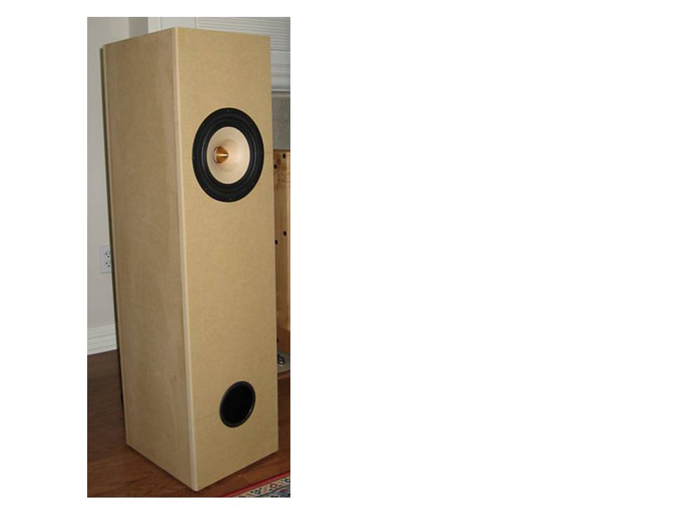

Here's another design using a similar driver to the Fostex you already own. Simply seal it up and place on top of a powered subwoofer.
