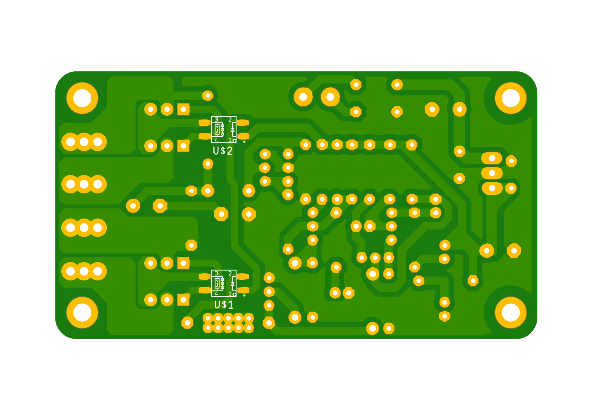

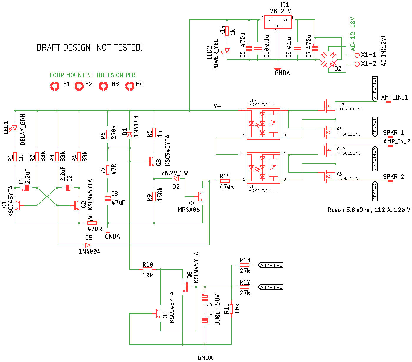

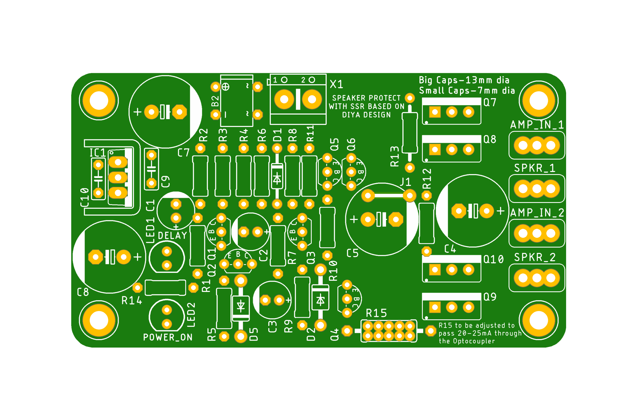

Hello,
just wondering if the speaker protect board is redesigned with a SS relay, it would find more universal application for any amp.
here is a schema I came up with, which is not tested, but anyone is free to experiment.
if mods find it not appropriate, pl delete the post.

Reactions: thimios and Mooly

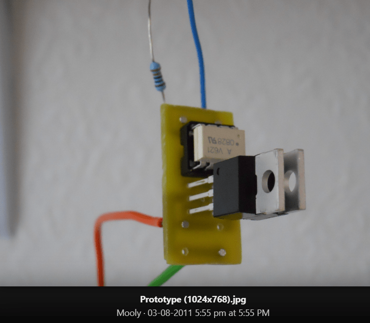

Using solid state relays is great idea šŸ™‚ and one I'm all for. You can make small SSR replacements in the same footprint as the originals, something I did with my amp a long time ago. It is definitely the way to go I think.

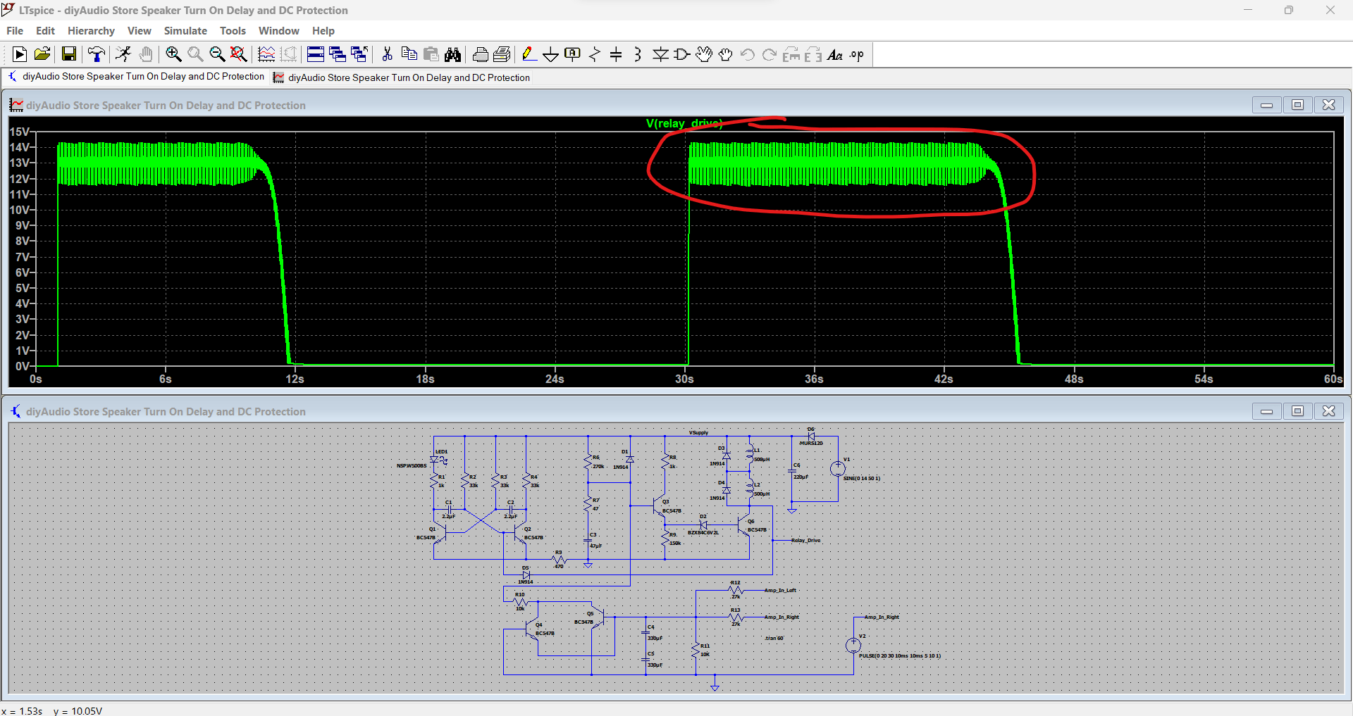

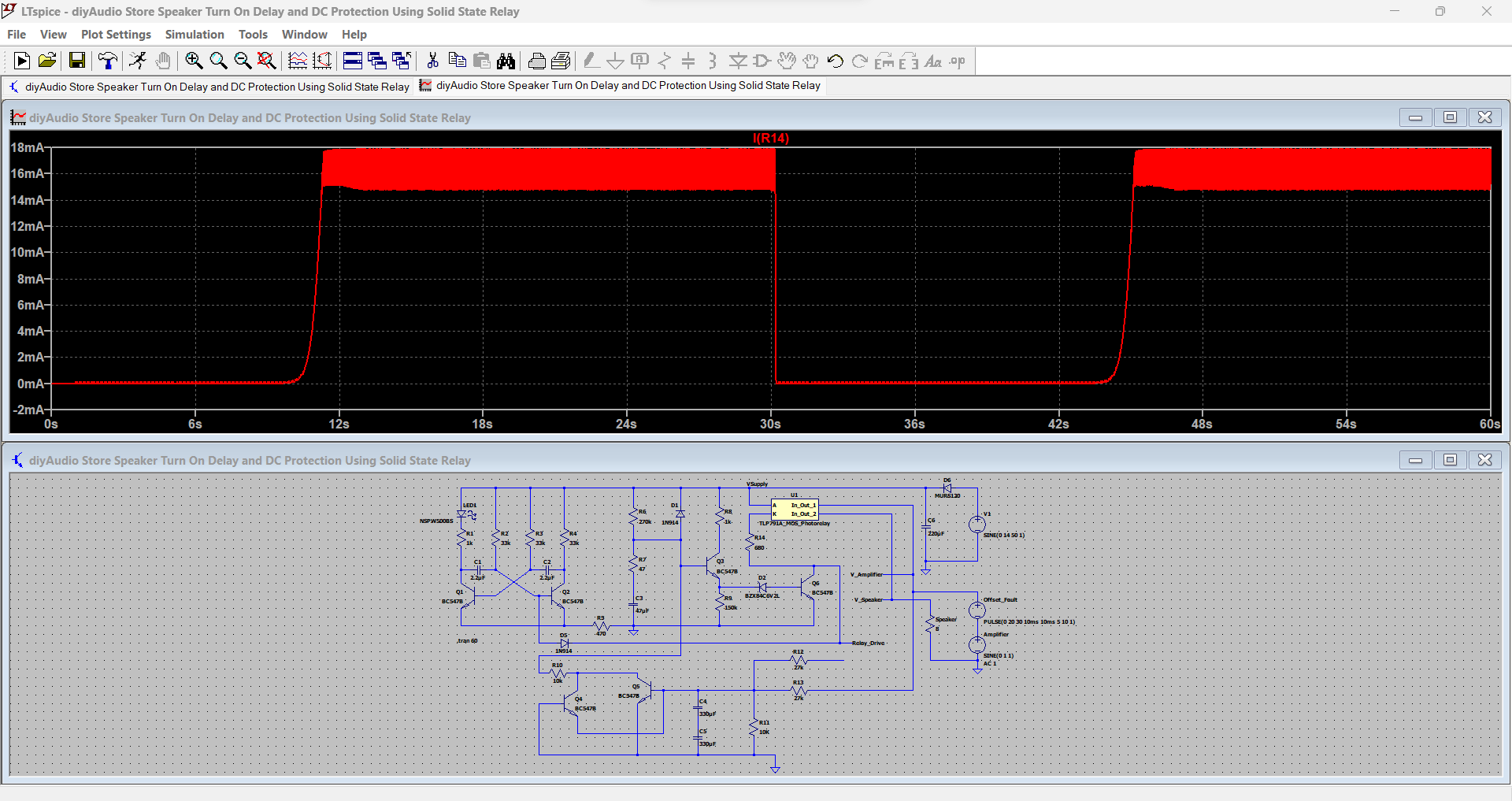

I've looked at the circuit for the one in this thread and... Arghhh... and there might be a problem. I've got simulations of the original relay version and so it was easy to drop a Photo Voltaic relay in its place. Hmmm... you need to try a real world version I think.

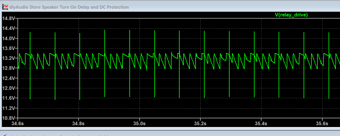

The simulation throws up a problem and that is that the relay drive voltage isn't a 'clean' voltage when a DC offset is present from the amp. What happens is that there are little glitches in the drive voltage and while they do not affect a mechanical relay they do cause an issue with the SSR. There is a lot of ripple on the rail by design of it having a small reservoir cap.
These are the glitches with the mechanical one.
If we expand the trace we see:
Those glitches seem to cause random conduction in the SSR.

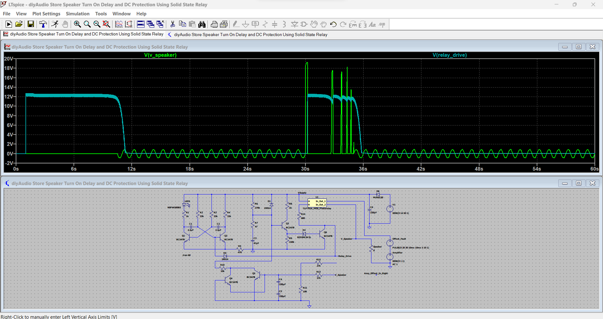

Here is the SSR with a simulated offset. The green trace is the speaker voltage and the turquoise the relay drive voltage. The switch on delay is perfect, it when a fault occurs that it behaves oddly. I've tried a few quick things like adding a series Zener to the relay LED but nothing works šŸ™

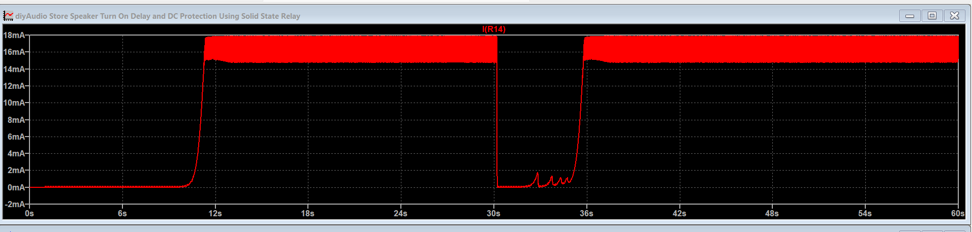

This is the current in the photo relays LED. Those milliamp spikes at the bottom during the simulated offset cause the relay to turn on. The big question is why is that happening and how would a real phot voltaic coupler behave.

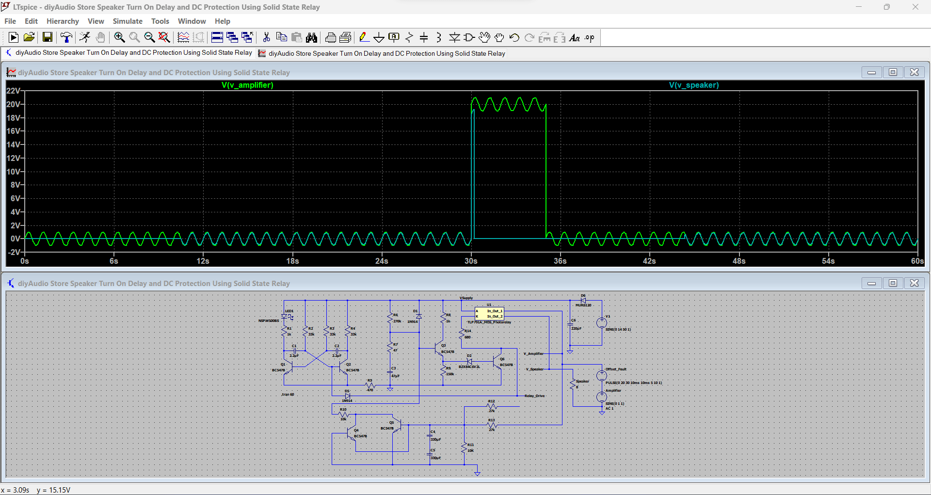

Well I looked and looked and tried lots of stuff and couldn't see the reason why... and then it suddenly hit me. Doh. I had taken the offset sensing from the wrong end of the opto. It was sensing from the speaker and not the amp output. So apologies, my mistake on that one.
So......
We now have this. The 'apparent' glitch at 30 seconds is due to the time constant of the DC sensing, the series 330uF caps and 27k input resistor.
This is the opto LED current. The ripple on the supply doesn't seem to be a problem now.

Thanks prasi,please give us a Christmas šŸŽ.
No worries,after Christmas is ok!

thanks Mooly for the sim confirmation, still would it be a good idea to use a simple regulator on board? it doesnt take too much space.
