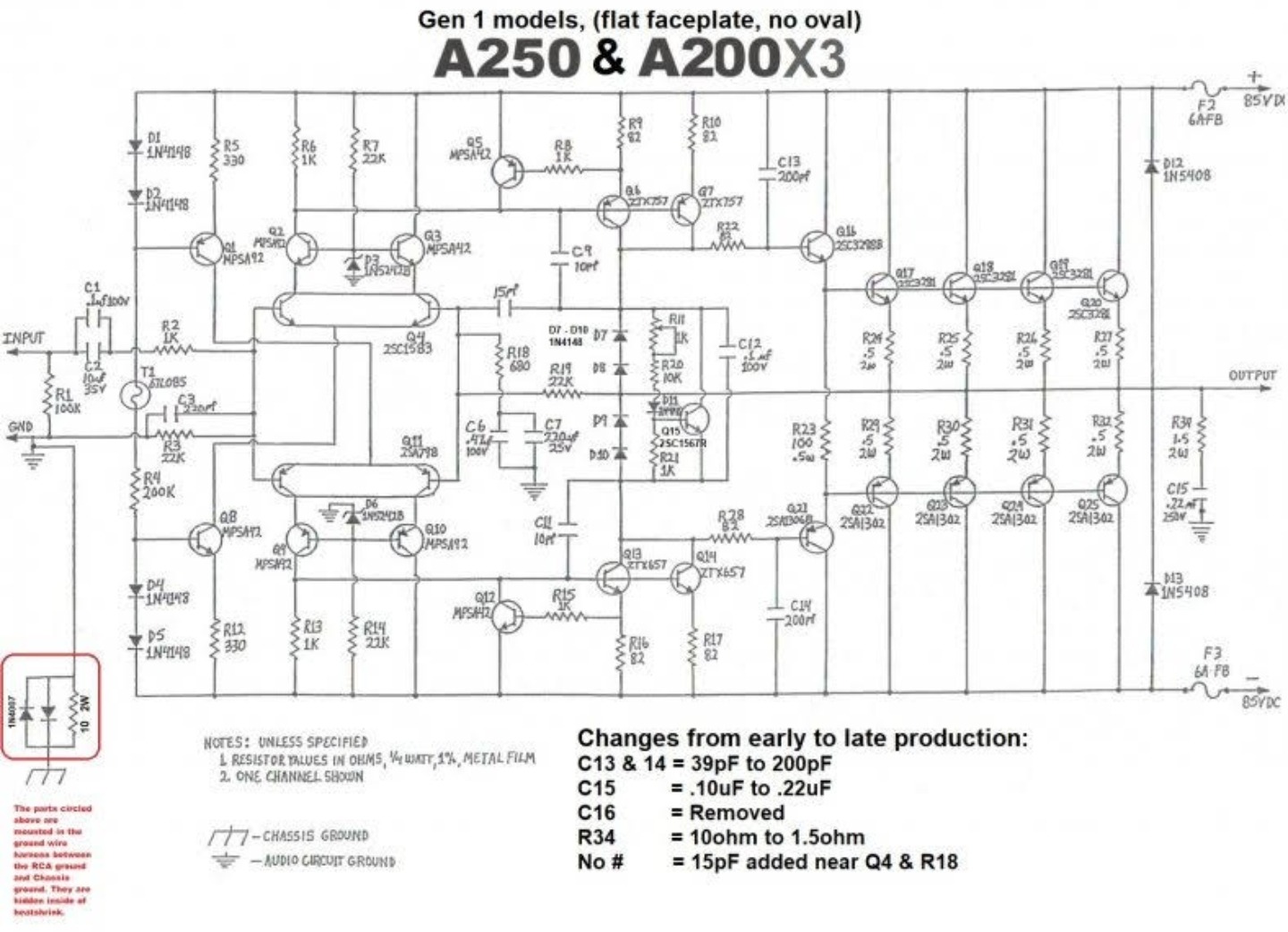

Acurus A250... 1kVA/123VAC xformer.Thanks. Wow, that's a very high rail voltage indeed but if that's what it is...

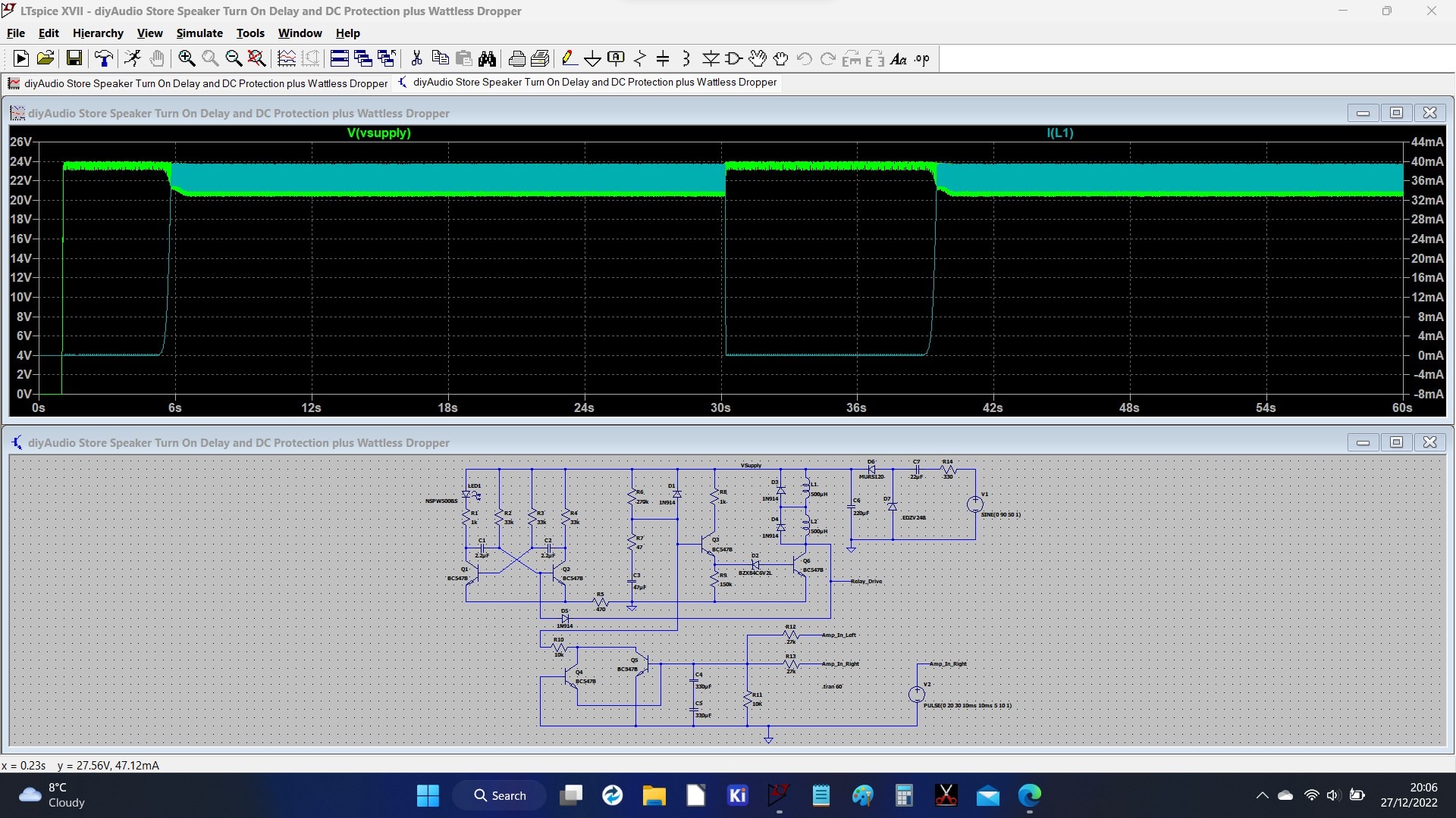

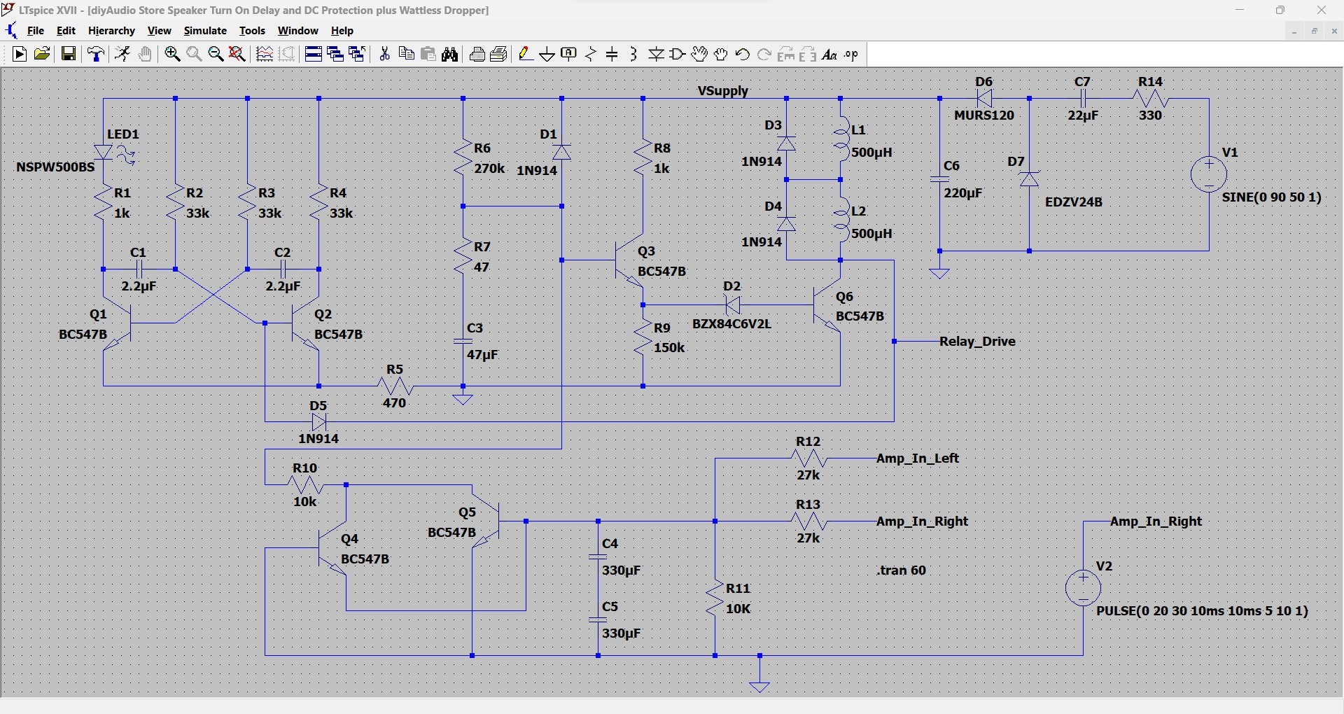

A wattless dropper uses the reactance of a capacitor to limit current but unlike a resistor the capacitor dissipates very little power. Dropping 90 volts to 24 volts with a linear regulator (which is easy) would waste a lot of power in the scheme of things and would run hot.
The dropper idea would look something like this... values are just an experiment. The AC winding is at the top right and set to 90 v which is the peak of the AC voltage.
It works in theory. A lot would depend on the relay coil resistance. The higher the better to minimise current draw.
I also wonder if a higher voltage version of the circuit would be possible, perhaps running on 50 volts dc with 24 volt relays. All ideas...
This shows the supply voltage with a wattless dropper and the relay current when the relays are active. In simulation it works but all this is just thinking aloud though at this point. The Zener gives a stable rail.
