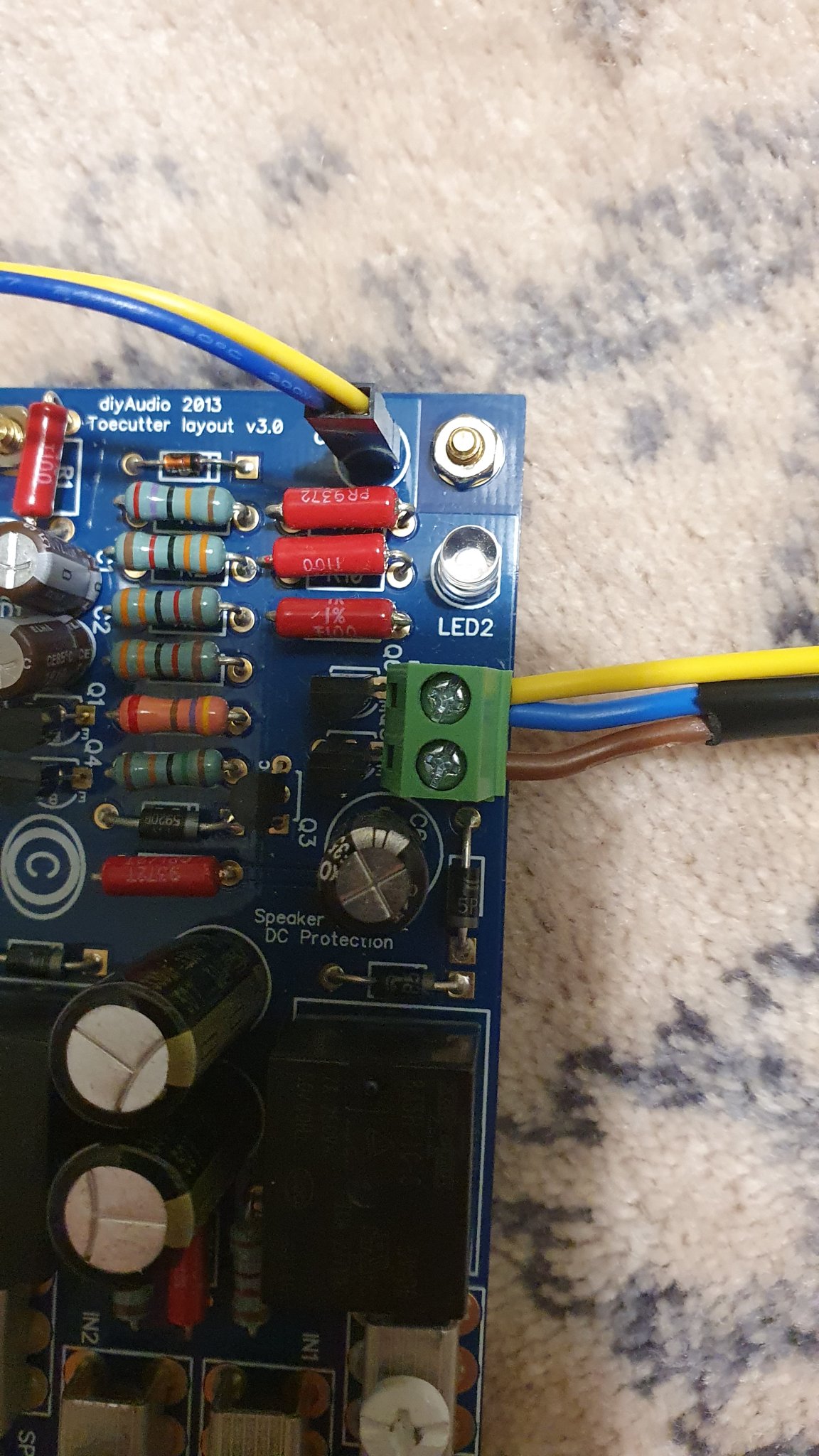

Hello , I have question about proper speaker protection board connection. I have 33+- VDC psu and separate 12 V transformator to feed SPBoard. Please check my connections . Brown and blue 12VAC , yellow ground PSu. in this configuration delay works good, but i am not sure if dc protection is also ok. i made test with 1,5V battery ( battery '+" to IN on board nad battery "-" to chassis. relay did not disconnect speakers .
1.5 volts is not really enough to trip the protection (and in practice would not damage a speaker either). You need above around 2.5 volts for a trip.
