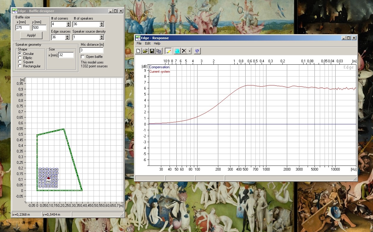

perhaps not, I played some with the Edge and below is an Edge simulation - no sphere, straight sharp edges, no felt, no waveguides but certainly looks interesting
You've got effectively a large area square driver (36 single-point drivers). It's not realistic. A round one with diameter equal to that size will likely look good. See what it does with a more realistic driver. Try it with a single tweeter with a realistic density, then do off-axis plots or a small midrange, maybe 130mm. Be sure to do the off-axis, since that's what's important, at least across some listening window.
I am thinking of a real 32 mm wide range speaker, Visaton BF32 perhaps, such drivers are pretty close to a point source:
a 10x10 square array of a bit larger drivers has been tested:
http://www.diyaudio.com/forums/full-range/164797-200-x-2-drivers-what-do-8.html#post2160121
a 6x6 square array seems feasible
why not?
