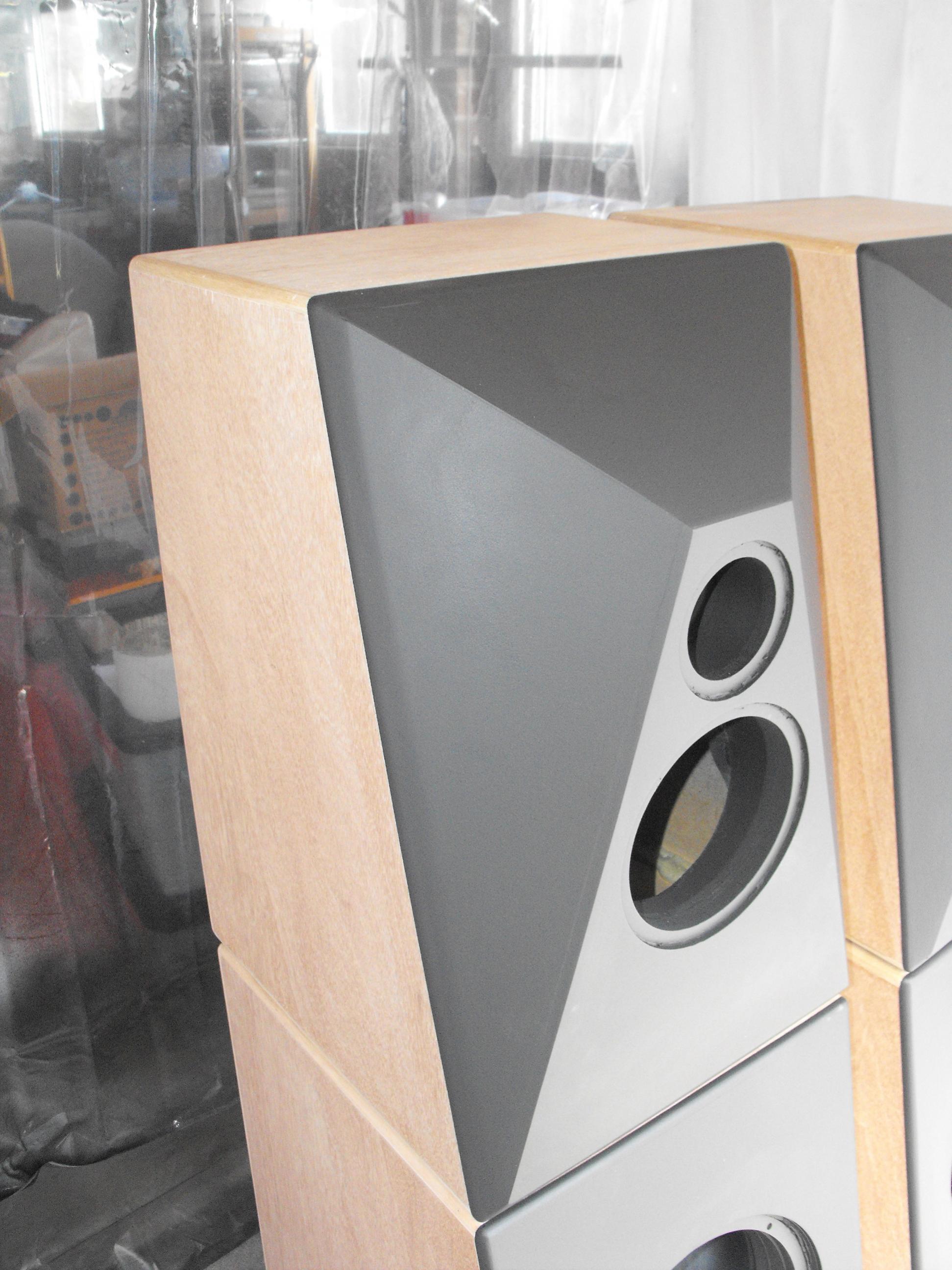

I've had good results using a 60 degree miter right off the baffle edge then a 30 degree angle on the side of the baffle. Easing the sharp edges over blends the cuts. This can be done on a table saw pretty easily.
Here is a sample piece I made before trying it. This is with two layers of 3/4" MDF. the inner layer could be a two inch wide strip if you didn't want an 1 1/2" thick baffle.
You can use large prefab'd radii, which I've done, or use a tablesaw to put a nice fat bevel on the front baffle, which just requires enough material thickness. If you start your build with a 2x2 sub-frame behind the baffle, you'll have plenty of corner thickness to do a big fat 45 degree bevel. Multiple passes with the tablesaw are fine, too, just make sure you do the setup right and it won't take that long.

Chamfers are effective and practical
According to the pioneering experiments of Olson, a 45 degree bevel can be very close to the ideal of a sphere. I did this with table saw and 12" sliding compound saw.

I called it ineffective (your first link is to my page) because the question was related to surface mounting, then using felt to try to effectively flush mount. I have tested this as I had hoped it would benefit. It is ineffective as I described it above. The felt is both ineffective at the tweeter faceplate edge and does too little for the baffle surface because it is too thin given that most tweeters have a faceplate only 3-4 mm thick.
