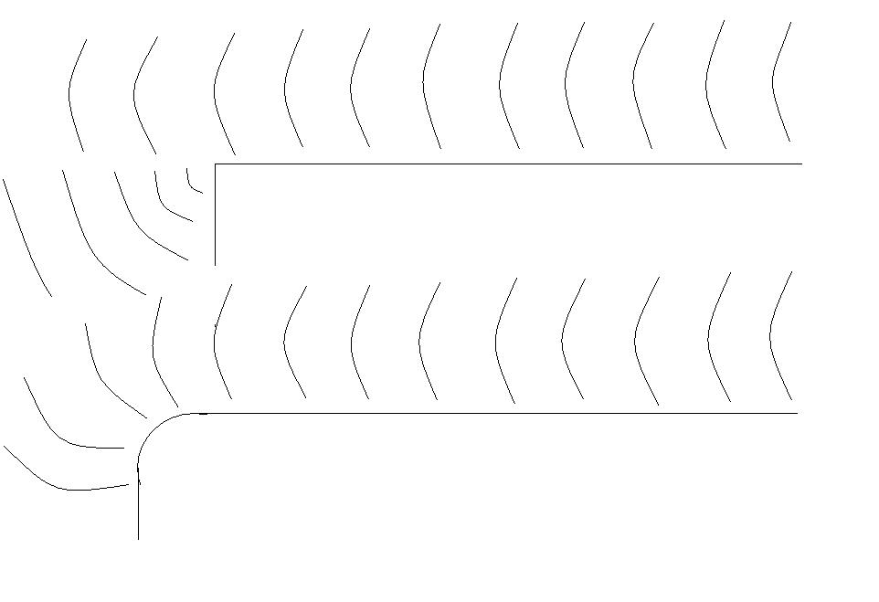

My understanding is that AF wavefronts behave the same as RF wavefronts. Did you ever wonder just why & how radio reception gets lousy when your deep within a valley.....the station fades out? Wavefronts ...I would say "stall out" at the top of a hill/mountain ...but the edge where it "stalls" regenerates & starts 'transmitting' again at that edge. Let's say the station puts out One megawatt of power...it gets to that edge & 'stalls'......It 'stalls' at the edge of a mountain with only 3 watts of power.........picture a phantom antenna, having only 3 watts of power now transmitting down the back slope of the mountain.
Same thing with AF.....A 'retransmitting' of the signal originating at the baffle edge. What frequencies, multiples of fundamentals, or phase shifting....I don't know the particulars.............It is of course easy to put a big a** radius on the edges to null out these diffractions.......consider it a basic rule of thumb......a must do on any design.
_________________________________________________________Rick...............

Rounding edges does not lessen diffraction. It smears it over a large frequency range as the edge is now seen as gradually fading. This is similar to off-setting the driver from the exact center.
The diffraction peak frequency or apparent edge will be the halfway through the rounding.
Chamfering will have a similar effect. Although two having 2 peaks at each end of the chamfer. In many cases a chamfer will have a better result than a rounding especially if the chamfer is relatively large.
In many cases it's also worth considering that since the total diffraction is always the same as you cannot stop waves from transferring from 2Pi to 4Pi unless you have them built into a wall, then maybe you can use the diffraction constructively instead of trying to minimize the effect.
