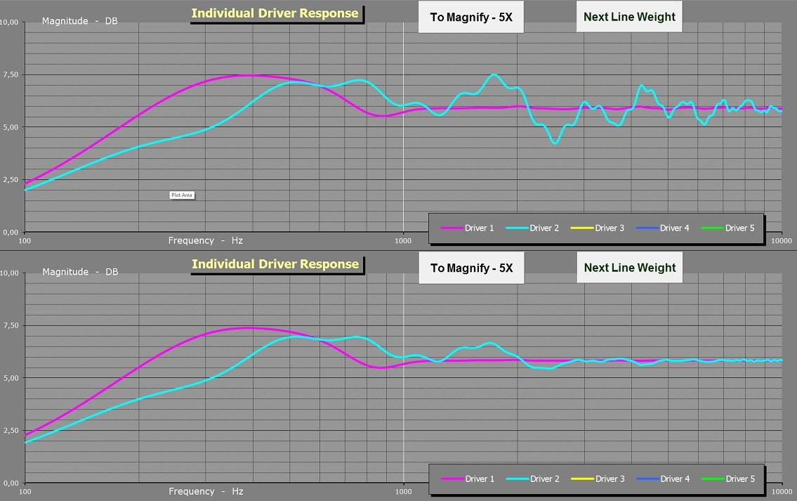

After toying around with the BDS I have this picture to share.
The top half is a sim for sharp edges and the bottom one is 2" round edge.
To me the interesting part is the purple line since it tends to support what I've been saying the whole time. Rounded edges appears to have very little effect on a large driver.
The bluish line is the tweeter and at first glance there looks to be a bigg difference here. Looks can be decieving however. The software is unable to model a compression driver in a waveguide and becomes pretty meningless.

Yes, it's true, that larger drivers tend to make it less of an issue, assuming a baffle not much larger than the driver diameter. Also, they see less benefit from roundovers or bevels OF A GIVEN SIZE relative to smaller drivers like tweeters, because of the size/wavelength relationship and their inherent HF directivity.
But the changes from the blue tweeter are substantial as shown (and likely understated). Diffraction changes a lot as you move the mic position, making a dramatically less coherent soundfield, and damaging intelligibility and imaging.
A +/- 1dB ripple reduction is quite meaningful to those of us who are pursuing the absolute best we can reasonably attain.

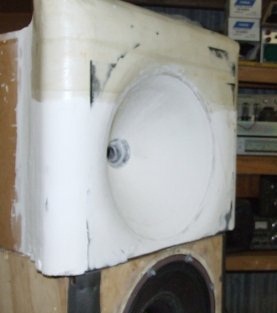

I tried to cinch this issue with a recent build (snapshot taken during construction). I was looking to reduce diffraction back towards the throat from the mouth, hence the size. This is mostly similar to the waveguide it replaces other than this mouth improvement, a change in the throat profile and using better materials.
When measured, there were a few acoustic issues (as one would expect) but they appeared to be simple in nature and low in level.
What I noticed when listening is that this now sounds as if it is crossed over within the passband of the device, in other words it sounds as if it could be crossed lower and that the current crossover frequency is wastefully high. In addition this waveguide manages a good disappearing act.
The crossover frequency is below 1kHz. The outer radius is 2", the waveguide to baffle radius is 4" and the tweeter cab is 25" wide (beside 15" woofer shown, which I no longer use)
