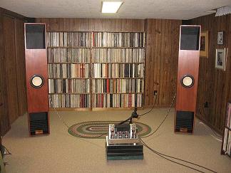

Mahogany veneered Sachiko
Finished these about three weeks ago. Maple ply with mahogany veneer. Polycrylic over veneer. Non-veneered wood is painted black using General Finishes Lamp Black milk paint.
So far I've built two pairs of Saburo's and two pair of Sachiko's. One pair of Saburo's I used Canadian Maple ply, the other Imported Cherry Ply. One Sachiko was built with Birch and the other Maple. It has been interesting hearing the differences between wood species used in each of the builds.

Re: Mahogany veneered Sachiko
Very nice. Any chance of a bigger picture?
cervelorider said:Finished these about three weeks ago. Maple ply with mahogany veneer. Polycrylic over veneer. Non-veneered wood is painted black using General Finishes Lamp Black milk paint.
what, no MDF?
seriously, tho - care to attempt subjective descriptions of the sonic differences between the materials?
don't be afraid to use colours, flavors, or any other analogies
and remind us of what amp(s) you're using?

Wood
In short, the Maple seems more "lively" sounding than both the Birch and the Cherry, in both the Saburo and Sachiko designs. The Cherry, and to a lesser extent, the birch, seemed to exhibit a bit more weight, without sounding dull. By no means is one "better" than the other. It boils down to what flavor one prefers.
As for my system in which all four have resided at one time or another:
Jolida 300B amp, Decware Zen with EX mod, Rawson Gainclones
(one integrated and another standalone with a Grounded Grid tube preamp & passive pre currently)
Rega Apollo CDP
Garrard 95B table and Plinius Jarrah phono preamp.
Copper DIY speaker cables and interconnects.
Rega Apollo CDP
