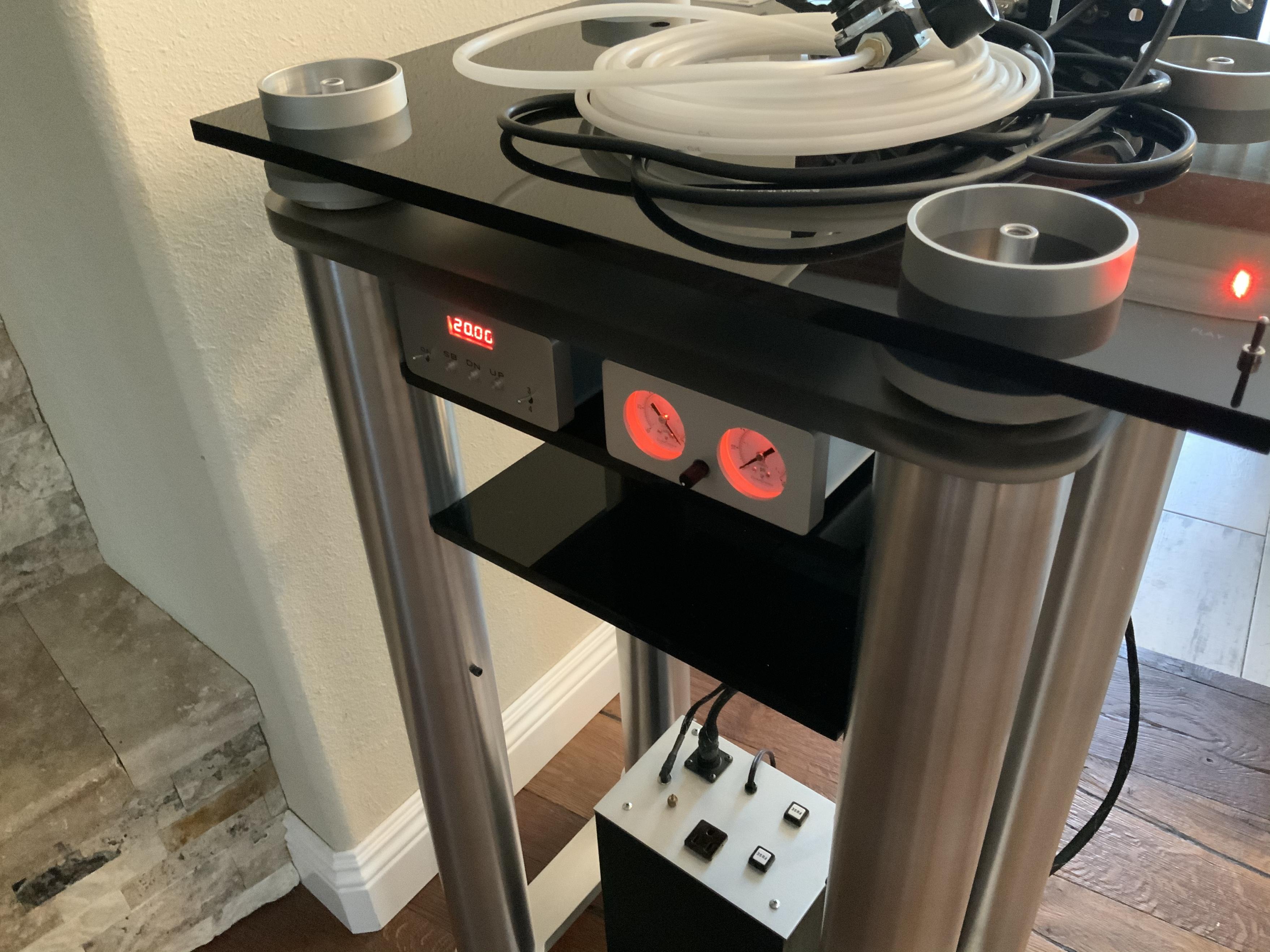

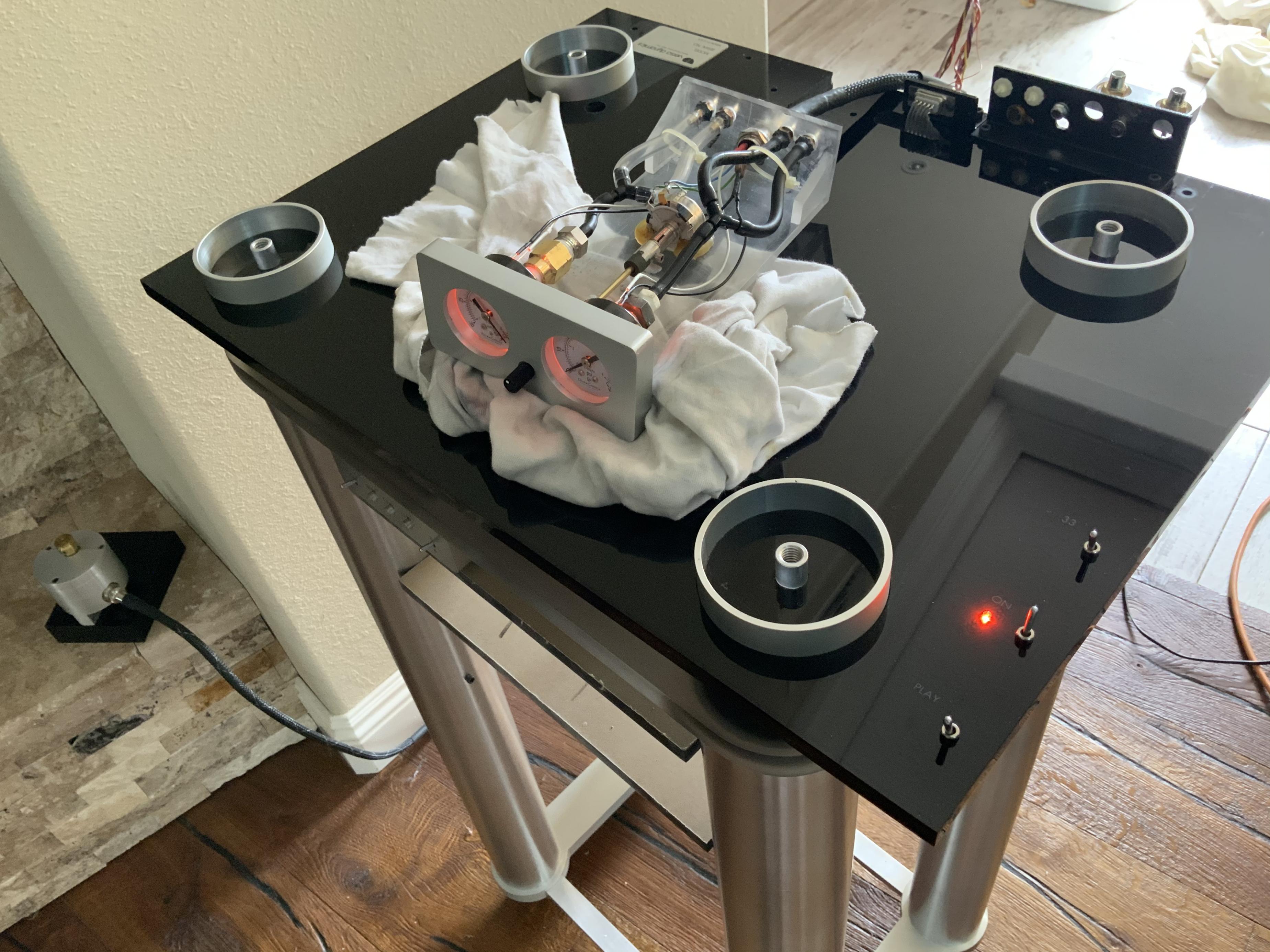

While rebuilding the Versa , I did make a lighted vacuum and pressure gauge/ enclosure to monitor everything.
The center knob controls the vacuum pressure as it is the same pot value in the
Sota box.
No , it will have no effect on the pump vacuum, its simply in series with vacuum line to the gauge
As far as the oil I used a synthetic instead
Regards
David
Great looking stuff! I just began to look at gauges, and they all seem to have those huge brass fittings. I have to figure out the adapter to small houses in my ps/vacuum box. And in my box the gauge can not be in series, it will have to be connected with a “T” connector... Which brand gauges did you use? Thank you
814BBF07-298D-45A2-A24C-C5DADE52FD5C.jpg I searched for the smallest dia. gauges and picked up these on eBay, however the vacuum one is not sensitive enough to be deemed very accurate, the pressure is fine.
I was looking for the same dial markings style from the same mfgr. which limits your choices
If you have no constraint on size go bigger imo.
Even the small dia. gauges have big end fittings and you have to get creative in the brass hardware dept. of your local hardware store. I had most of the air connections from years ago and the reason it’s a mishmash of connections . Had to machine a few PCs even, a pain
The -T - air coupler can be found in auto parts store or aquarium supplies
Regards
David
