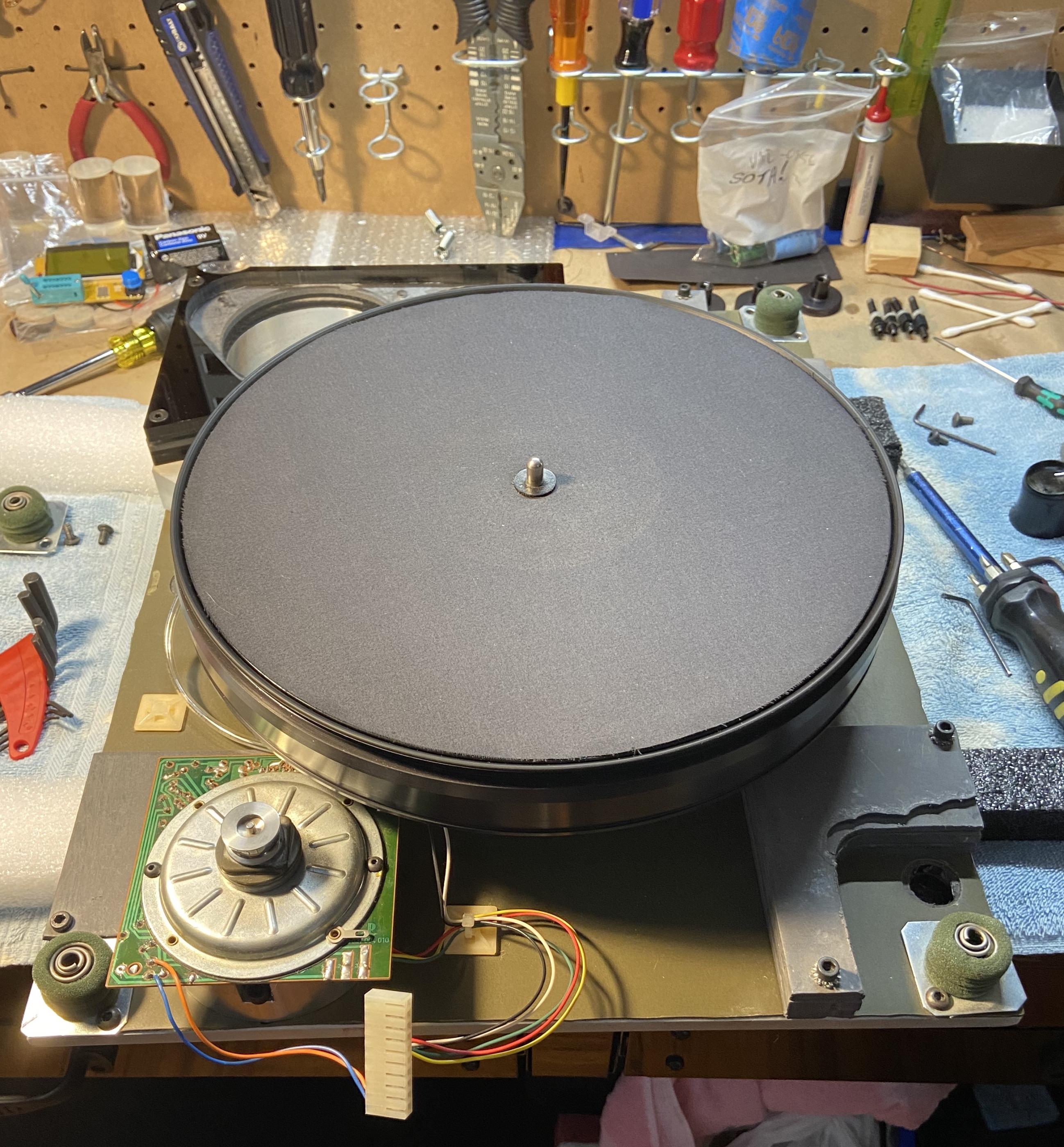

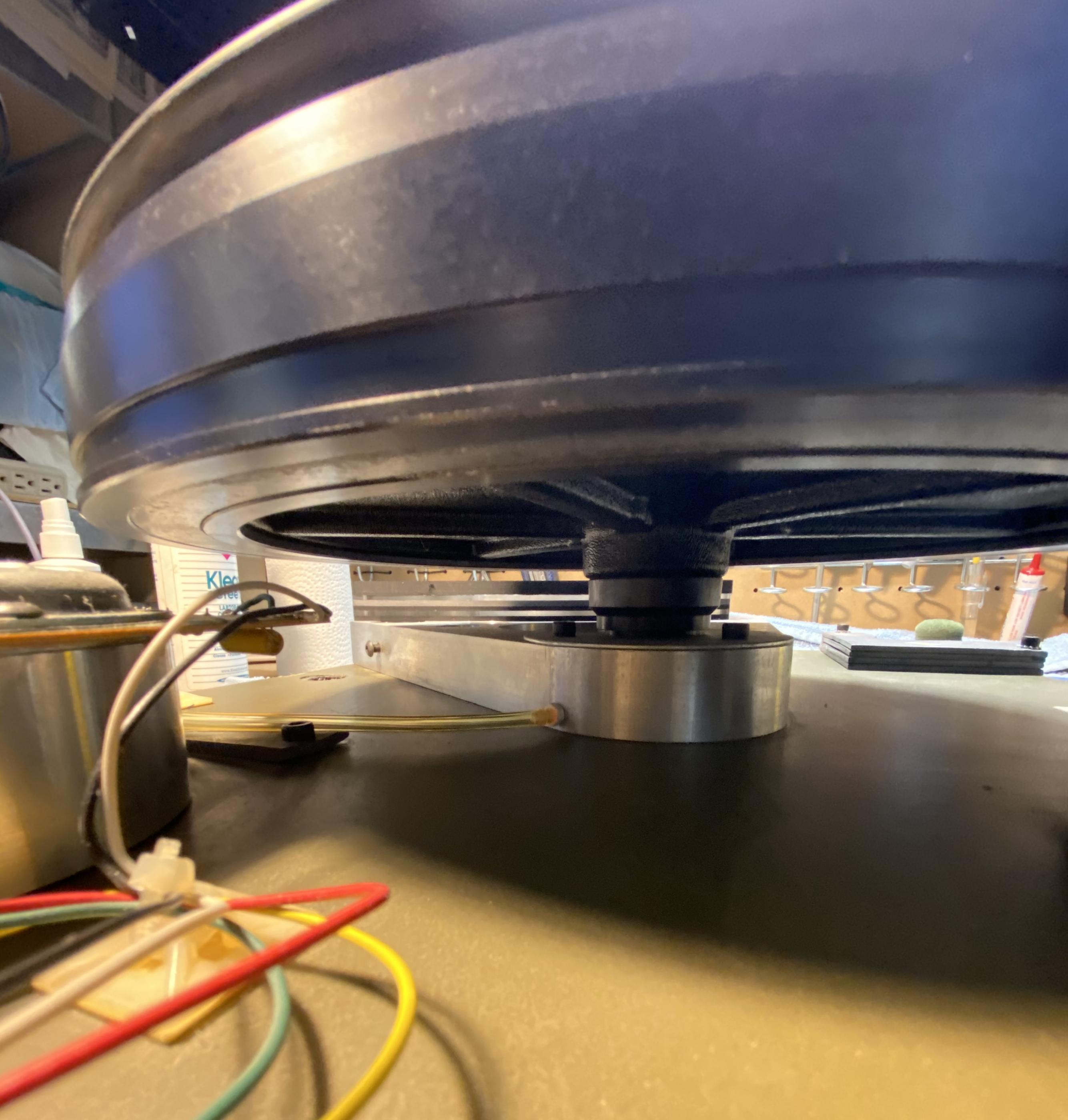

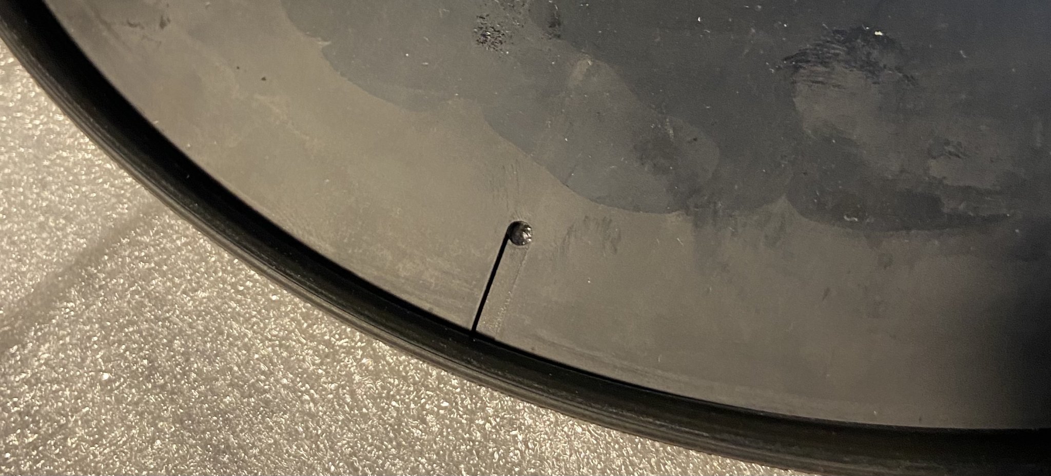

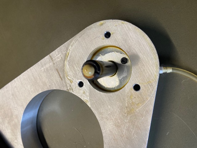

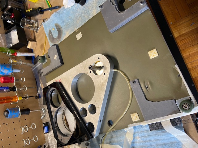

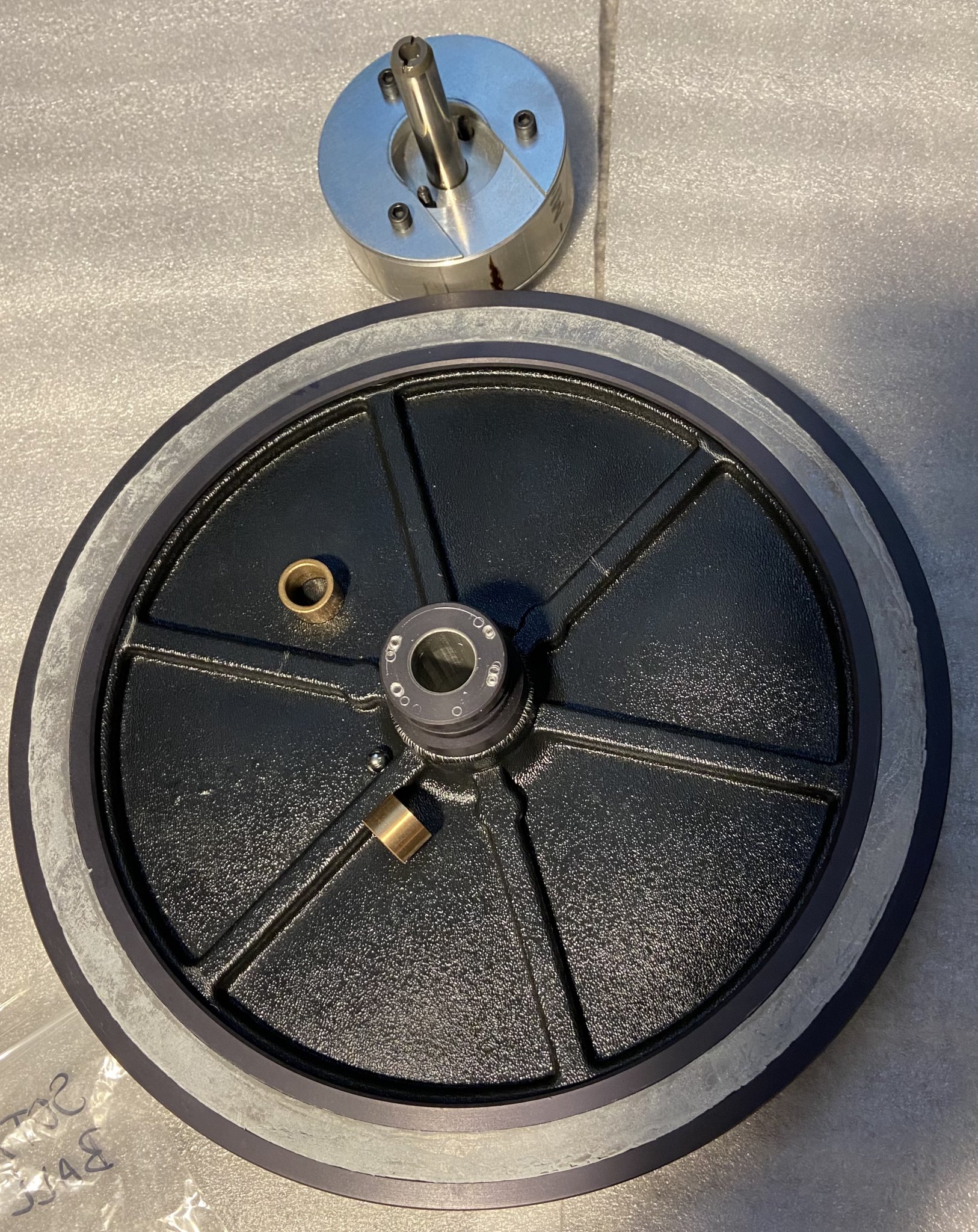

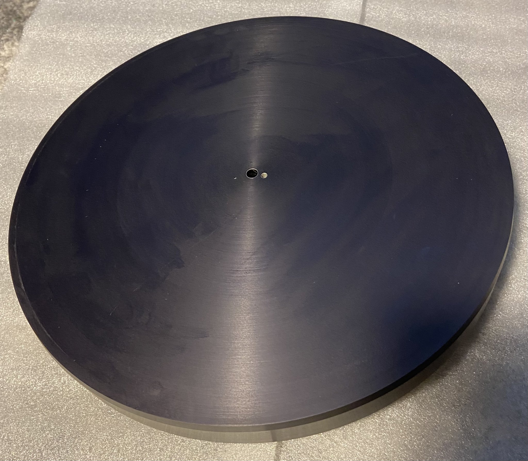

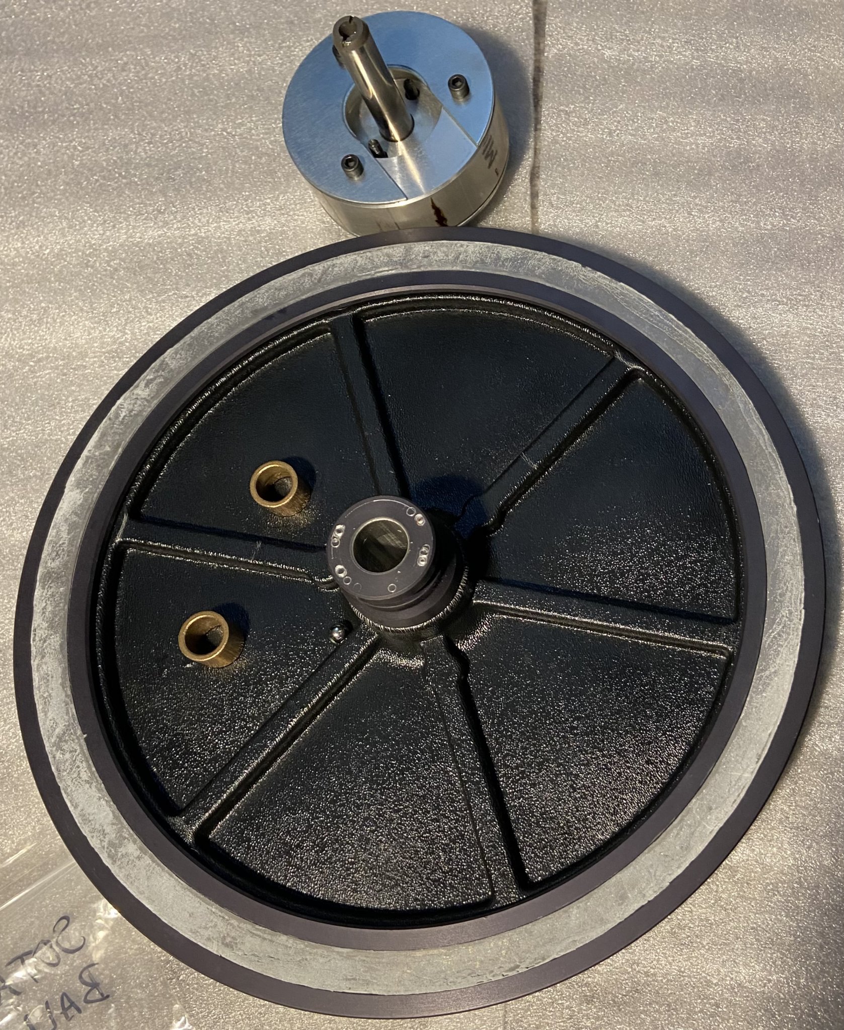

Ok, so here’s the disassembled platter. Spindle piece was removed before me by somebody using probably a hammer, because the top of the spindle has minor damage. I used wood. It came out with an effort, but nothing too dramatic. Sapphire, as I mentioned before, has cracks in it. Later on that.

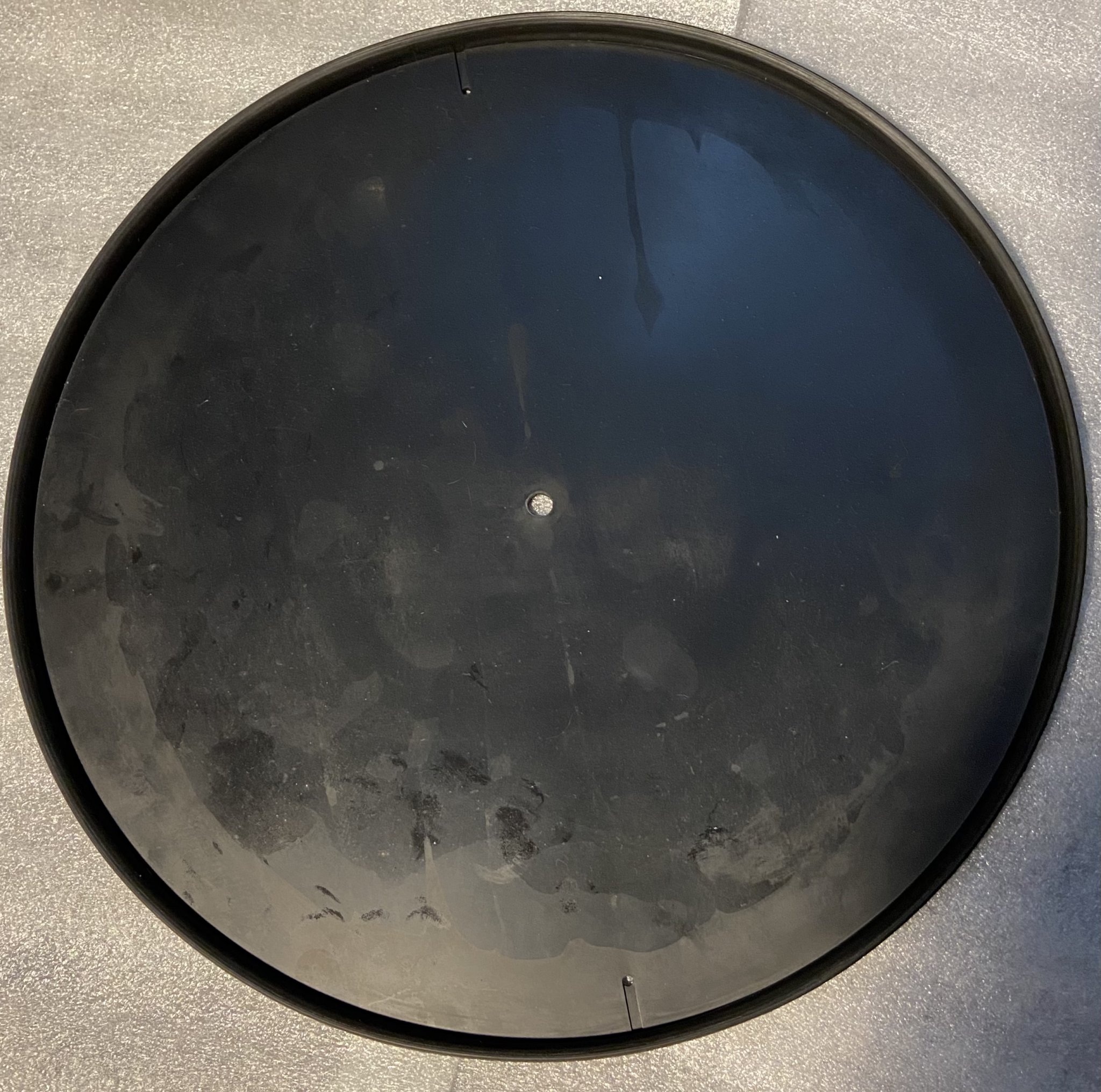

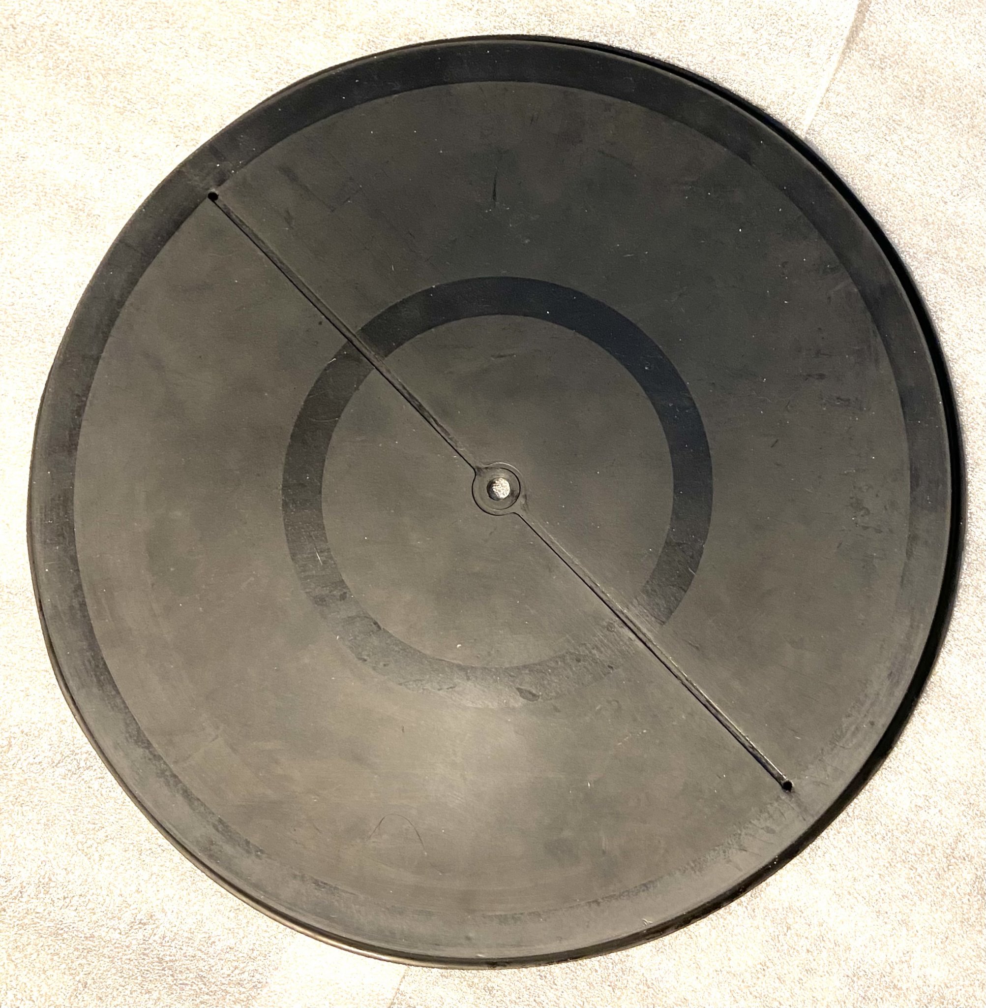

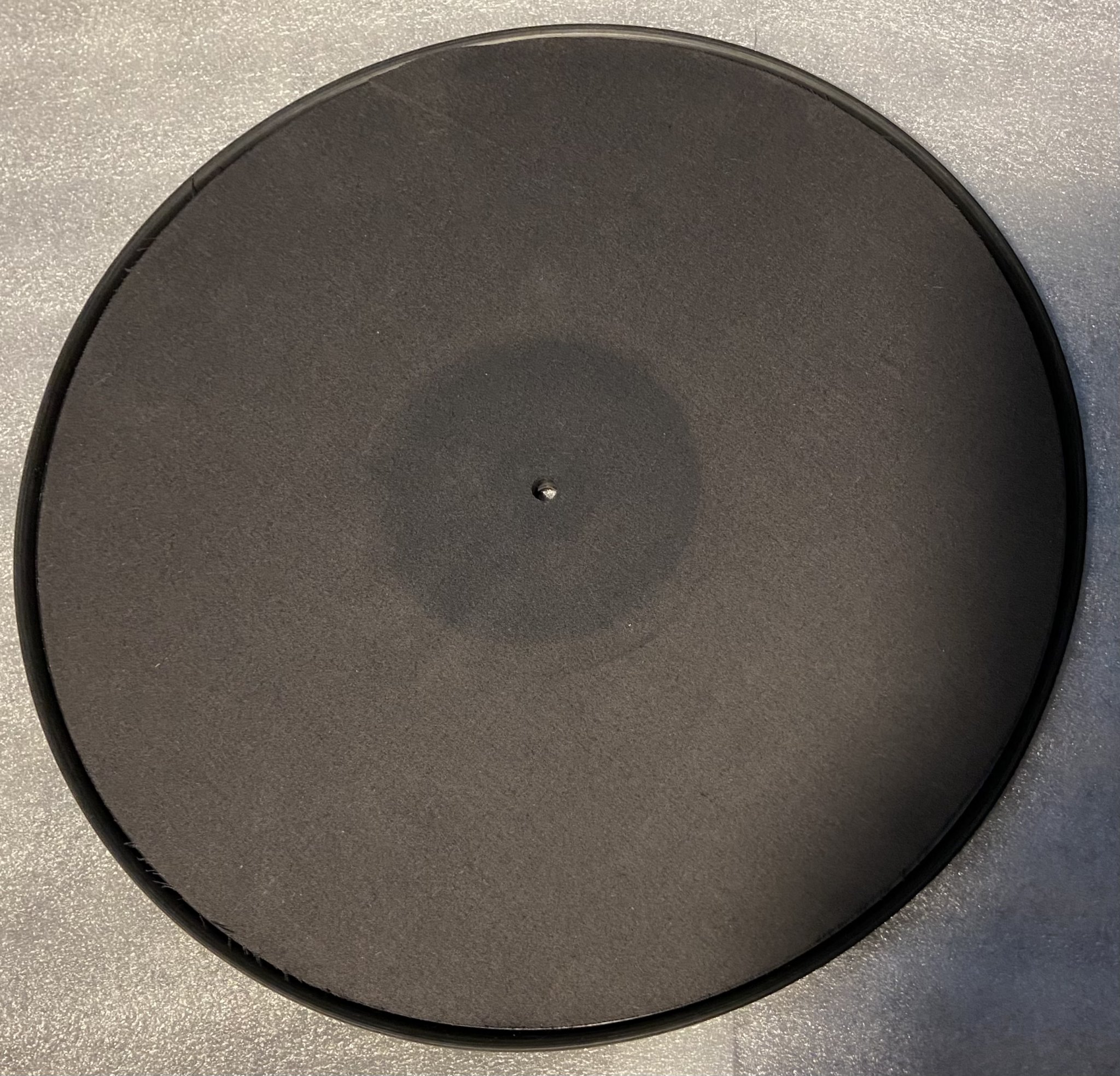

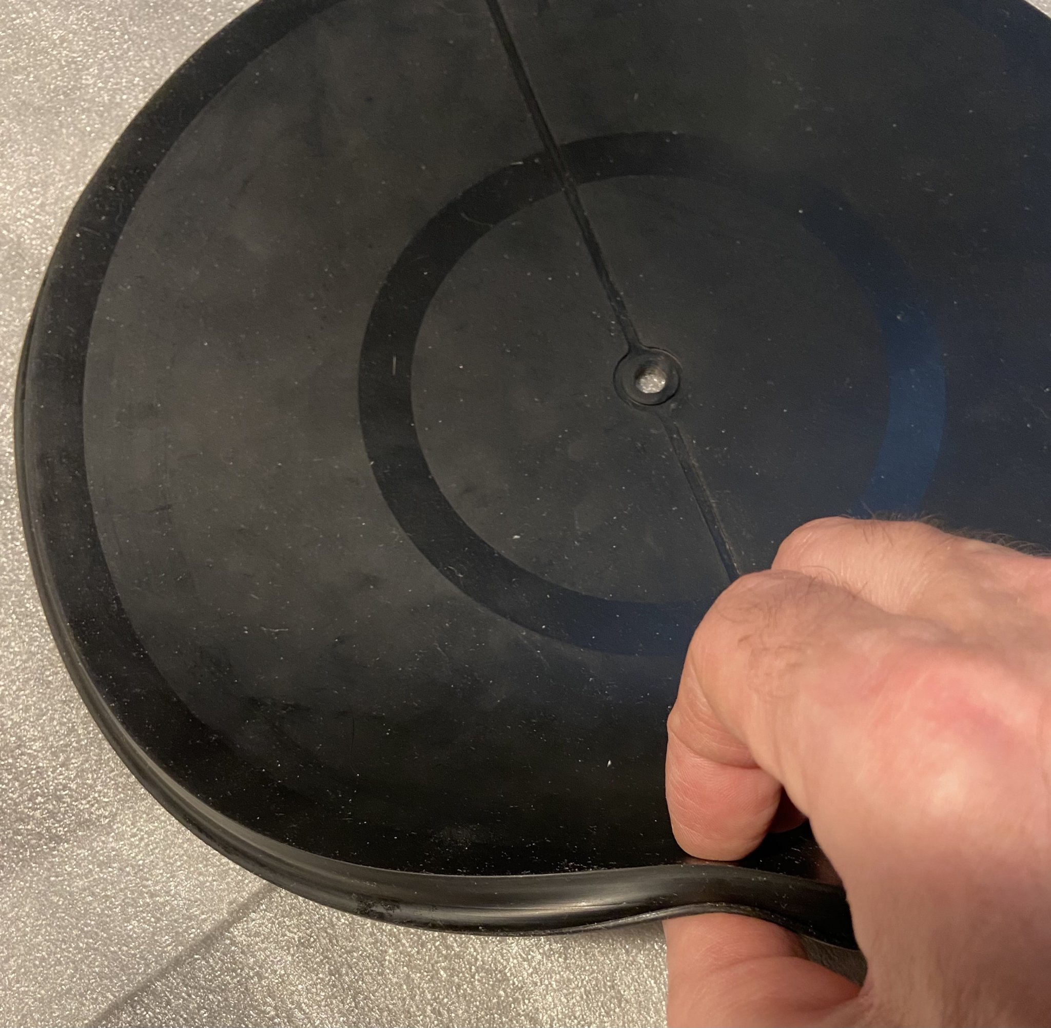

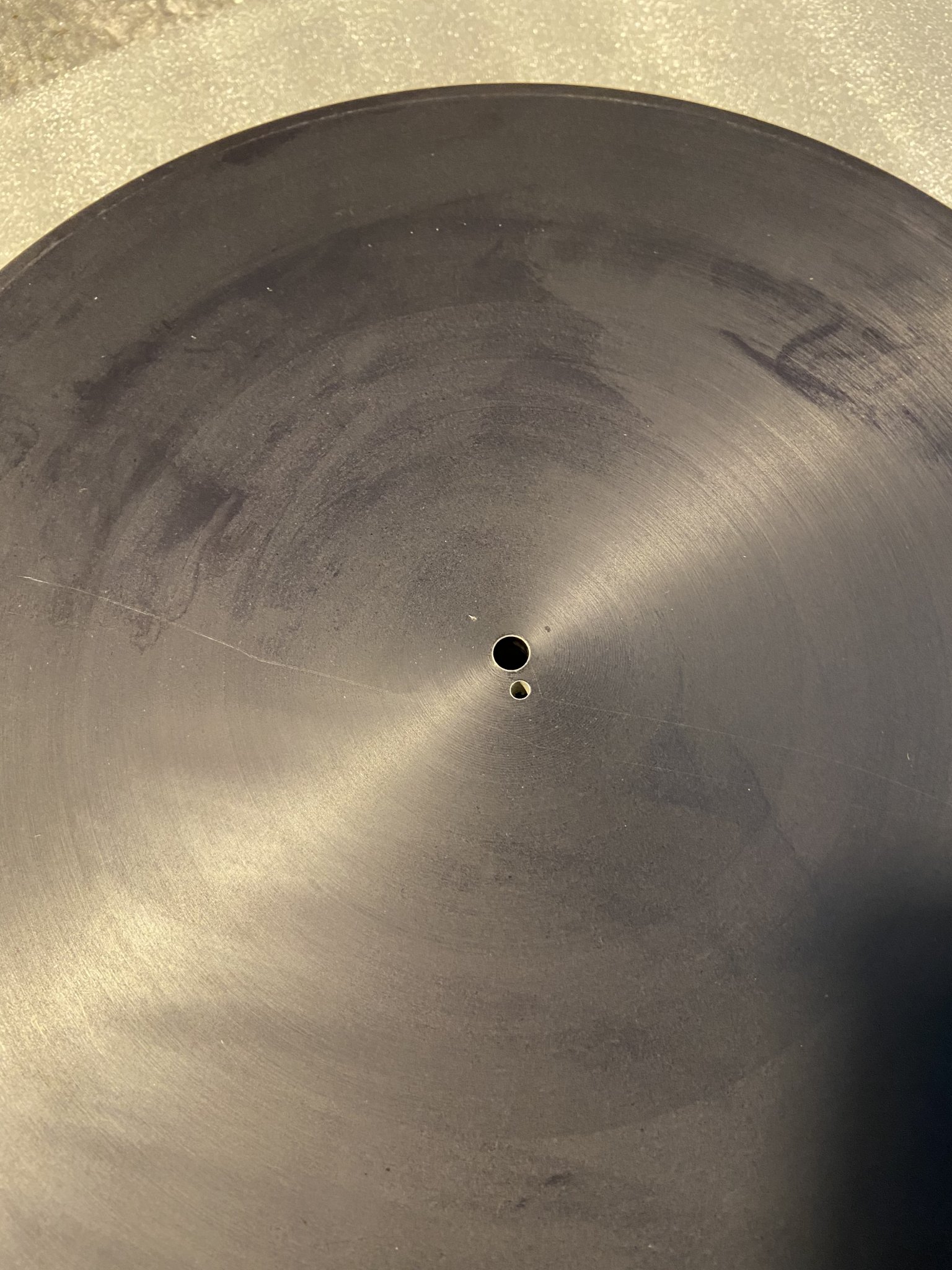

Vacuum hole is clearly seen on top of the platter. Acrylic top layer with fabric is removed rather easily, I’m not sure yet what’s holding it to the rubber layer. Rubber layer top shows vacuum channel holes. In the underside discoloration are clearly seen, where circular double-stick tape was used. I found only one place online that sells it, and each sheet is $50, not cheap. I imagine tape is used for ease of disassembly. Platter can be easily reassembled using 3M spray adhesive, with careful masking of the vacuum channels. The biggest two problems here are:

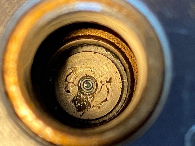

1) Oilite bushings. They came out with a standard pulled rather easily, but they seem to be a non-standard size, so I don’t know where to get them yet. Oilite bushings can not be rimmed or “opened-up” to fit, they have to be exactly made to size. Any attempts to adjust the inside diameter will result in destroying the porous surface, and will result in horrible performance. I think one of the posters here or in the other Sota thread ran into this problem;

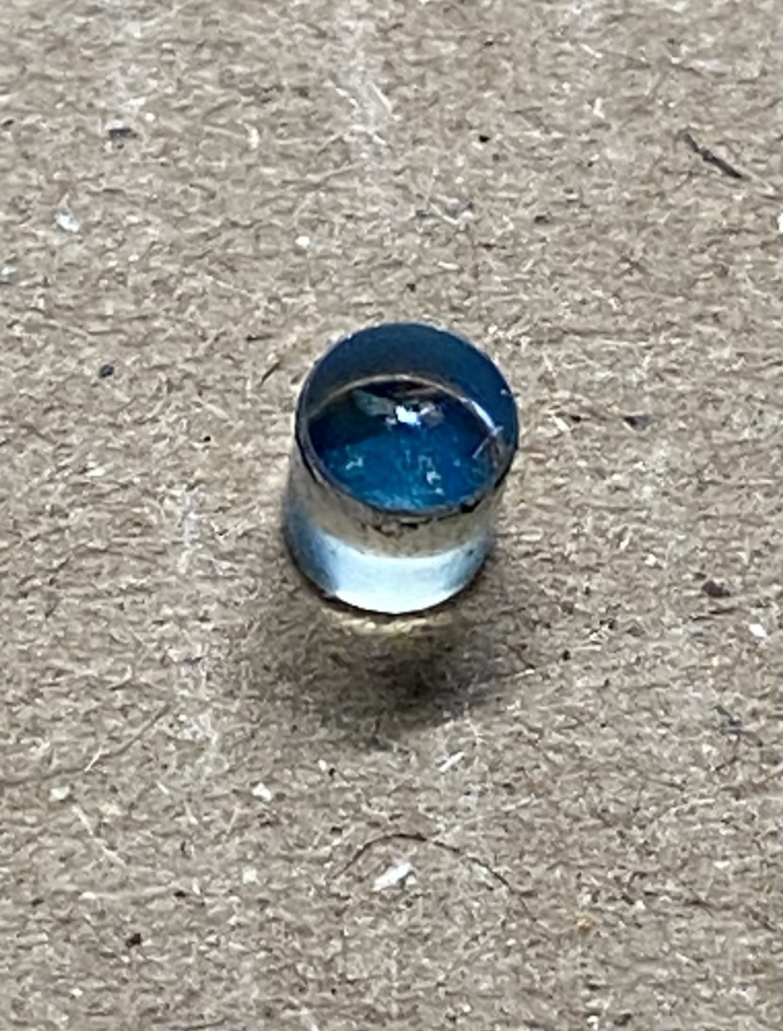

2) Sapphire. Has to be custom made. Or, the one that’s available on ebay can be used, if properly glued right on top of the old one. It is slightly larger, and, since the original is slightly recessed, it has to be glued on a supporting bed, such as two-part epoxy, if it will withstand oil exposure. The new sapphire plate is also very skinny, so it has to be dealt with more car. Perhaps someone can produce exact replacement.
That’s all, faulks!
PS With new bushings, proper ball/plate lubrications, new belt, motor in good condition, very decent wow/flutter figures can be obtained from this table. With fresh coat of 5W-30 automotive oil, imitating new bushings, my table showed very impressive 0.11% in one iPhone program, and 0.07% (!) in the other. Not bad at all for a 40-yr old belt drive table, imho.

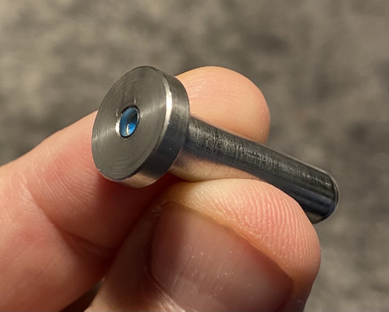

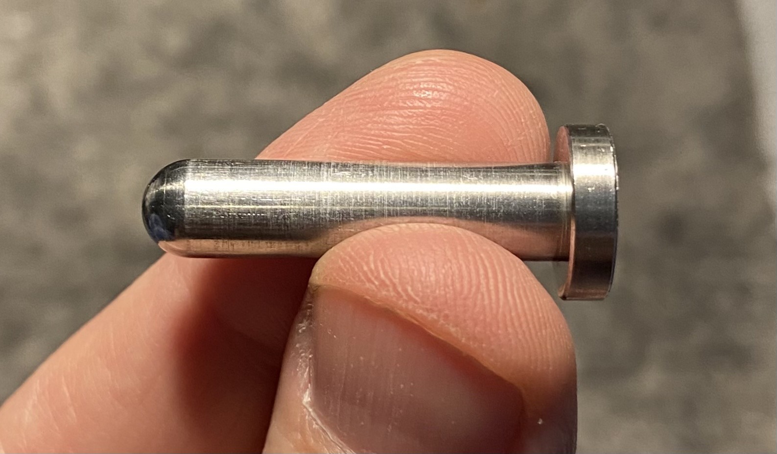

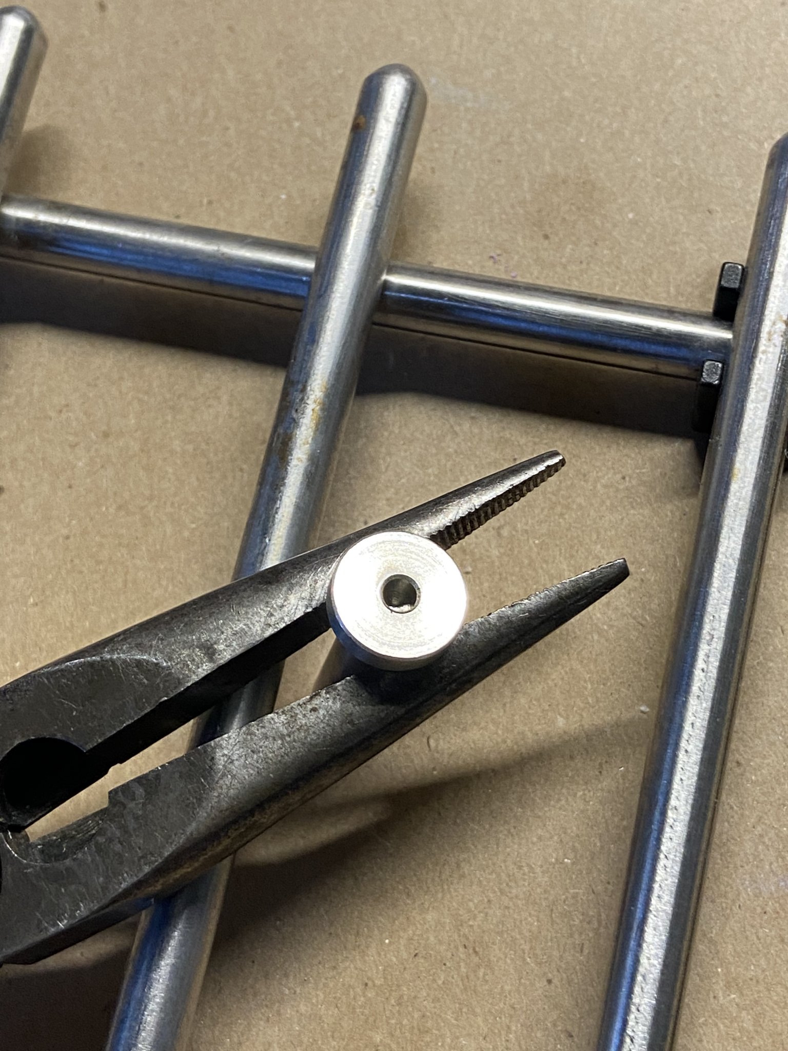

And this is how to remove the sapphire thrust bearing out of it’s housing intact: I used cigar lighter and it came out within a few seconds. It’s held in there by blue locktite.
Reverse the sapphire and Lap the other end on a diamond stone , fine of course
use JB weld in its original housing and spin the fixed stone with a drill but will have to find a way to cross
grind the end as just holding the stone against the diamond surface will result in a crest
because surface speeds vary for center to edge of sapphire
better yet, take the glued assembly to a jeweler who can polish the end
Thank you. Sounds great. Except I don’t have the tools you mention and I have never done it ))). There are pretty bad cracks on the work side of it, so a new replacement would probably be in order? I don’t know, what do you think? Swiss Jewel company in PA can produce one to order, I’m not sure about the price but I imagine it will be around $50.Reverse the sapphire and Lap the other end on a diamond stone , fine of course
