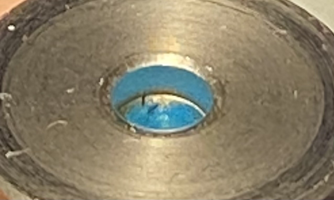

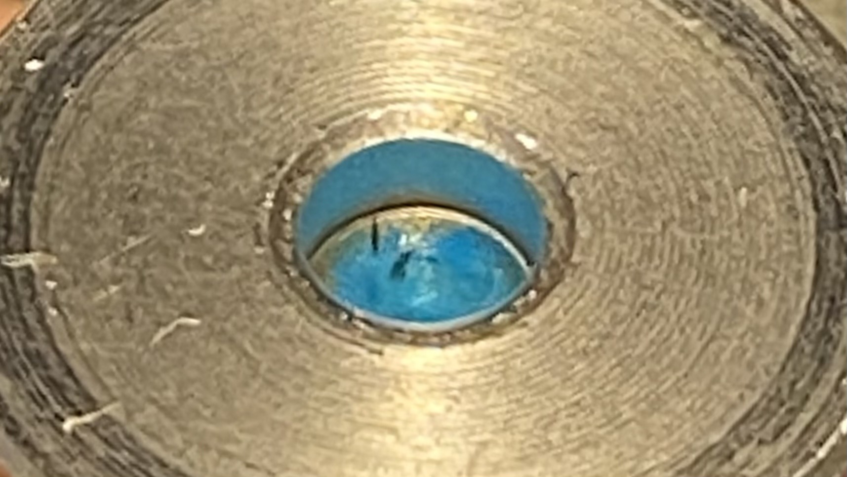

Here’s mine with just a smudge but no pitting which would mean it would only get worse. I believe Marks had this deep pitting resulting in the poor measurements meaning the disc must be replaced

Hi. Long time no hear ))). Yes, mine has a pit/hole smack in the middle. I have-up on this project. I’m using it occasionally. I replaced the Sota belt, which is a smallish diameter and puts a lot of pressure on bearing, with a wide and large aftermarket; I use either light turbine oil, or graphite lock oil. They are very liquid. Anything heavier than that will cause bad wow. I don’t think it’s the sapphire disc in my case as much as the lousy low-torque Pabst (or Papst) motor. The saphire dusc on ebay is huge, it does not fit into the existing hole, but rather lies on top of the old disc. I know, I bought one. Right now, with occasional lubrications, it spins with almost inaudible wow. I got another table since then.

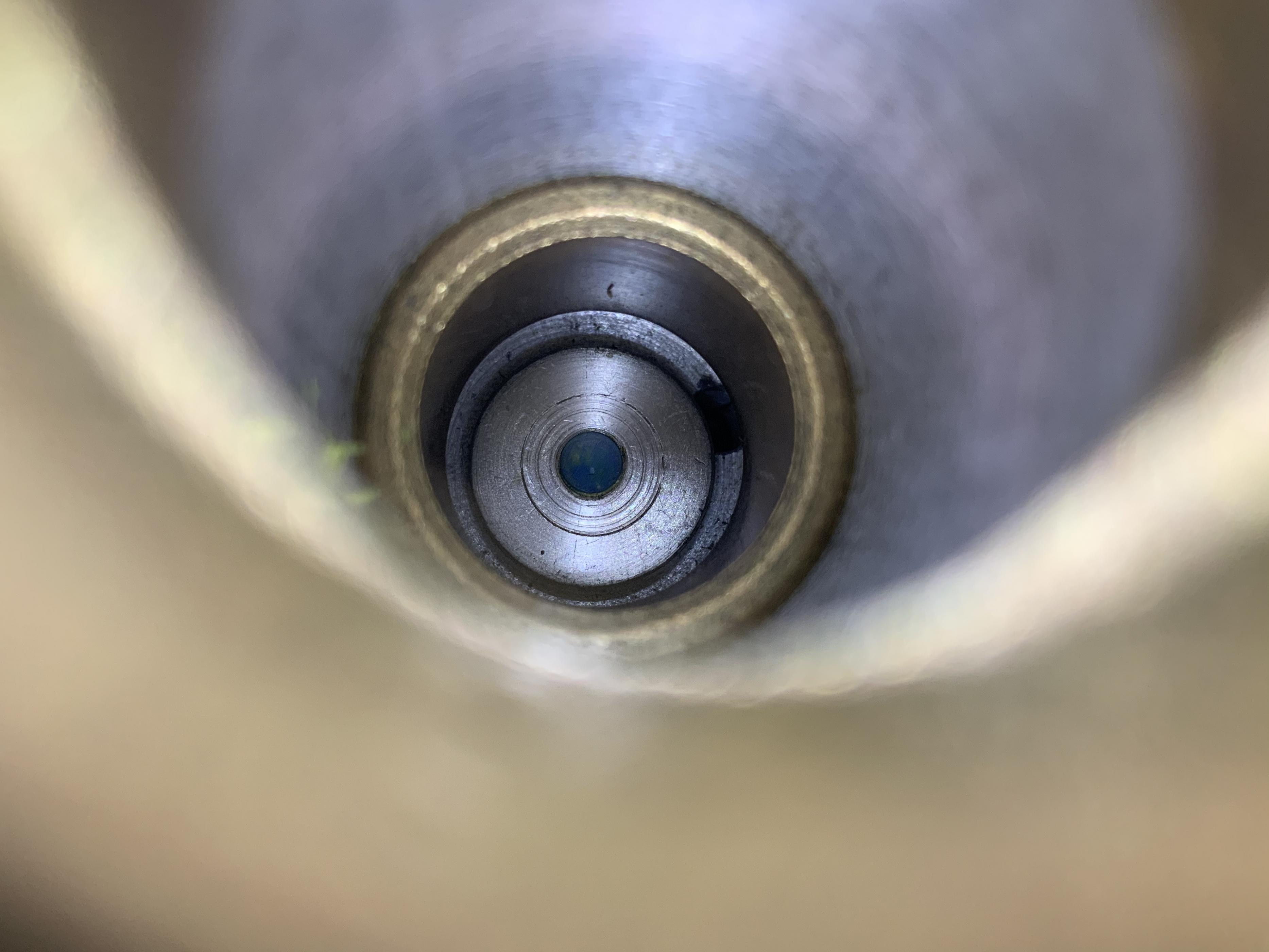

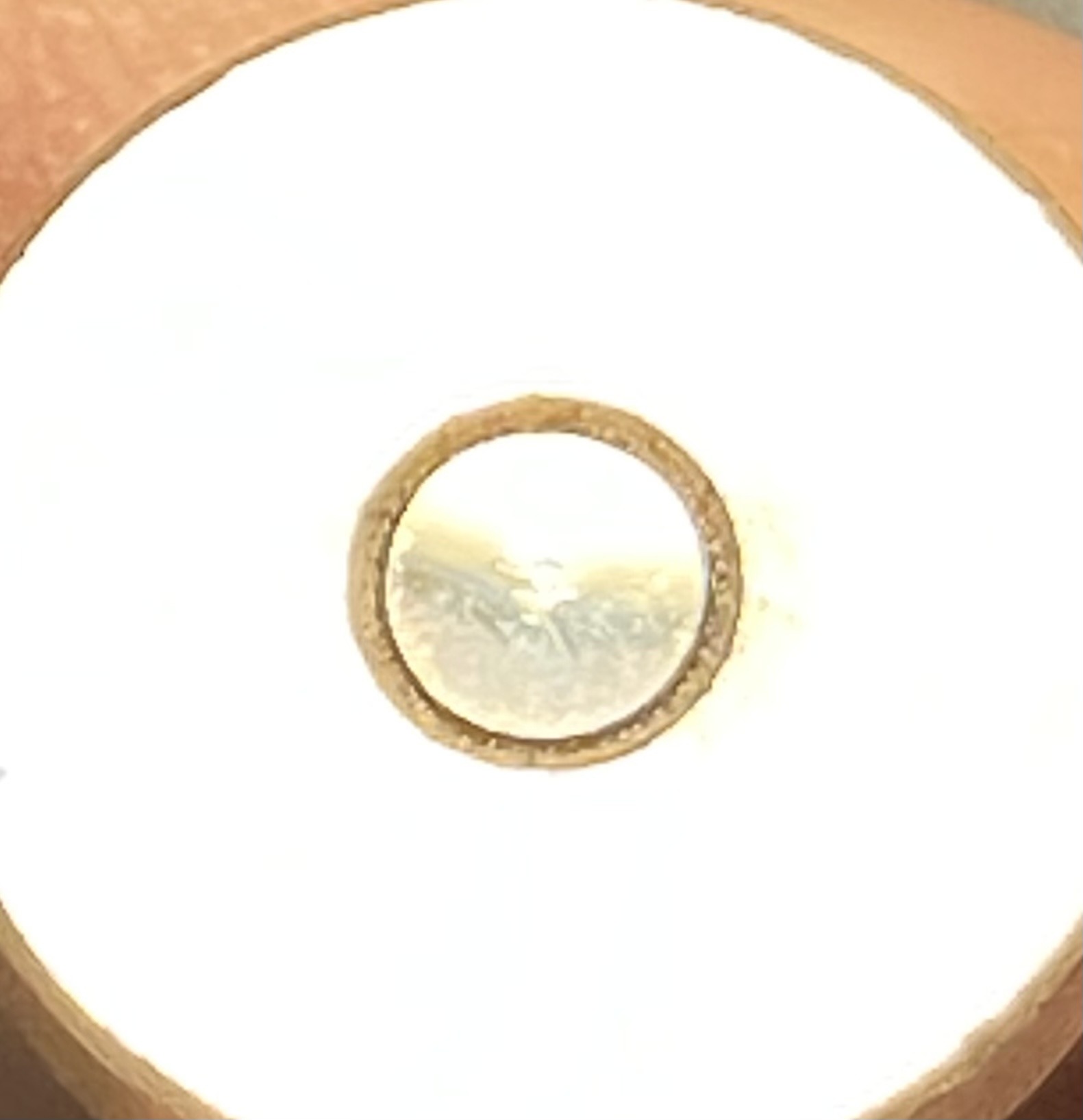

Update. I got a spare platter which I’m experimenting on. The oilite bushings are worn even worse than mine. I took it apart. There’s a thin acrylic mat with cloth layer on top; it’s glued to the rubber layer, that forms a lip (rubber layer in a platter? Strange to me, because it will isolate the top mat from the rest of the platter); it’s glued to the main platter by two rings of - ready? - double-stick tape. I was able to knock-out the spindle piece easily, you can see the sapphire piece in it. The surface had wear, the dark spots inside are cracks. Seems difficult to replace without some very special tooling. I found some more info on the oilite bushings: they can not be drilled out or otherwise “adjusted” or rimmed for the shaft; they are what they are; but they can be “re-lubed”, and should be, after every 1000 hrs of use. It’s done under vacuum, achieving nearly 100% new oil impregnation, or by boilling in oil at 100 C (90%). Both methods require removing them from the platter, that’s too much work, and would probably damage them, so new ones have to be fitted. All of this work by Sota will cost over a grand, and I can see why.
