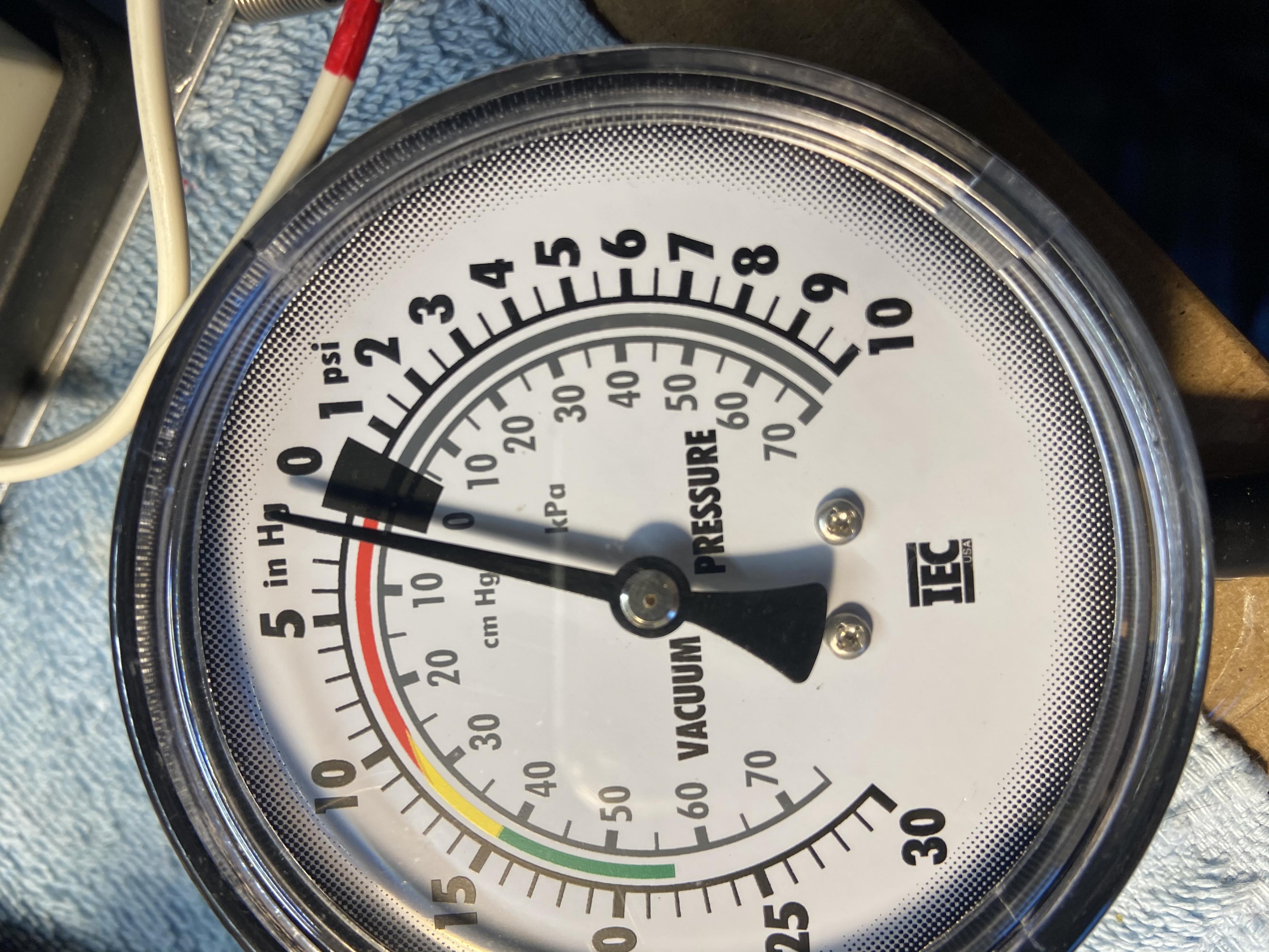

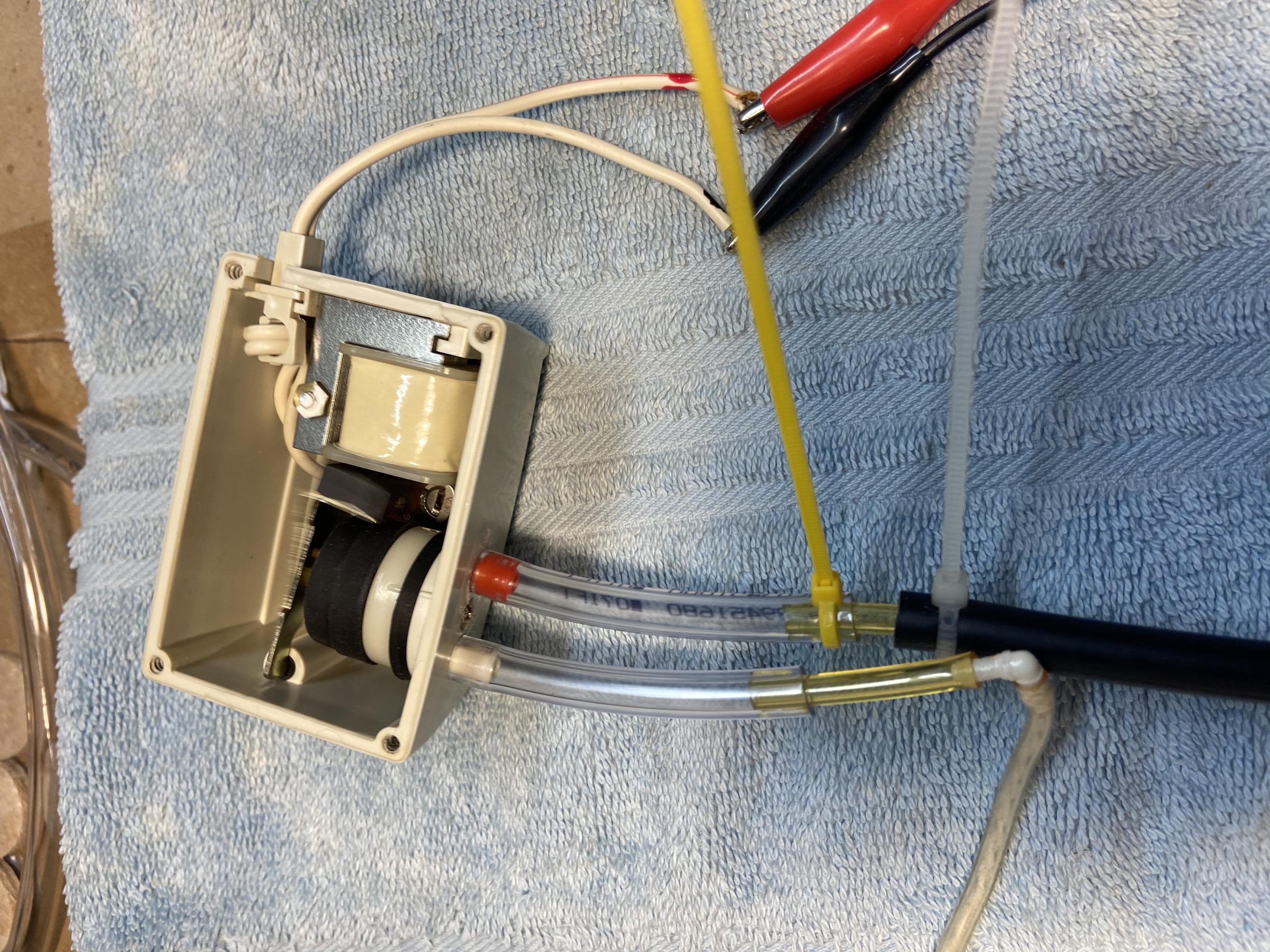

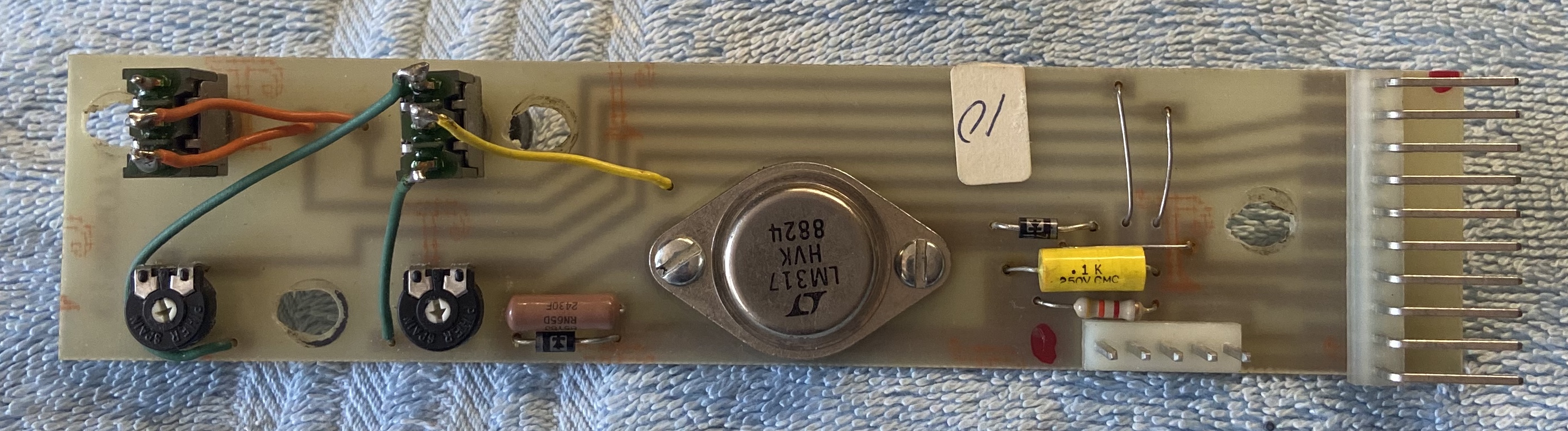

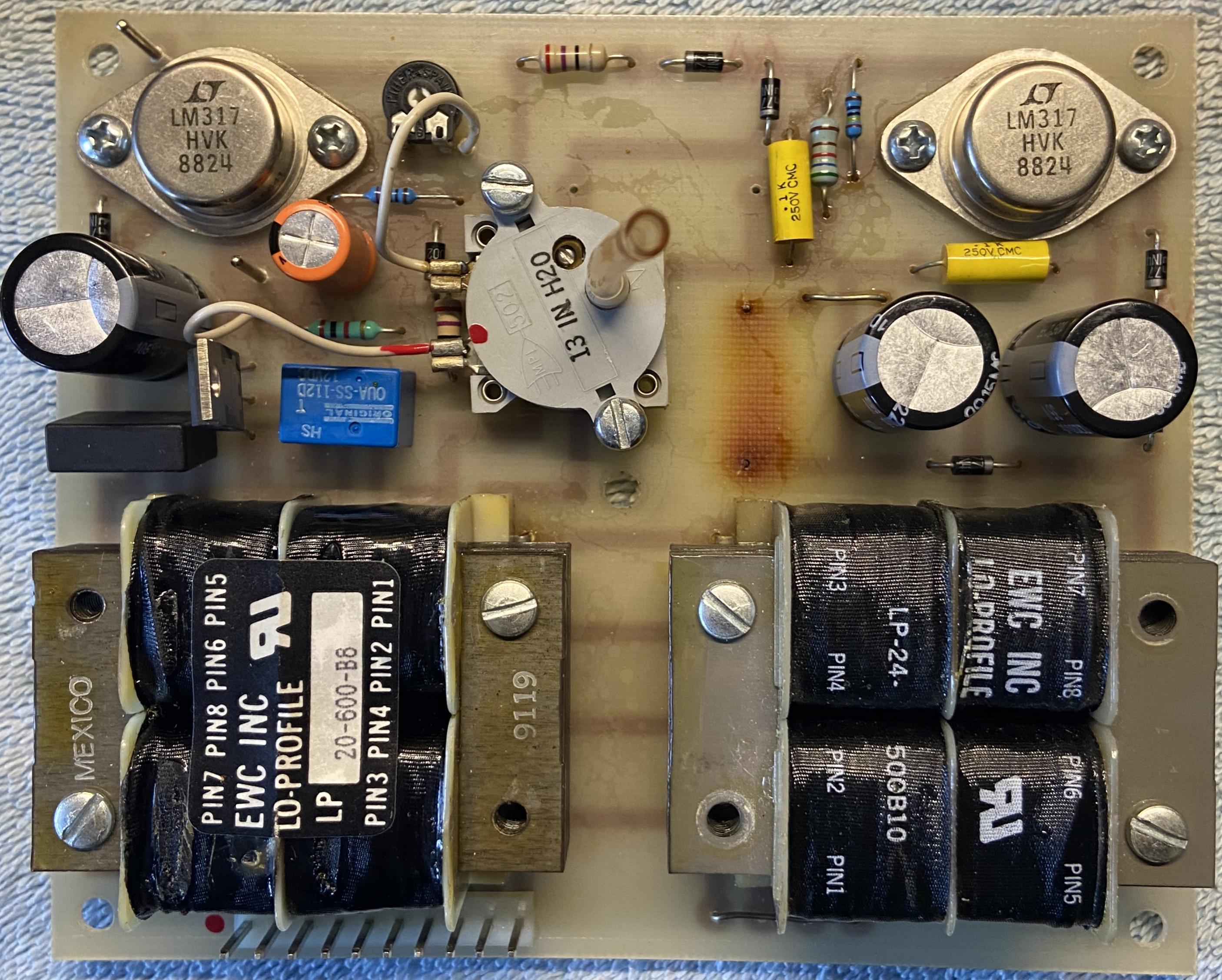

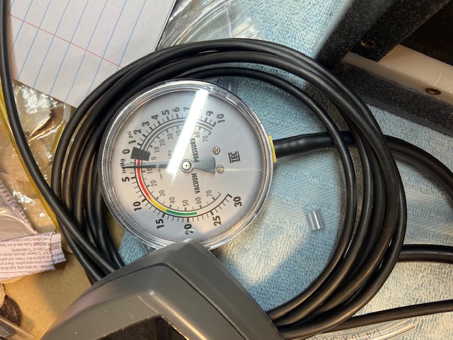

So here’s what I found: all parts on the motor board check out fine, except the two small 2.2uf caps. Values were fine, but esr was rather high at 4.5 ohms, so I replaced them. As I mentioned before, the board was modified, probably by Sota. Looks like they have moved regulation from the motor board to an outboard regulator (ML317, you can see it in a separate board in picture), there are also same regulators in PS. All parts in PS also check out fine, with the exception of a missing something, that has obviously burned-up. I wish I had a picture of another power supply of the same model. So I can see nothing wrong with electronics so far. So speed variation is something that is probably inherent to this vintage or this particular table, and should then be attributed to gremlins. Now to the pump. I don’t think it’s working right, but please correct me if Im wrong. I have removed the stupid cracked fittings and connected it with some ingenuity to an automotive vacuum gauge. At just over 12v it’s pulling only 2 in Hg. May be the gauge is not accurate, I don’t know. Even if it’s pulling 3 in, I think it’s still low. Vacuum switch on board works fine, and it’s rated at 13 in H2O, which equals roughly 1 in Hg. So may be pump should pull about 4, and then go to about 2, and if vacuum drops below 1 the switch turns it in again? I’m not sure how it works. So I think I should start by either fixing this pump, or getting another one. I wish I knew exactly how much vacuum it should pull.

Diaphram vacuum pumps are inclined to fracture be it rubber or spring type steel usually where the piston pushes up or down .
Rotary pumps vanes wear down over time , I have replaced many industrial size ones over the years and you have to watch out for cylinder scoring .
Dont buy cheap , have you looked at medical vacuum pumps , I have replaced those when working as a hospital engineer .

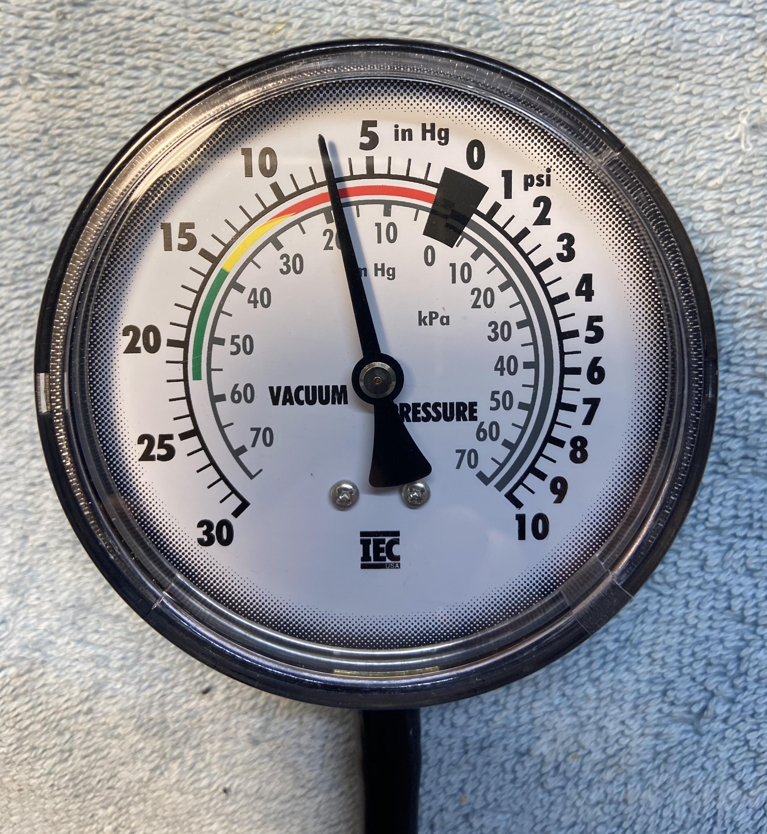

Success!!! I glued the cracks in nipples with crazy glue; used this crazy hose arrangement for now, and - 7 in of Hg vacuum with old rubber parts in pump!!! Now I only have to come up with more compact system to fit into factory enclosure. BTW, could those suspending springs be replaced by layers of sorbothane? I have to try now how this new high vacuum will affect operation of the circuit. It’s very possible now that it will operate fine.

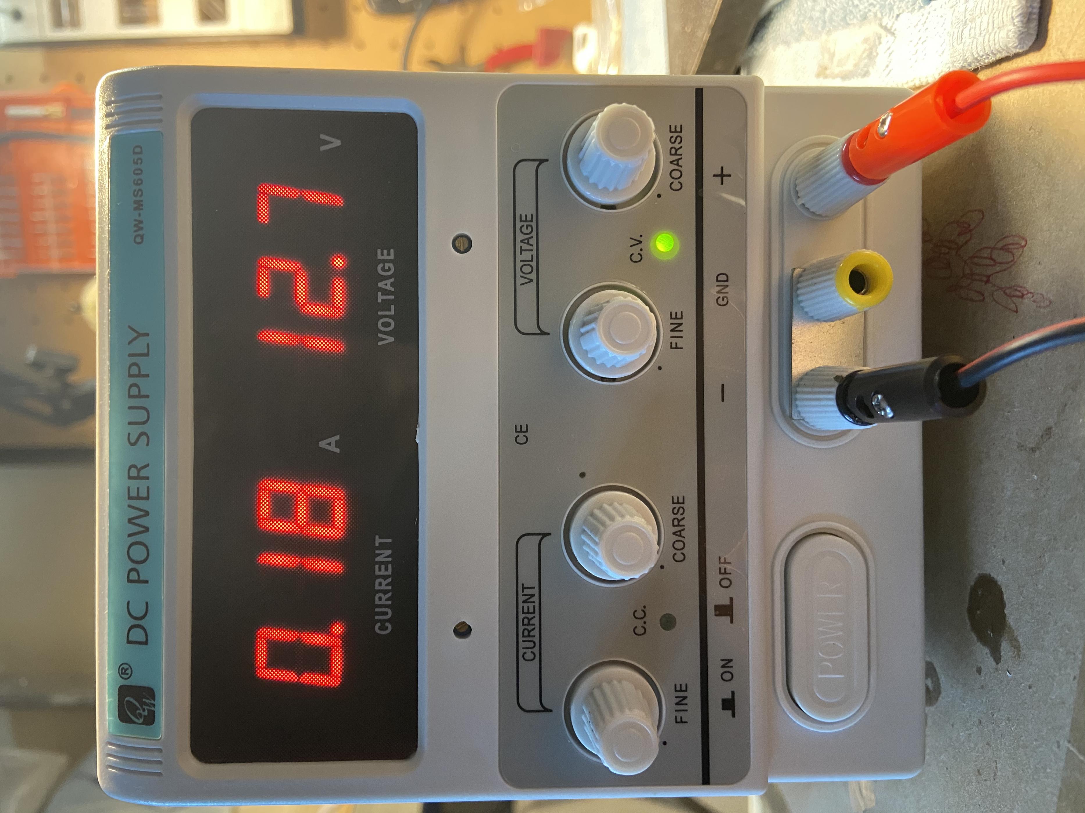

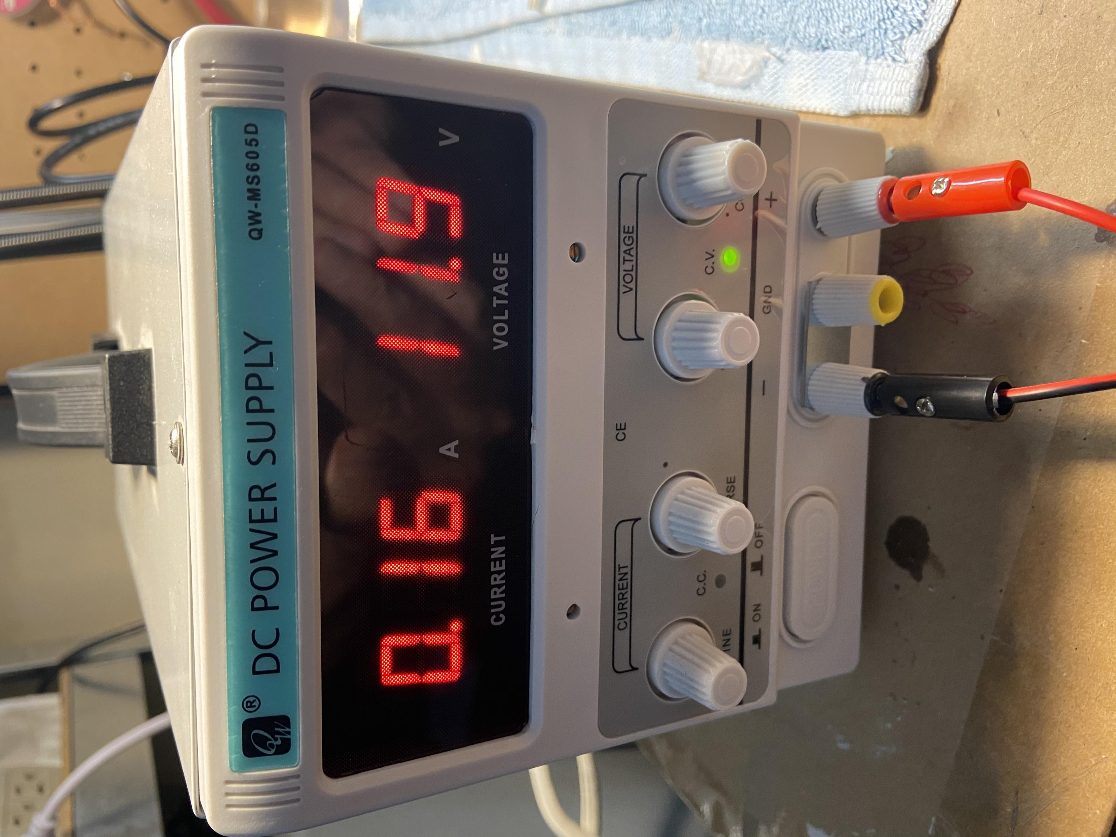

I'm happy to report that I have acheived full success with the vacuum unit. After I've fixed the connections, even with old rubber parts (which felt surprisingly good after 32 years, unless somebody replaced them recently. I bought new set on ebay just in case) everything started to work as prescribed: when you first turn-on the vacuum, it goes to just under 12v, and pumps near full volume at about 7; when vacuum is achieved (with my experiments with the vacuum gauge in a couple of seconds. With a leaking lip it will not work), voltage on pump drops to 10.2v and vacuum goes down to about 3, and pump becomes very quiet. I have replaced all electrolytic caps everywhere I could see them. There are two things I have to figure out:
1. what are the correct values for vacuum on start and "maintenance" cycle? and -
2. there is a trace of a burned resistor that is situated across both filter caps. They are 2200uF @ 35v each, wired in series. Voltage across both of them is about 39v. So this was probably a draining resistor? I don't have the diagram, so don't know it's value. My friend suggested soldering two 20K 2w resistors, one on each cap. Need an opinion of electronics gurus.

The ones I have come across to stop you getting a shock when turned off are more like 100K , very high capacitance can hold a very large amount of stored current --try shorting one out with a small narrow metal screwdriver and you take a chunk of metal out of the screwdriver.
