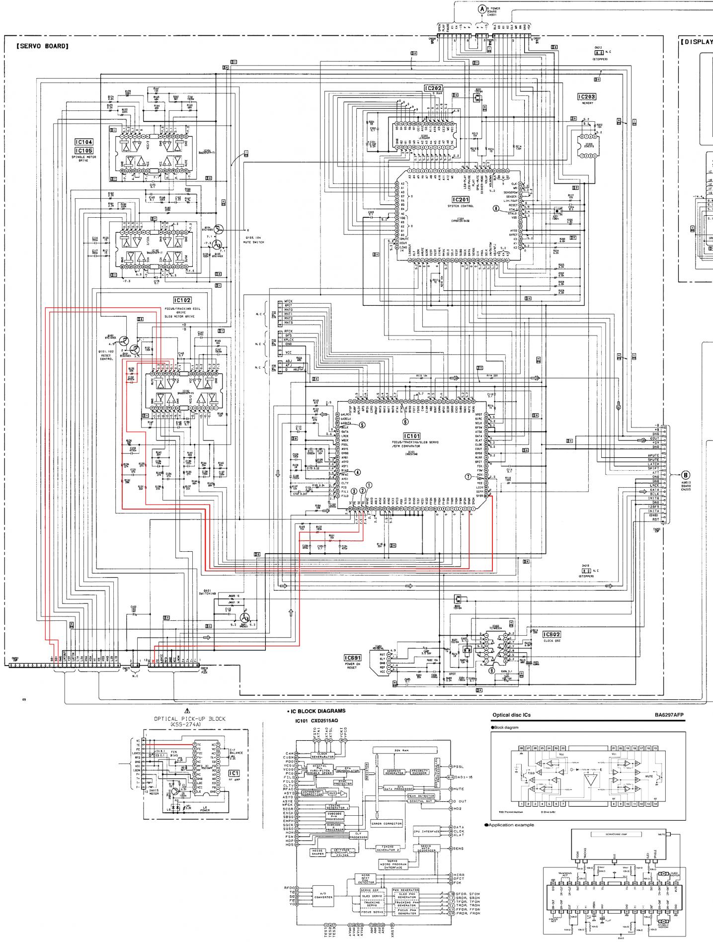

Hello PlasticIsGood,
thanks for the reply. Yes I remember those things from servicing my Nakamichi OMS-5II CD which is Sony-based. Bringing it into perfect alignment, adding a digital output and later even building in a BuffaloII DAC (The Nak now serves as player and DAC) did fill some space here
Still my technical knowledge is limited.
I do now attach the CDP-X5000 servo circuit. Direct connections between servo control CXD-2515 and servo driver IC BA6297 are marked red for convenience. Also CXD-2515 & BA6297 circuit diagrams are added in this gif as well as BA6297 application example from the manufacturer.
Maybe someone could take a look...🙂

Same as I described, except some of the processes have been incorporated into the pick-up block amp, which has provision for focus bias and tracking balance adjustment, but not focus balance or tracking offset. The other functions are incorporated into IC101, which is why it has such a long description.
If you want the change the relative gain in the drives to tracking coils and sled, then try changing the gain of one of their respective drivers, which is set by external resistors AFAICS, but I can't read the text. Or attenuate one of the driver inputs.
It's a complicated system though, so tackling one problem may cause others.
The output of each driver's first opamp is available at a pin labelled "out", for example pin 18. In the datasheet example, the error signal goes to the inverting input via 10k, and 10k is also used for feedback, giving unity gain. All the examples in the sheet are unity gain which is not very auspicious maybe. Anyway, the gain is the ratio between the two resistors, so you could increase gain to the sled, for example, by increasing the feedback resistor a little. You may be the first person in the world to try. It will be interesting.

Do I see it correctly that I should try to alter R135 in the X5000 datasheet? (Still have 2 hrs left to buy precision trimmers)
As far as I understand, R131 and R133 sum up to 66k, whereas R135 is 33k.
I am a complete layman. But this is no unity gain as being proposed in BA6297 application example by the manufacturer.
Guess this does not matter anyway, wether there is unity gain (this means 1:1 I guess) or a 2:1 ratio.
Still this gives me headroom to play a bit with feedback resistor R135/33k replacing it with a 50k cermet trimmer...
I would like to monitor the result with my scope. Guess I use R135 for that?
I also guess R136 should be not touched...?
