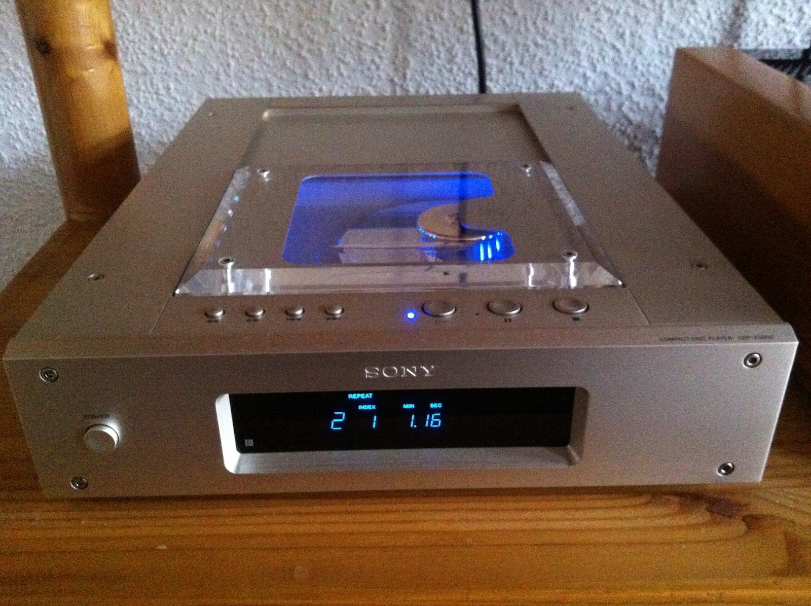

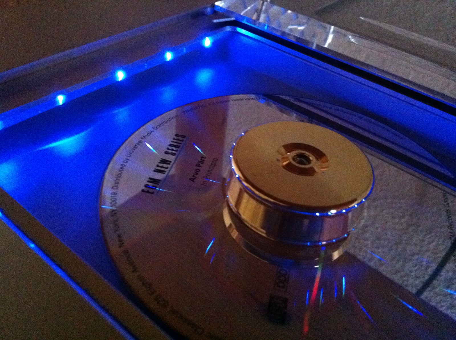

Disassembly with my unit is a little more complicated because of a mod I did in the late nineties🙂
Blue LED´s were relatively new and expensive back then. Vodooists say that blue LEDs improve sound, but it was just coincidence because white LED wre not available yet.
I am absolutely sure this mod is NOT related to the skipping problem. The LEDs run on their own power supply, can be switched off, and their ciurcuitry is completely isolated from the players circuitry,
so they do not share GND

Hey, leds are very cool.Ahahah Audio Voodooists say a lot of funny things about sound quality ecc ecc, the secret is that most of them doesn't have any technical knowledge!No,leds doesn't affect audio quality and are NOT related to skipping problem.
