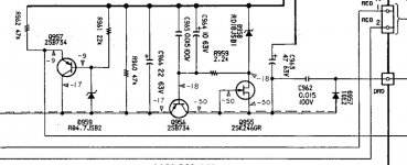

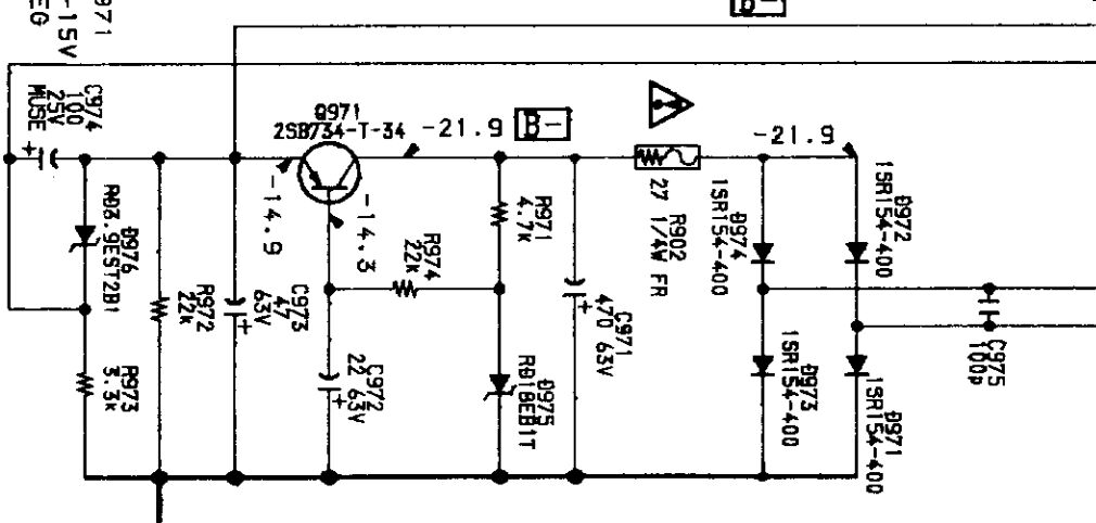

I found with my CDP XA7ES the following:
If the ripple on main cap of the display Power supply is above ~ 5Vpp the player starts to click on the analog output, without leaving a trace on the eye pattern! I attached the display power supply (VFD supply) of the cdpx5000 and CDP XA7ES. For the cdpx5000 R974 (22k) is way to high, as this resistor has to take base current of Q971 and leakage current of C972(22yF) - I tend to call this a design error, in my Sony it is 2.2K. So I recommend to put a 3.3k parallel to R974 and raise the main cap C971 to 680yF. Moreover this cap and the rectifier diodes have a strong impact on sound, so best take a silmic. I would replace the rectifier diodes D971-974 to 1A/100V Schottky diodes - smoother sound for some cents..
Do not ask me why Display current leads to clicking - I do not know, but checked it several times...hope this helps, philipp

sound will improve considerably with schotky diodes and good cap - the 22k will lead to an unstable regulator - it is intended to low pass filter the zener noise but e.g leakage of the 22yF cap will change with aging and : temperature! - so reference voltage for the regulator will change accordingly..
Hello Salar, do not give up...
Given the small money necessary I would change the remaining three caps in the VFD PSU (C972/C973/C974) and keep the values as in the circuit diagramm..take a look at the voltages with an oscilloscope and watch out for high ripple..for testing purpose I would shorten the fuese resistor R902..voltage drop across R974 should be less than 0.2V..
good luck...Philipp
