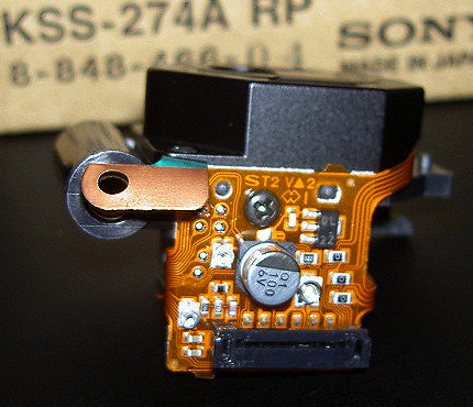

Hello Invisible Force (may it be with you)
I will look at the connector. Where do I shorten the laser pickup to prevent electrostatic breakdown?
There is no +/-7Volts circiutry as far as I can see.

I really don´t know. You have to follow the track on the Kapton flex cable to find out.

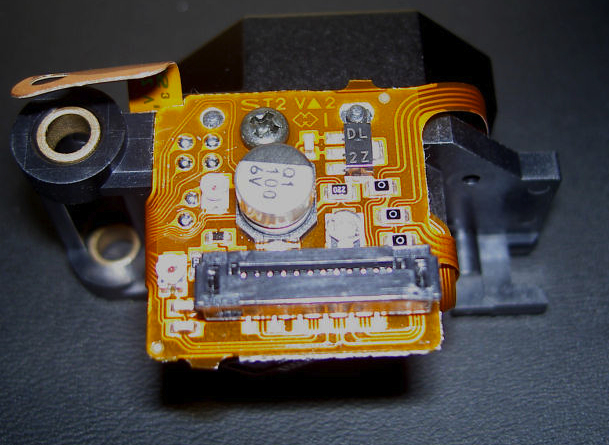

Thanks Dacen. I have one spare KSS-274A but I wanted to ask instead of unpacking the spare and checking myself.
Well, I looked at the spare laser some minutes ago - no shorted pins at all (!) to prevent the diode from electrostatic breakdown. Loks like on the photo posted above.
Only the usual advice to work on a grounded workplace and bench.
From my other players (Toshiba XR-Z70 - OPH-32 and Nakamichi OMS-5EII - KSS-123A) I know that shorting the laser diode to ground with a blob of solder at dedicated lands was usual.
I do not think that diodes almost 8 years later were less prone to electrostatic breakdown? Seems to me more of a sign of the decline of Sony: Instead of adding a blob/bridge which might cost time (and probably has to be done by hand) they simply left it to the gods of electricity. Imagine how many service technicians wrecked the KSS-274A wearing wool jackets and synthetics, not being aware that they already had to be
grounded while unpacking the freshly arrived spare laser.
I guess, i will be on the safe side, when shorting pins 23+24 together with pins 1+2 of the RF-Amp M52104FP before disconnecting...?
I want to do this to remove the laser, so I can resolder everything on the servo board faster and easier.

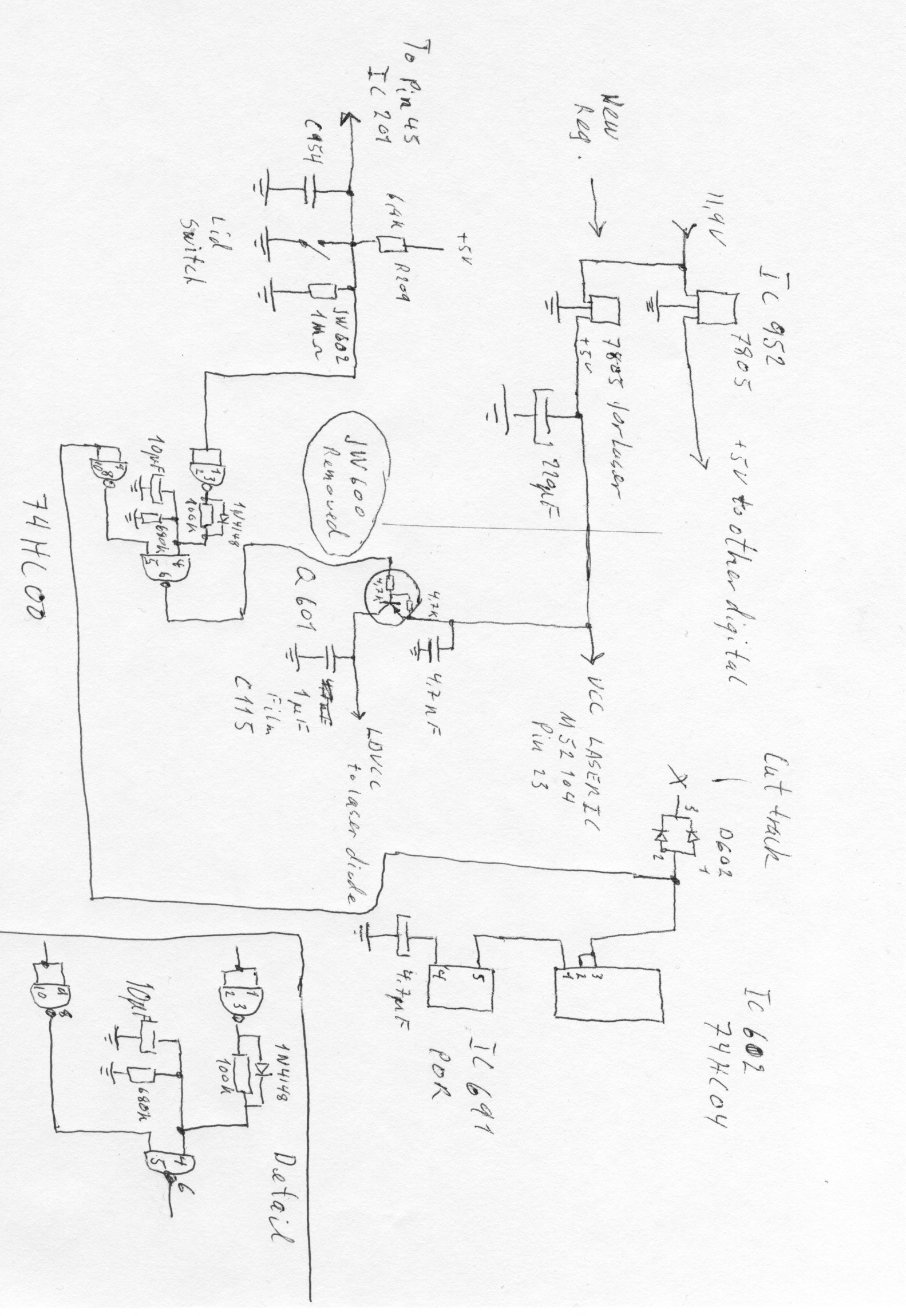

Here is all the modifications I have done so far. Works perfectly so far. The 1n4148 and 10uF capacitor plus resistors is a delay circuit when the lid switch is opened. If this delay is not present the spindle motor does not stop spinning when lid is opened while playing. In other Sony players with fixed pickup and a conventional drawer this function (cut power to the laser) is handled by a mechanical switch and not a transistor. This is only a double security to prevent hazardous radiation from the laser to the eyes. I will certainly have a go at the zener biasing. It is very easy to do the test and the zener is only burning 13 mW with the 3.3 Kohm so no harm can be done with lowering to say around 800 ohm. Will report in a while.

How is pin 45 (lid switch) of system control IC cxp84124 related to pin 17? (spindle motor mute). Could Q104/105 cause the glitches?
In the datashheet of the Mitsubishi voltage regulators M5F78M07 and M5F79M07, 0,1µF are recommended at the voltage in/outs. Sony did "only" use 2200µF caps at the regulators outputs. Did add 0,1µF,
but no difference.
but no difference.
Page 18 in the schematics (spindle mute). I had to delay the lid switch in the nand gate just to give the spindle time to stop. There is a kind of brake function taking place when you open the lid. How that is done I don´t know. Maybe just reversing the polarity for a short while. If the laser is shut down immediately the spindle continues to spin slower and slower until it stops by itself, that is no braking function taking place.
