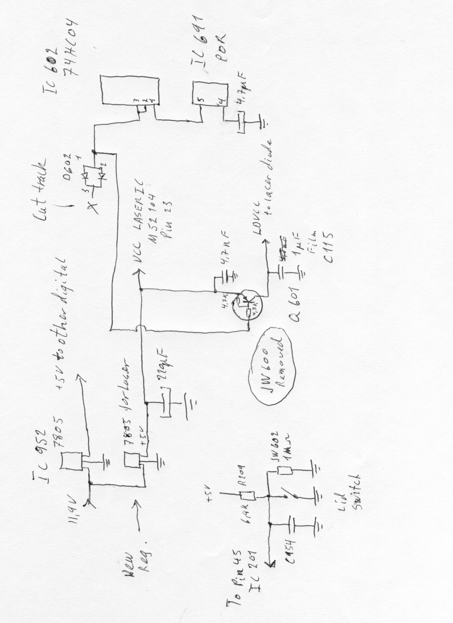

Here is what I have modified so far. It remains to see how efficient this is. The transistor Q 601 has built in bias resistors, 4,7 kohm each. I have cut the track from D602 and taking the laser disable signal directly from pin 2,3 IC 602. This signal goes low after POR. I have removed JW600. Could not see the need for this one. I have taken JW602 and put it to ground instead of the input to Q601. I could not see the need for this connection. The lid switch is now on its own. And the laser has now got its own regulator. Hope is high again !! We will see.
Great! We will see! Still no skipping when being cold and still being fed by external clock?
All the best, Salar
All the best, Salar
Yes, still fed by ext. clock. I have had no skipping when cold but I have had problems with the start up of the player when cold. That is why I thought that your problem and mine might have one common solution.
