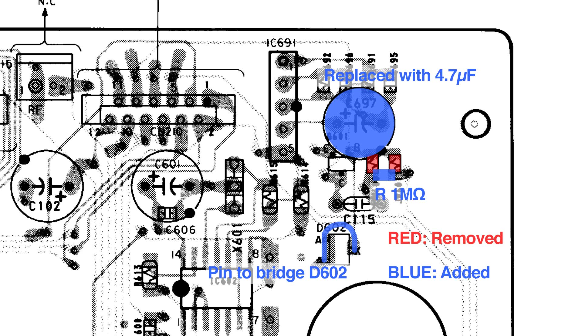

" What about soldering on connections leading to the laser diode? " I would not recommend that. I did a lot of changes to the board as I had the player apart. It might not be necessary with all of those changes. Try the simplest first. Solder a strap across D602 and connection directly to pin 2,3 IC602 is in place. Remove JW600 and connect JW602 to ground. This might do the trick for you. I have had no problems so far. The player starts every time when cold and plays music flawlessly. As you can see on my drawing I have also increased Power On Reset slightly. I have increased C697 from 3.3uF to 4.7uF just in case.
My fault, of course it is W601. You are interested in getting a solid low signal on base of Q601. If you leave D602 in circuit the base of Q601 can take any value higher than that, so yes, bypass. If this is successful for both of us I have a permanent solution for this function. That is adding a NAND gate there. What we are doing now is trying to locate the problem and verify it. (if you don´t have a NAND gate I will send you one ,74HC00)

the night before), but it does not show any effect. Still having slight glitches like before, disappearung when the X5000 warms up. I am not sure if I used a proper path for JW601 but turning it 90 degrees counterclockwise and soldering to where ground connection of JW600 was should be corretct?
Added a jpeg showing the mod.
And why did Sony add D602?

Yes what you have done is correct. D602 is to introduce a logic high to shut down the laser during power up. That is the small time space before LDON pin 62 IC201 has control of the laser. This is just a double security to give the +5volt and the logic time to stabilize.
Well, you have to take it one step further. Do you have a spare reg. 7805 ? If you don´t send me a PM with your address and I will send you the 74HC00 and the 7805.
Leave it bypassed. No heat is generated in D602. Put in the separate voltage regulator 7805 as referred to in my drawing. Cut the track feeding the emitter of Q601 and connect the new +5volt to it. Cut the track at connector CN210 removing the old 5volt, the 12 pin connector going to the laser, pin7 VCC and connect the new 5volt to this pin. As you can see the numbering on this cable is opposite in each end, so be aware that you are on the right pin. I can only contribute to a problem that I believe might be related to my problem. If you after this still have a skipping problem it must be related to something else. These modifications you are doing are an improvement anyway. A drawing with the 74HC00 in circuit will follow in a while.
What we achieve here is a voltage to the laser with much less digital noise as none of the other circuits are connected to this one.
