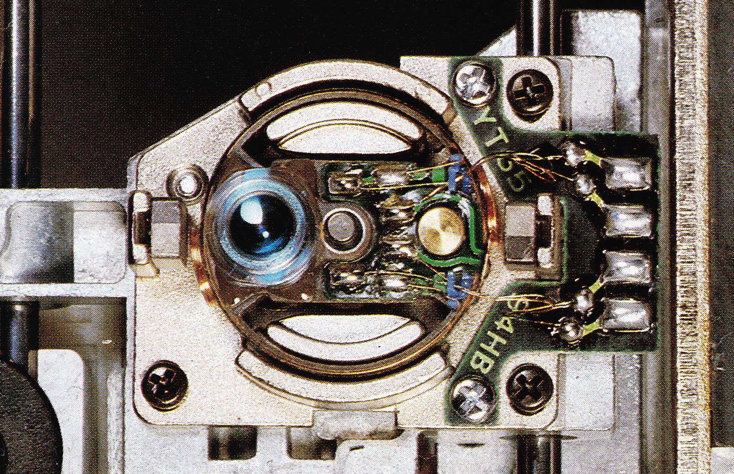

Dear Gajanan, show me what you mean with "arc", I´d loved to be teached 🙂

Like this...four pole pieces, inner pair with vertical coils for focus, outer pair with four horizontal coils for fine tracking. Black bits, coils and laser move in relation to silver and gold-coloured bits. Between the two, the white lump of plastic is a parallelogram pivot/spring for vertical movement, and a lightly sprung pair of pivots for the lateral. It's not ovbious how the tracking movement is held to a parallelogram, but I guess there must be a guide pin somewhere.
Strictly speaking, although the driving force is linear, movemement is in arcs. Note the Toshiba in my Avatar is lighter, cheaper, and much more elegant, with a much better two-axis plastic spring.
Pic is of KSS190A, but I think other Sonys are similar.

I've had one case (KSS210) where the centre bearing was "sticky". If that is a problem then its difficult to correct because the lens suspension is a synthetic neoprene type contraption and is easily damaged if you try and detach it from under the lens in order to lift it clear. I suppose you could try "washing" it through with single drops of ISO on the centre shaft.
Unless that is the problem it would be easy to make things worse.
