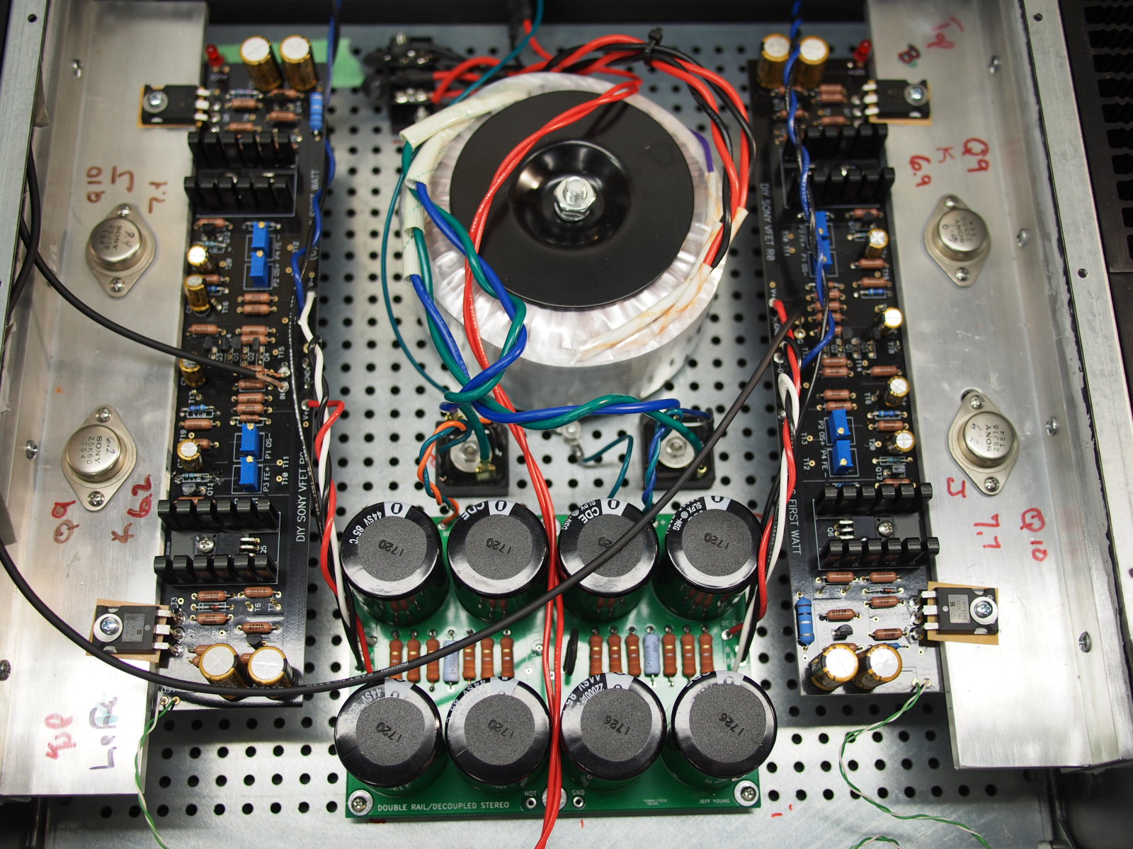

Attached are a couple photos and the printout of QA401 output. Looks like about 11 or 12 watts is the useable output. I was surprised at the amount of 3rd harmonics.
This is cased in a 3U by 400mm case and hardly even gets warm. I could have used a 2U by 400 dissipante and been fine. I guess the big factor is the single die VFETs instead of the normal ones. The 'T' brackets were no longer available so I had to make my own. Probably overkill also.
I couldn't have finished this without help from Zen Mod and Dennis Hui. Thank you. And thanks to Nelson Pass for the design.
The proof is in the pudding and tomorrow it will get installed into my system.
Hi hirscwi,
Nice work, I always enjoy seeing an amplifier with all its wires twisted.
The distortion is H3 dominant because the amplifier is push-pull, as the even order harmonics tend to cancel each other. But that shouldn't prevent you from enjoying the sound.🙂

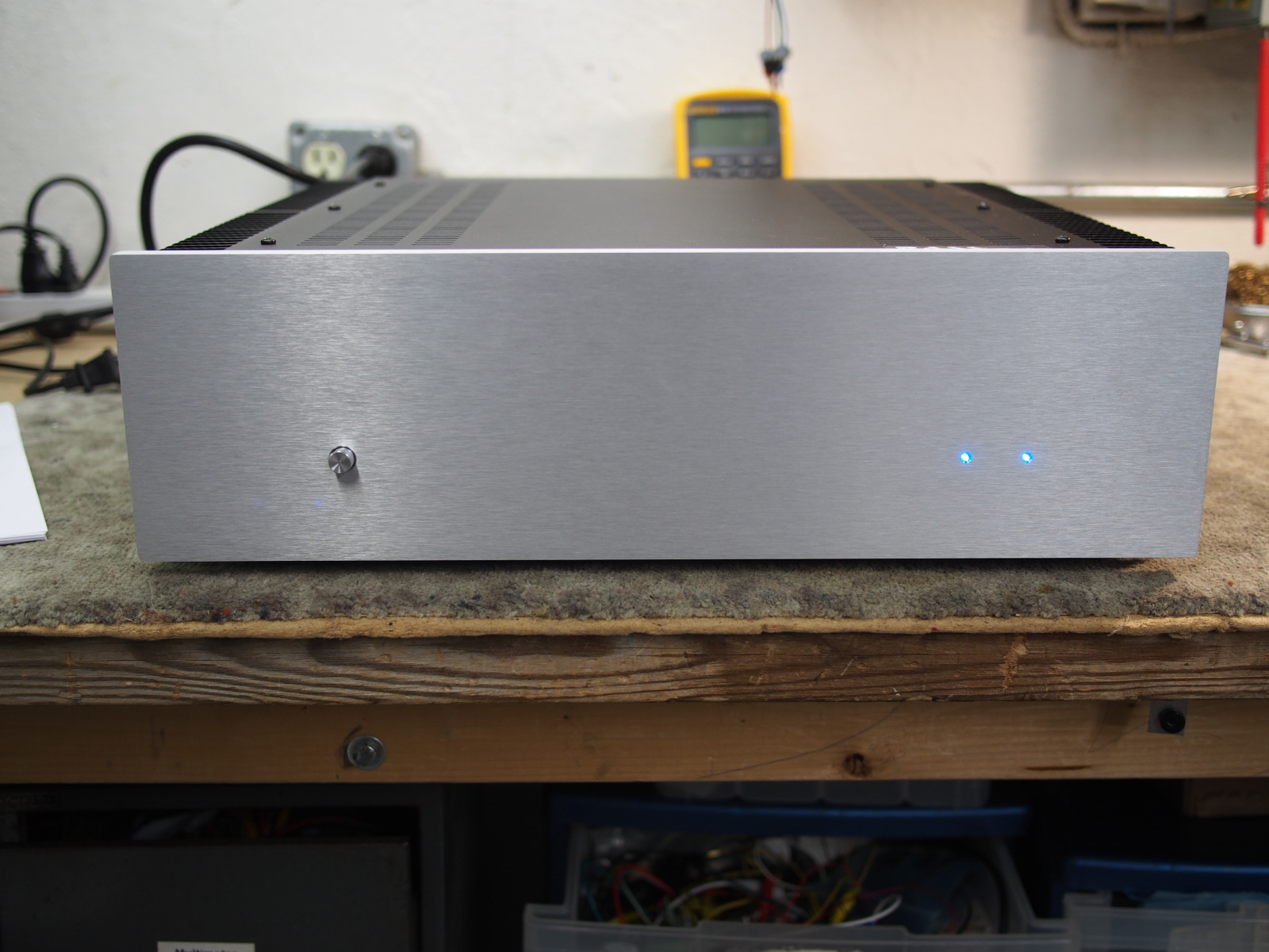

I've had some listening time with this amp. UGS preamp and Tekton Design Lore S speakers. It sounds really nice (I guess that's no surprise).
It's cased in a 3U 400mmD dissipante case and it doesn't even feel warm to the touch. I wonder if I should bump up the bias? I am using the baby VFETs (k60/J18) and biased at half the normal amount.
Probably I should just not worry about it. Maybe put it into a smaller case at some point (seems like a lot of effort, tho).

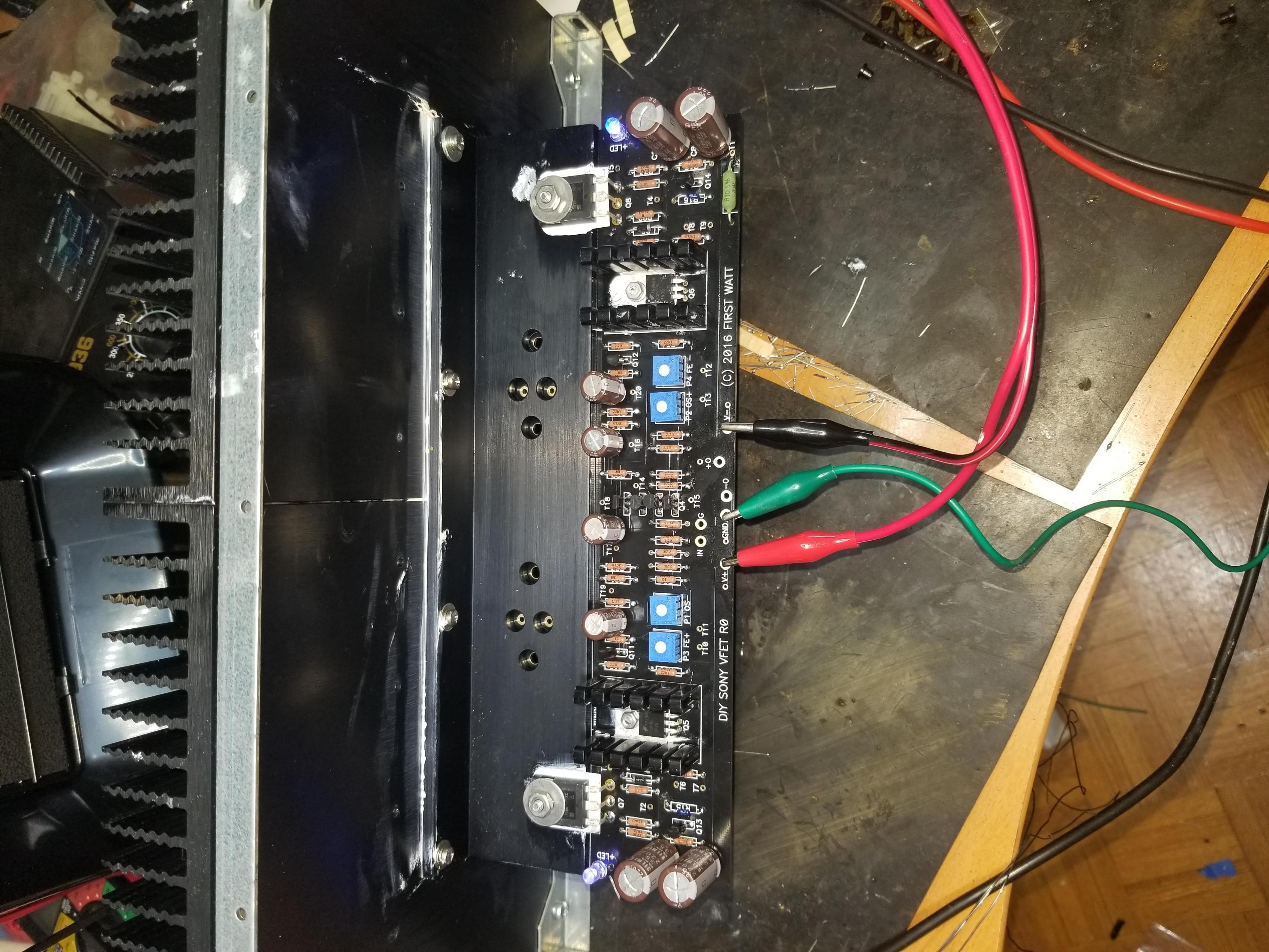

Gentlemen,
I am using bipolar bench supply at 28v.
While applying power to the front end, I observed the following test results:
G-T6,T8..13.8V instead of +28v
G-T4,T2..-13.8V instead of -28v
G-T14,15...5.9V istead of +-13v
All other measurements are within specs.
Need your help to find out what did i did wrong.
Any suggestion how to proceed is welcome

I'm guessing you only have +/-14VDC there. Please check by just measuring
the DC voltage between the + and - terminals.
The kit arrived with fqp3n30/3qp3p20 mosfets for Q5/Q6.
Do i have to change p3 and p4 to 1k.....and r34 and r35 to 500 ohms
