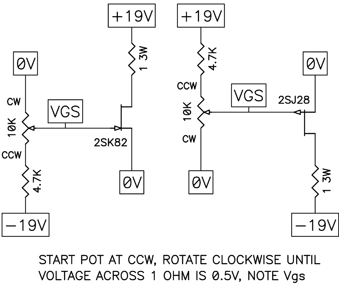

I'm using 2SK60 and 2SJ18 VFETs because I couldn't find the correct ones. From my reading it appears these should work, however they need half the bias. I measured the Vgs using the following circuit from Mr. Pass, but measured Vgs with the voltage across the 1ohm resistor set to .25V instead of .5 shown in the diagram. Using that procedure I have Vgs of:
J18 - 7.4 and 7.7
K60 - 6.2 and 6.9
Before installing VFETs, I will set the bias using these numbers according to the procedure in the original document prior to installing the VFETs.
After installing the VFETs, I set the voltage across R32 to be 50mV instead of 100mV for the original VFETs.
Am I correct in using half the drop when measuring the Vgs and half the voltage across R32? I've read this recommendation in the thread a couple time but want to be sure I don't destroy these scarce VFETs.
J18 - 7.4 and 7.7
K60 - 6.2 and 6.9
Thanks for the continued assistance.
