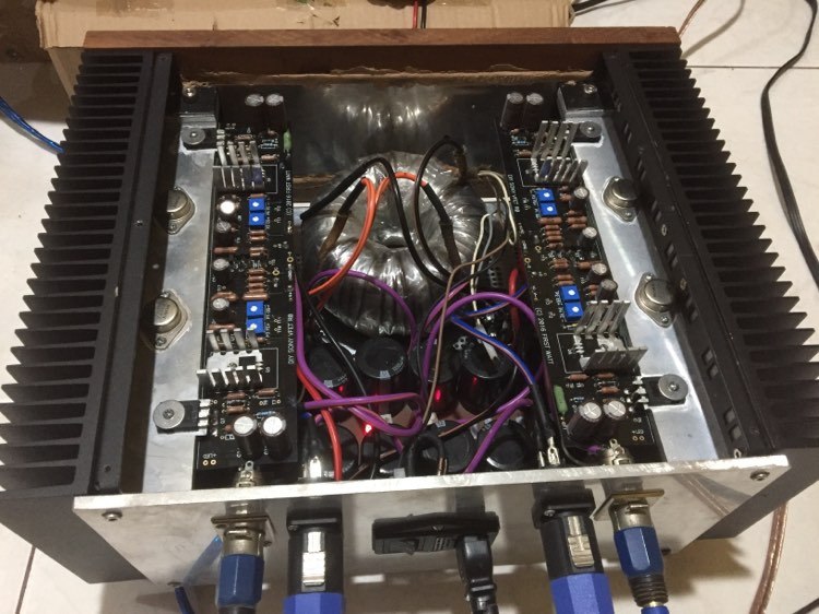

After few years in my drawer, I finally found time to finish the Sony VFET amp.
Great soundstage, very good in all areas from high, mid and tight bass.
Other than the M2, this is my new favorite, followed by the F4.
The test procedure provided by Nelson was very easy to follow.
Even with single multimeter, all went well.
Thanks a lot to Nelson's generosity.

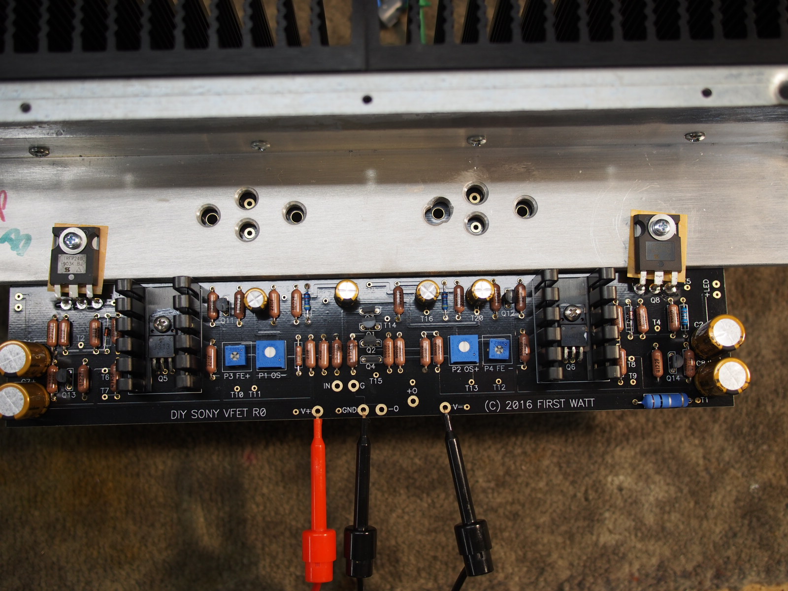

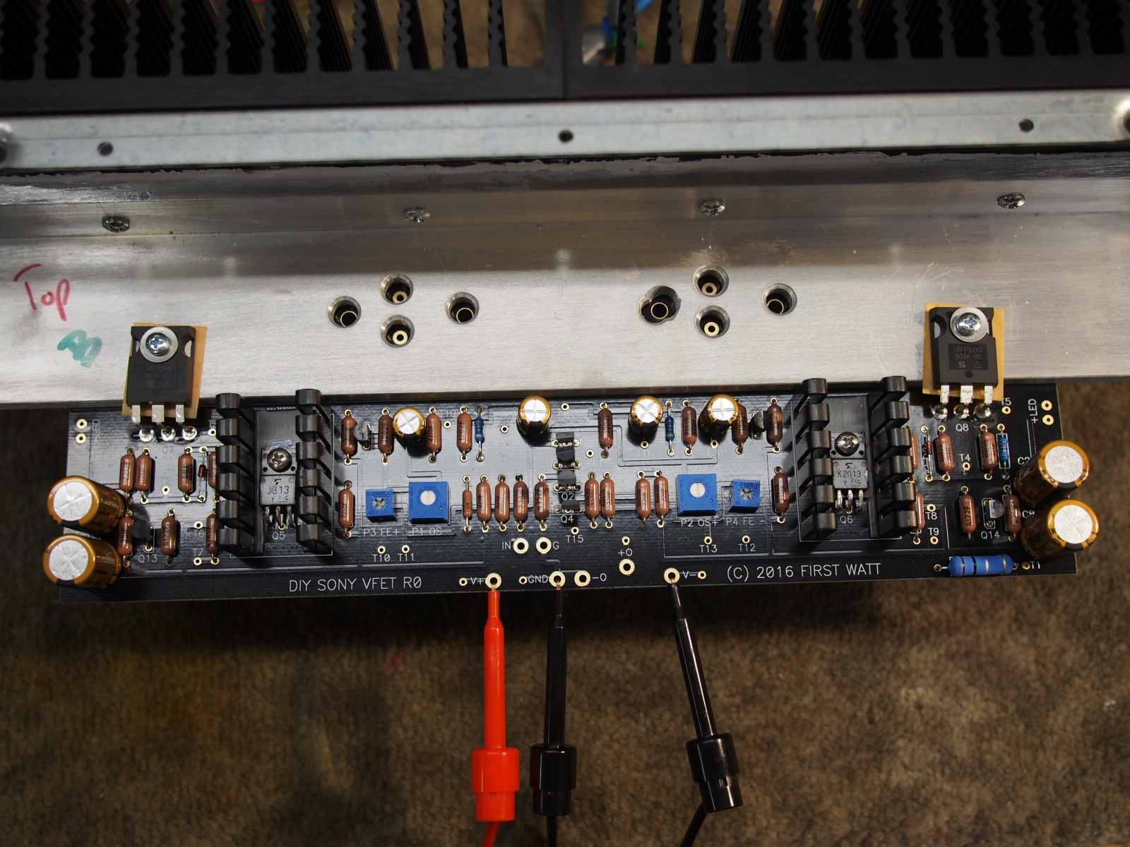

Greetings to all in the new year.
I'm trying to finish the Sony VFET I started over the summer. I have assembled and tested the resistances and all are OK. But am having a problem with a couple voltages.
At this point, everything is installed except the VFETs.
I am using LSK170 and LSJ74 - both grade C. They were not matched. The K170 were about 11mA Idss and the J74 >12mA (according to DCA75). I have K2013 and J313 for Q6 and Q5.
All voltages test fine except the following:
Left Channel:
T6-T7 = 8.7
T8-T9 = 8.7
T6-T11 = 11.3
T8-T13 = 11.3
T18-Gnd = 9
Right Channel:
T6-T7 = 8.2
T8-T9 = 8.2
T6-T11 = 10.7
T8-T13 = 11.2
T28-Gnd = -16
Also - only right channel - T4-Gnd = -2.7
P3 and P4 are set fully CCW - turning them only makes it worse.
I'm assuming this is caused by JFETs with too high Idss but I don't know what I should do about this. I do have other JFETS and can probably find a matched set.
All ideas appreciated.

You have a lot of current running through Q5 and Q6, likely caused by the Idss of
the jfets and R34/R35 values.
Please confirm the part values you have for R34, R35, P3 and P4.
I expect you will need to reduce R34 and R35, perhaps to 100 ohm.
The T18-Gnd values just represent the current imbalance between Q5 and Q6 for don't
worry about that for now.

Thanks, Dennis.
R34 and R35 are both the stock value - 221 ohm
P3 and P4 are also stock 500 ohm
I do have some JFETs with lower Idss. Is that the next step or can I resolve with different R34/35 and P3/4 values?
Also do I need to worry about T4 - Gnd = -2.7V at this point?
Cheers.
