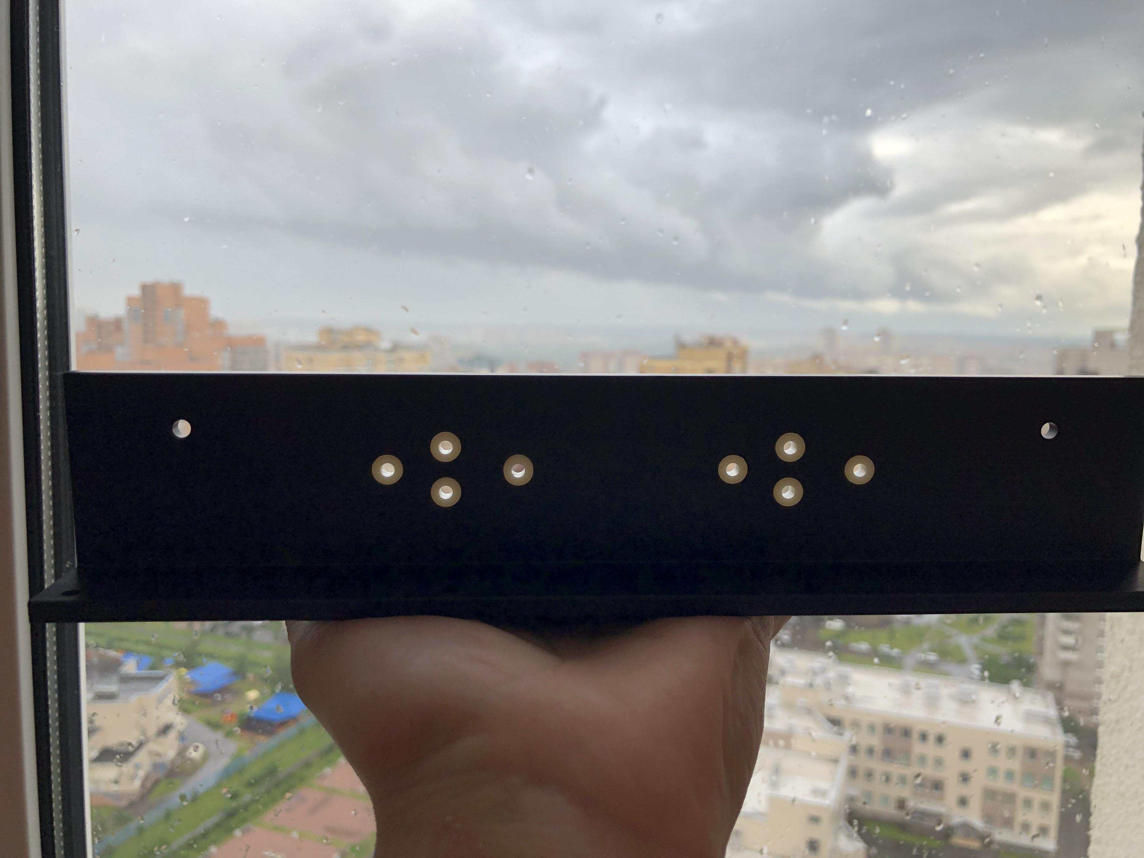

I bought this nylon insulators:
50pcs M3 M4 M5 M6 M8 White Nylon ABS Non Threaded Spacer Round Hollow Standoff Washer ID 3mm4mm 5mm 6mm 8mm PCB Board Screw Bolt|screw bolt|8mm boltbolt 8mm - AliExpress
Go for (M3 ID 3mm) + (5mm)
Good for M3 bolts/screws.
I also bought M4+5mm from this seller. And they appear a bit wider than 7mm and did not fit.. ) so don't buy them.

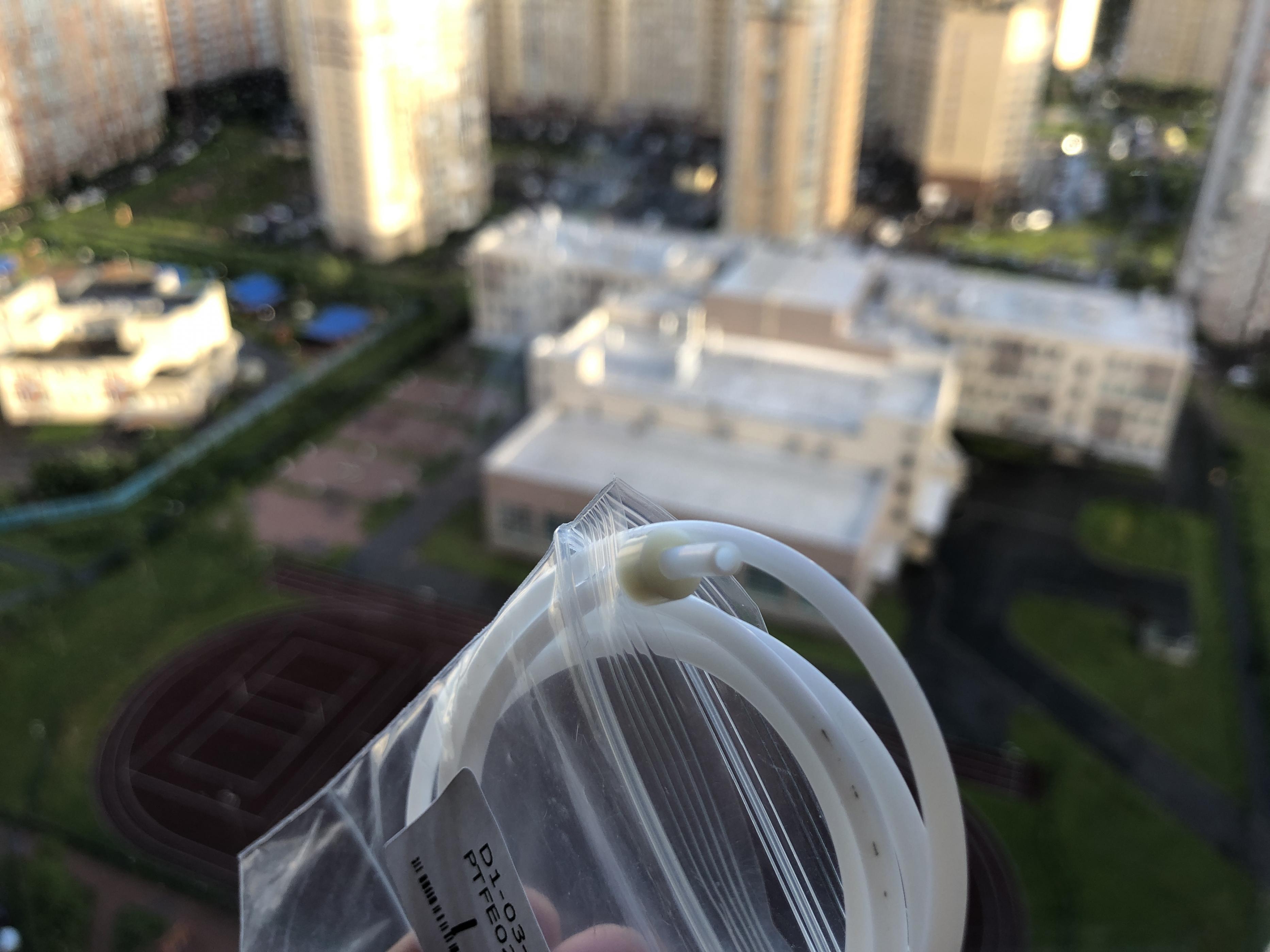

Perhaps some insulating tubing for the pins? You would
want something that can take a bit of heat from soldering the pins.
Nylon probably could melt if VFET pins touch it when solder.
I also bought PTFE tube I can cut.
1Meter 1mm 2mm 3mm 4mm 6mm 8mm PTFE Tube For 3D Printer Parts Pipe Bowden J head|for 3d printer|teflon tube 4mmteflon tube 6mm - AliExpress
Go for (ID2mm OD3mm) + only color is White.
