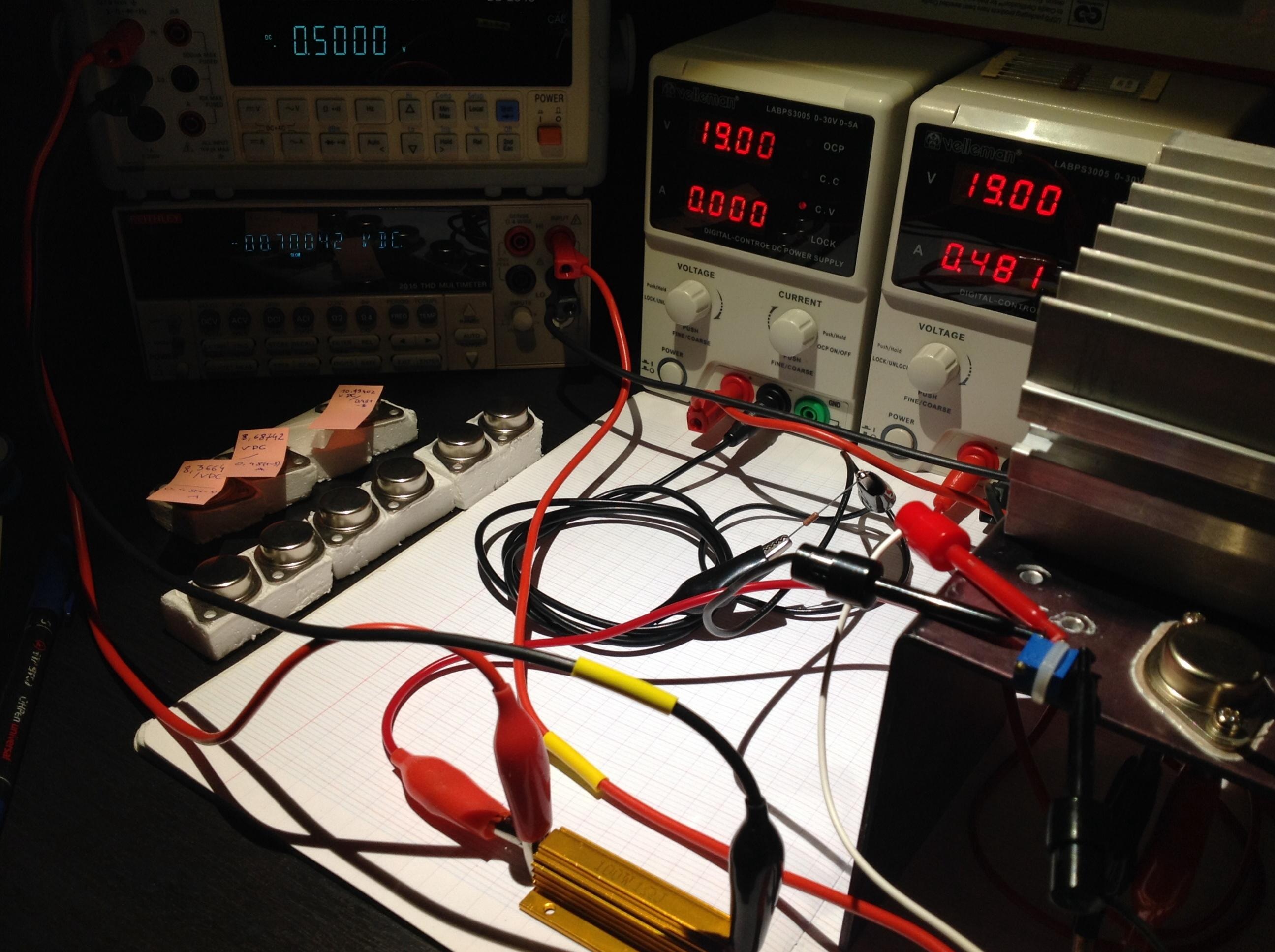

You can use two 19 Volts laptop psu's connected together for bipolar
(-) (0 Volts, center tap ) and (+).
Two bench lab psu's ( current limited 1A max ) are always great tools.
My setup on the pictures 🙂

@soundhappy, I love your picture... it's worth 1000 words.
