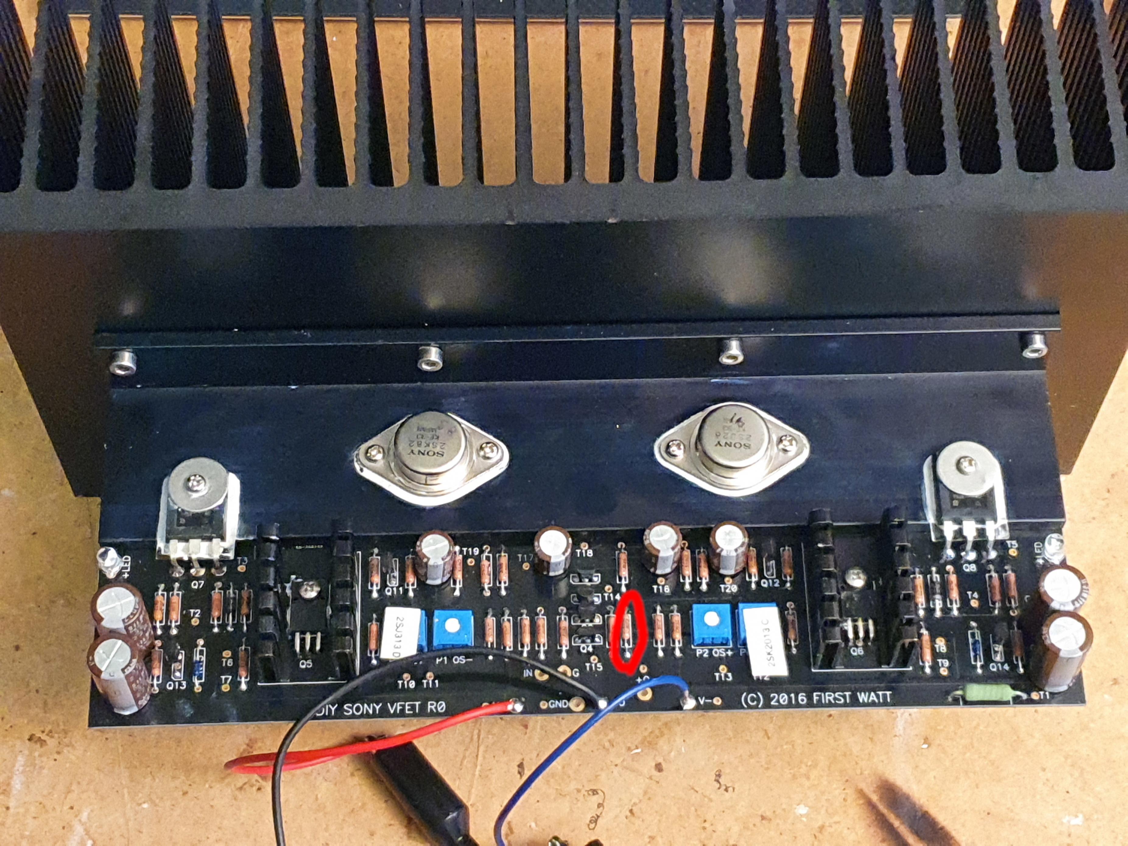

The first channel is up and running! No real issues so far. The only hickup was that I messed up the front-end adjustement when I tried to adjust the output stage because I mixed up the pots.
Note to myself (I am sure I'll mess up again with the second channel): to fix this, I lifted R3 to break the feedback loop (red resistor in attached photo). Since the scope was already up and running, I adjusted the front end (P3, P4) for symmetrical clipping at test point T18 instead of tweaking T18 to 0 V. Then I put some stickers over P3 and P4 to make it harder to mess them up again, and reconnected R3. Then adjust output stage again using P1 and P2.
I will slow down a lot, as I'll have to wait for the PSU parts. And I need to figure out how to build a chassis around these heatsinks. I am pretty sure you'll have yours finished first.
