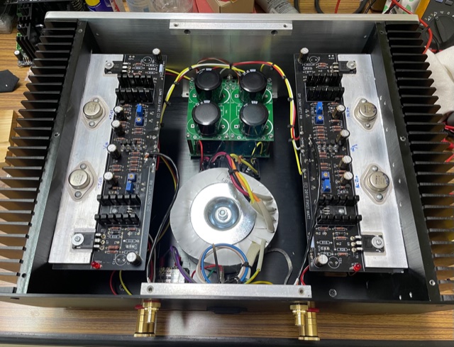

Hi All.
I have a DIY Aleph J project that has very large heat sinks that will accommodate both the Aleph J PCBs and the Sony Vfet PCBs attached to their L brackets.
I would like to install both amps into the same chassis, and have a switch so that I can use one or the other. This entails sharing a power supply that has a common Antek AN-5218 18V-18V 500 VA transformer.
I did this with an F5 and M2x. It worked very well. I used a bi-color LED on the front panel to indicate which amp was in use, and a 4 pole switch on the back to change power and output connections.

I posted to ask what the impact of using a lower than normal supply voltage would be. That’s why I posted. ZM kindly answered the question. If anyone else who is operating their Vfet amp at lower voltages has observations, I would love to hear them. Buying a completely different power transformer with multiple taps, using a separate power transformer for each circuit, and building two completely separate amps, are all obvious ways to getting the right voltage to the Vfet amp, but I didn’t ask about that. I asked what would happen to output power and sound quality if I used the same 18V-18V power transformer, which I already own, for both circuits. That is what I asked in my original post in this thread and why I posted.
grendel23: This is what I would like to do, but the Vfet amp normally uses a 22V-22V transformer instead of the 18V-18V used by most of the Pass DIY amps. I have lots of room on the heatsinks, so I will probably place the Aleph J boards in a way that will allow me to also install another Pass amp into the chassis. I just need to figure out which one. I don’t want to hobble the Vfet amp, so I will probably build it in its own chassis in the future.

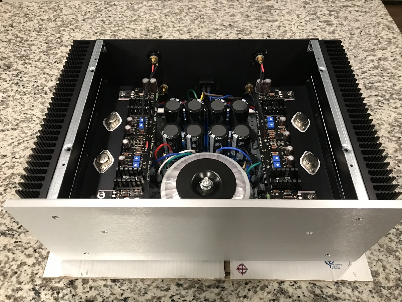

Sony VFET amp
First amp I have the complete built in years. Thanks to WFH. 😛
I want to express my full gratitude to Nelson Pass for his generosity and constant contributions to the diyaudio community. Thanks for this special gift.
The amp very well behaves. There’s very little dc drift. The bias stays constant. And it sounds really great. This amp is special.

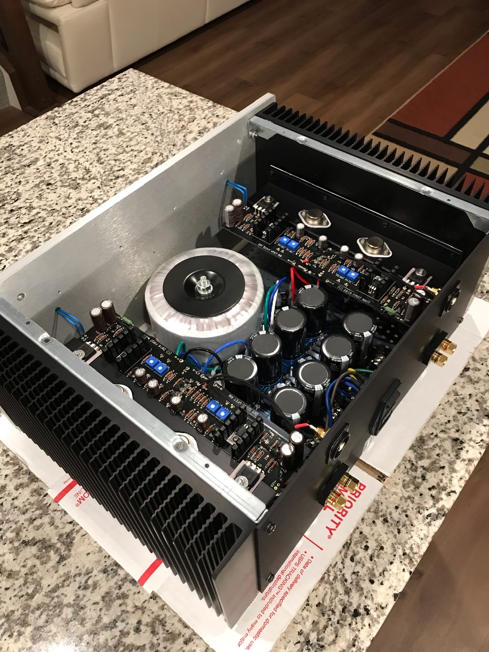

During the height of the pandemic last year, a couple friends living across the country and I decided to have a virtual group build project using weekly scheduled Zoom meetings to build Mr. Pass’ Aleph J design. Having built a Pass DIY Sony VFET amp using complementary pairs of the Sony VFETs two years prior, I was able to lend some guidance to my friends in building their Aleph J amps, and everyone had a great time talking all things music and audio while we all lived in isolation. We are all now huge fans of the Aleph J amp and listen to them in our systems.

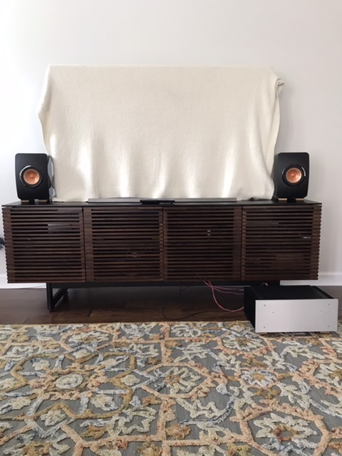

In my living room, I have a second system using a Raspberry Pi 4 running Volumio as my digital streaming source. This feeds a modest Encore mDSD USB DAC that is connected to a Pass DIY B1 Korg NuTube line stage, an inexpensive, modified Aiyima A04 TI TPA3251-based Class D amp and my KEF LS50 speakers. A couple weeks ago, I loaned my Aiyima amp to a friend, so I decided to install my Pass DIY Sony VFET amp in this system. I had used this amp with the KEF LS50’s before in a smaller living room arrangement. When I connected the Sony VFET amp to my system in a much larger space, I was floored by the ability of this amp to drive the 84-85dB sensitive KEF’s to room-filling volumes. I am getting floor shaking bass from this amp rated for 15W at 8 ohms and 20W at 4 ohms. The LS50’s have a nominal impedance of 8 ohms, but can dip as low as 3 ohms.
Anecdotally, I would not expect a 15 watt power amp to be able to drive KEF LS50’s to 85+ dB SPL with a clean, distortion-free and totally rich sound. Since I didn’t win the lottery for the latest round of single ended Sony VFET kits, I was contemplating on repurposing these Sony VFETs and get the kits to build two single ended amps. However, I am getting so much listening enjoyment out of this complementary VFET pair amp so much, I’ll stay the course with this build.
I am curious as to how this amp manages to drive these loudspeakers with ease.

Thanks Super_BQ. With the Sony VFET amp, I feel like I have something like a push-pull 300B amp that is well able to drive my somewhat inefficient KEF speakers with ease. The pairing of this amp with the B1 Korg NuTube line stage is very musical and smooth. The soundstage is huge and deep belying the size of the KEF LS50’s.
