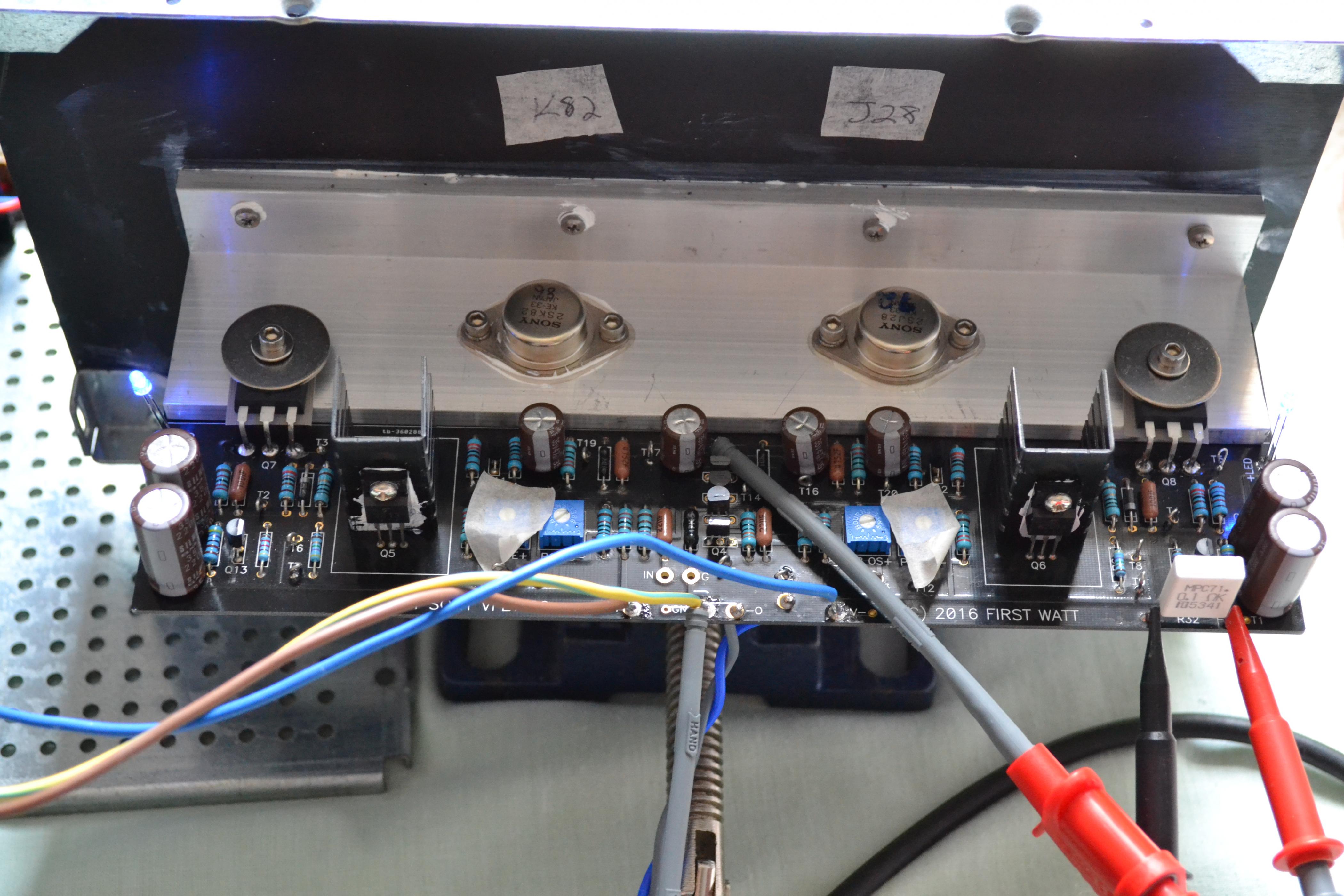

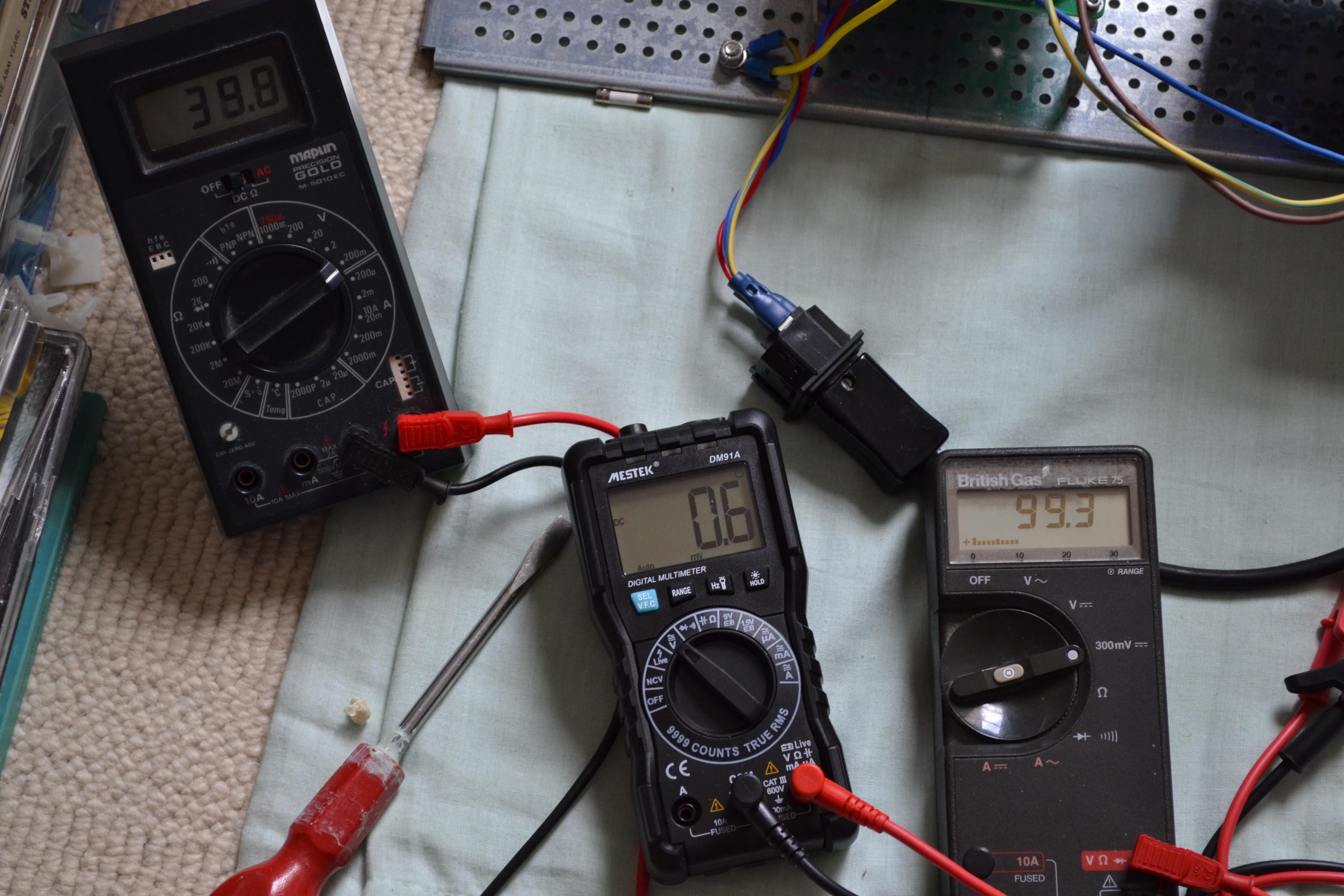

The fun never ends. I have one channel that stays sub 50mv (DC offset) from cold to hot. The other channel starts at 125mv (DC offset) and .900MV (t18 to ground) cold only to go to 5mv(DC offset) and 50mv (t18 to ground) hot. I suspect I'm going to back track and revisit P1 and P2 and R32 before trying again.

What'ss the DC offset at the speaker posts?
I've revisited adjusting P1 and P2 again and their accompanying voltages across R5 and R6 and so far a huge improvement. Of course temperature and time could change this. Takes at least an hour or more to really heat up.
And then I have to let it cool down and retest. The main challenge previously was it's cold start up values.
More soon..............🙂
Dan
Can you get the offset to 50mV on the Fluke with the amp hot? If yes, you’re good. Listen to music and be happy.
My amp does the same thing. Coincidently it is also the right channel that starts cold with high speaker DC offset and high T18 voltage. But they drop down to acceptable levels once it's warmed up.
As I also mentioned in a previous post, these values vary from day to day, even hour to hour, so I stopped obsessing and just listen to the music.
