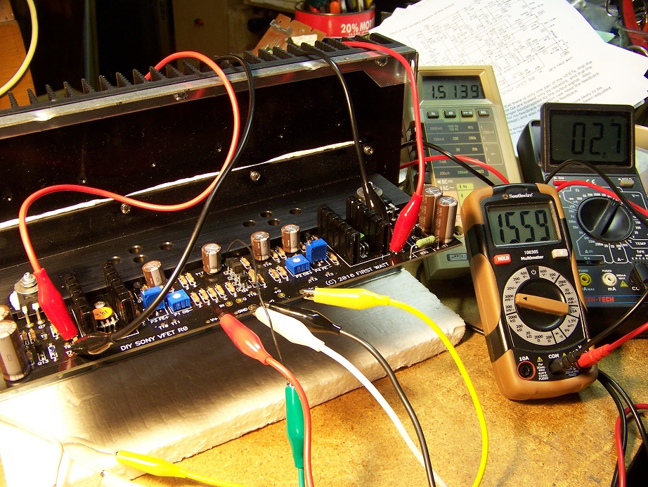

Powered up and setup the frontends of one then the second pcbs.
Got 1v5 on R5 & R6 with T18 sitting at 2.7mV.
Then setup T16 & T17 for the VFet bias.
(This was tweaked to these settings after a 2 hour warm up).
Tomorrow I will install the VFets and continue
with "PART 4 INSTALLING VFETS AND ADJUSTMENT" 🙂

Uh-Oh! Bad ju-ju!
-Not good. 🙁🙁
Installed VFets.
First board biased up perfect.
Problem with second board.
Voltage across R32 will not go over 7mA.
Here are voltages on all test points.

Hi Ichiban,
Your T4 and T5 values are bad, so I'm guessing you have a bad TL431 (Q14).
Hopefully others will chime in.
Dennis
Dennis

Hooray!!!
Resistors checked out ok.
Replaced the TL431.
So far voltages looking good &
the voltage drop across R32
goes up when adjusting p1 & p2.
Thank you guys for the help.
Now to continue adjusting.
