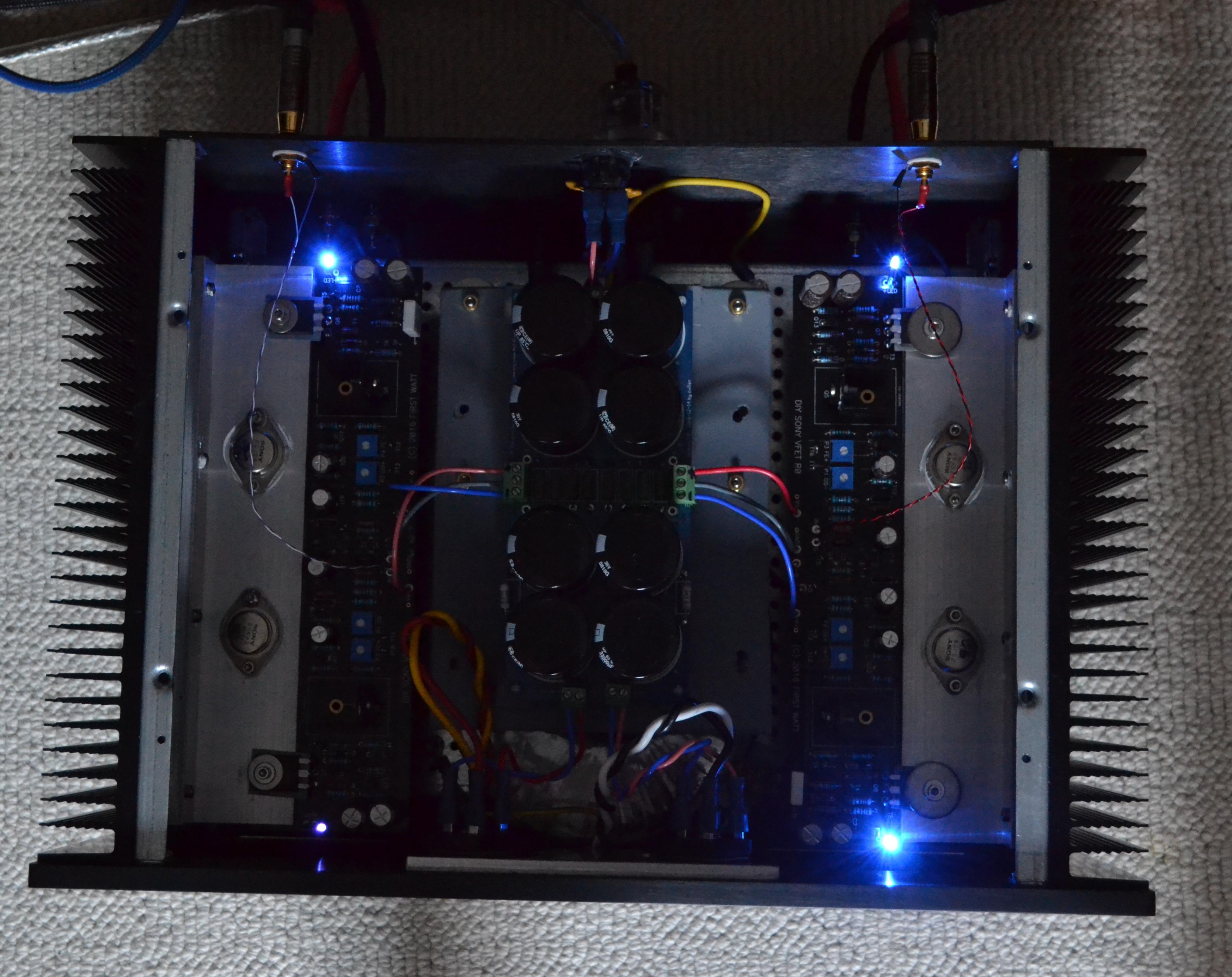

Lift one end of R19 and R20. This does not let current flow thru the IRF's. Set your VFET gate voltages 1V more as in the instructions and adjust FE bias.. Then reconnect R19 and R20 and adjust. Papa suggests this method for the original two pair version.

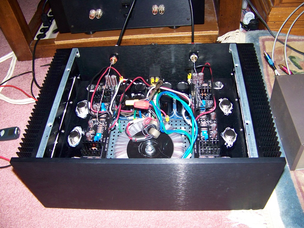

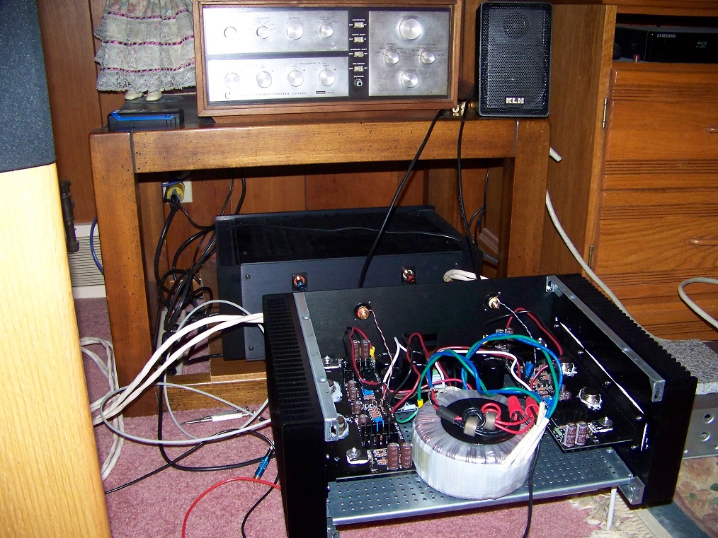

It was a knock down dragged out battle
but,
in the end I got the beast
biased up.
Space is very tight in this 4U chassis.
Have to find something to vertically
mount the transformer and better position
the diode bridges.

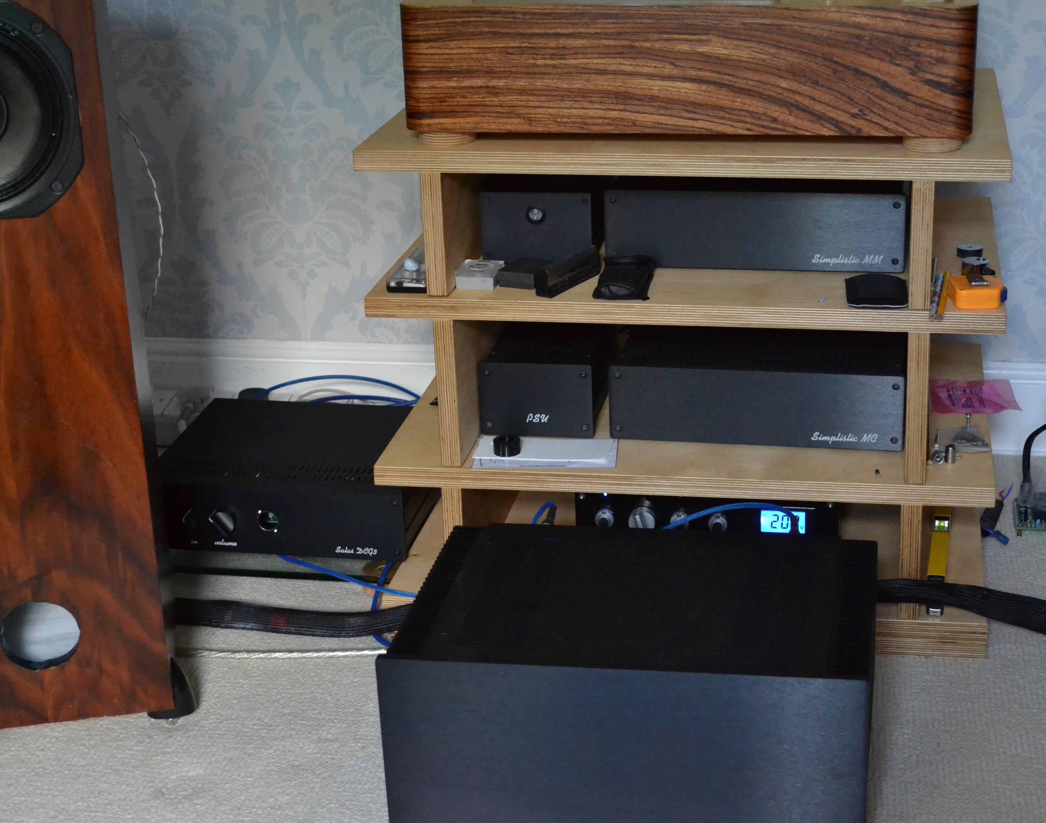

Thank you guys I am happy to say that the amp is now biased up and running. I have been listening to it in conjunction with the B1 Nutube a marriage made in heaven imho. A huge thank you to Nelson for releasing these to the diy community. Like ichiban it has taken me two years to finally complete the vfet amp.
Great! Let us know your impressions with your DCG3.
nash
Congrats! Looks like a U5 case?
@nashbap I will. The pic I posted shows the pre as a DCG3; really must remove the decals but actually contains the B1 nutube. The DCG3 has been rehoused in a wider case to allow the use of Salas Ubib regs.
@ ichiban it is an 4U 300mm case and runs comfortably at 44/45C after several hours of playing music.
Transformer is under the caps?
I was thrown off the size by how
much more space yours seems to
show compared to my layout.
Yes the transformer is partly covered by the cviller cap board; rectifiers are mounted on the back of the front panel.
Nash thanks for the tip re lifting R19/20 worked a treat.

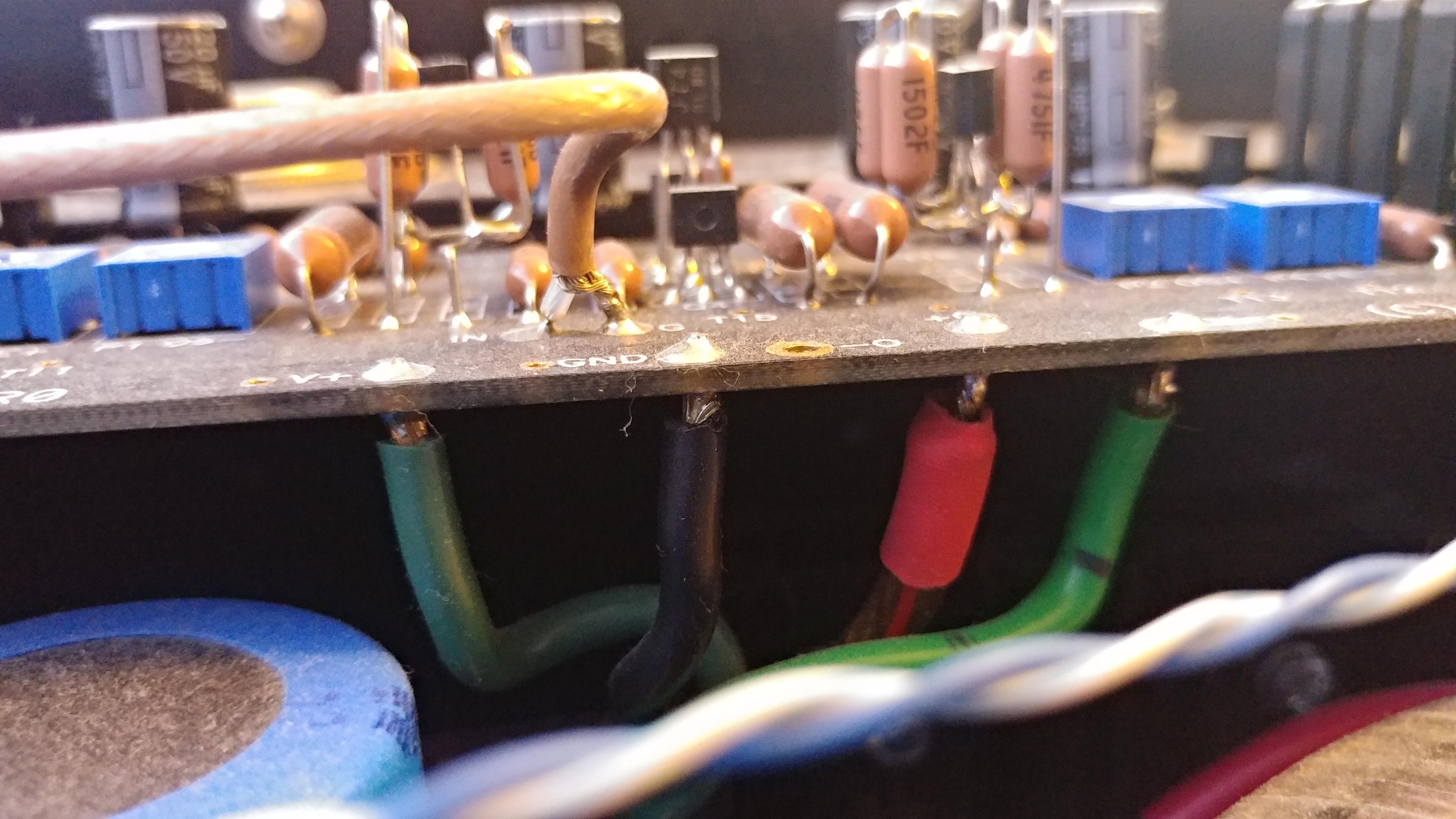

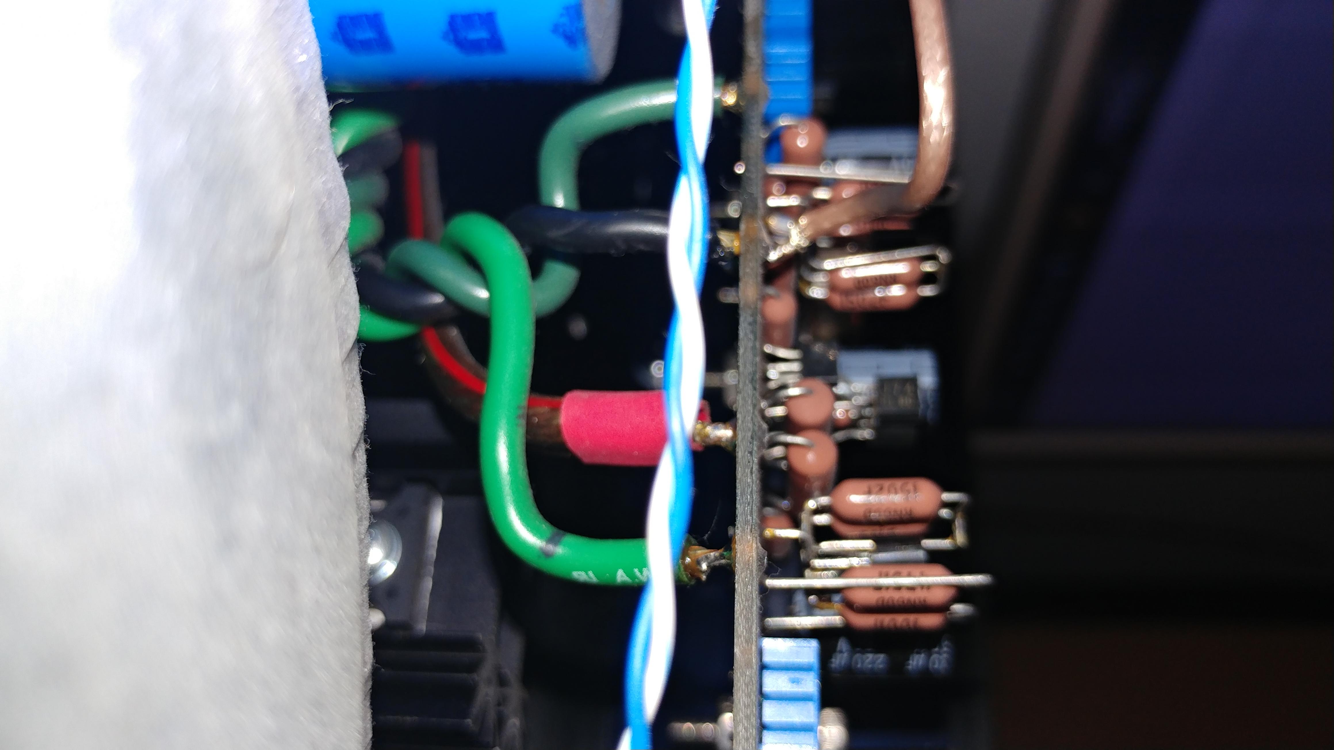

Good afternoon,
I am currently rebuilding the PSU of my mighty V-Fet Amp. When I dismantled the amp, I saw that I'd used veryvery thin cables form the PSU to the amp pcbs and from the amp pcbs to the speaker terminals. The reason were the small bores on the pcbs for that and I wanted to change this now. Since there is no plan to enlarge the bores ;-) I was lookin for cable shoes that other end fit the bores but I couldn'T find some :-(
So what I made me happy, if some experinced guys here might show their solution.
Cheers, Ernst
Cheers, Ernst

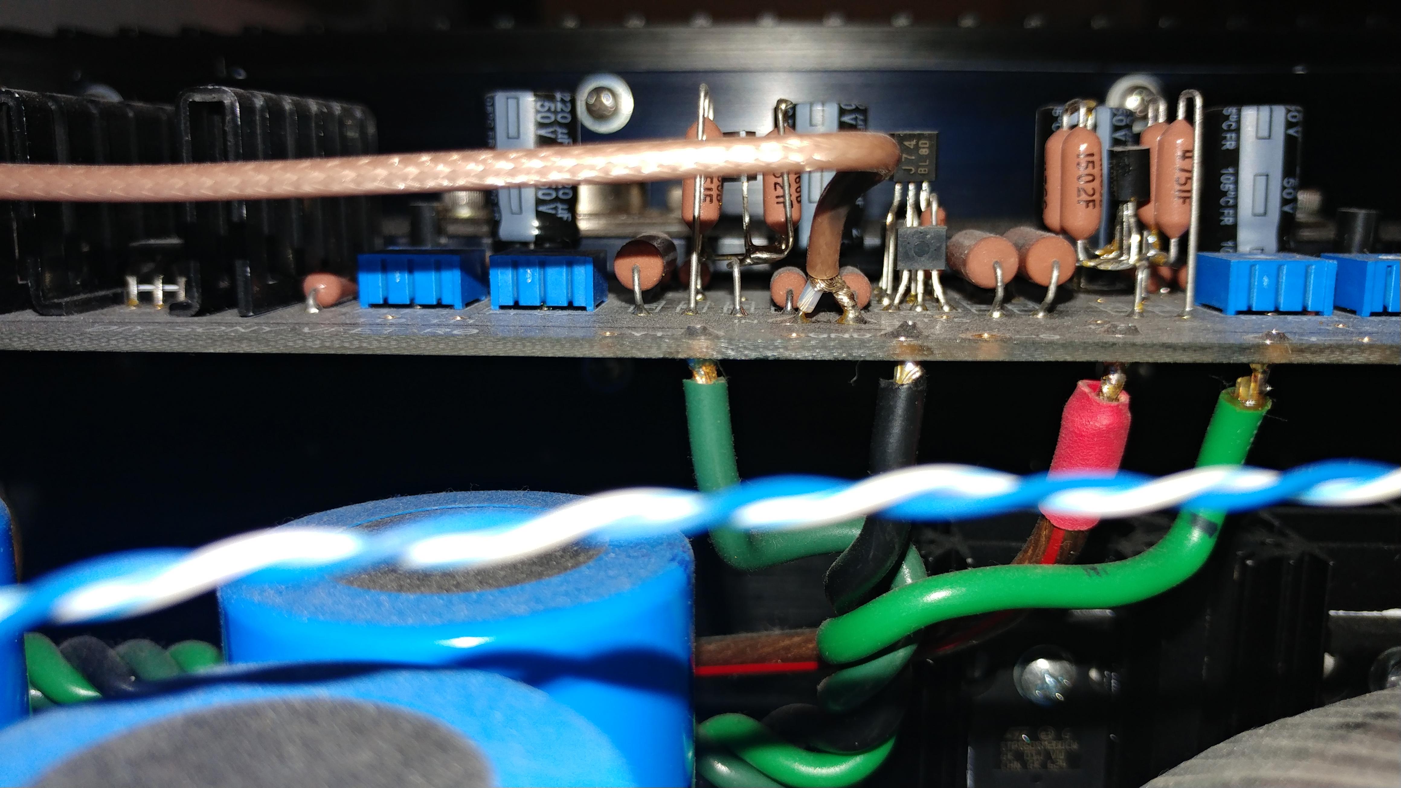

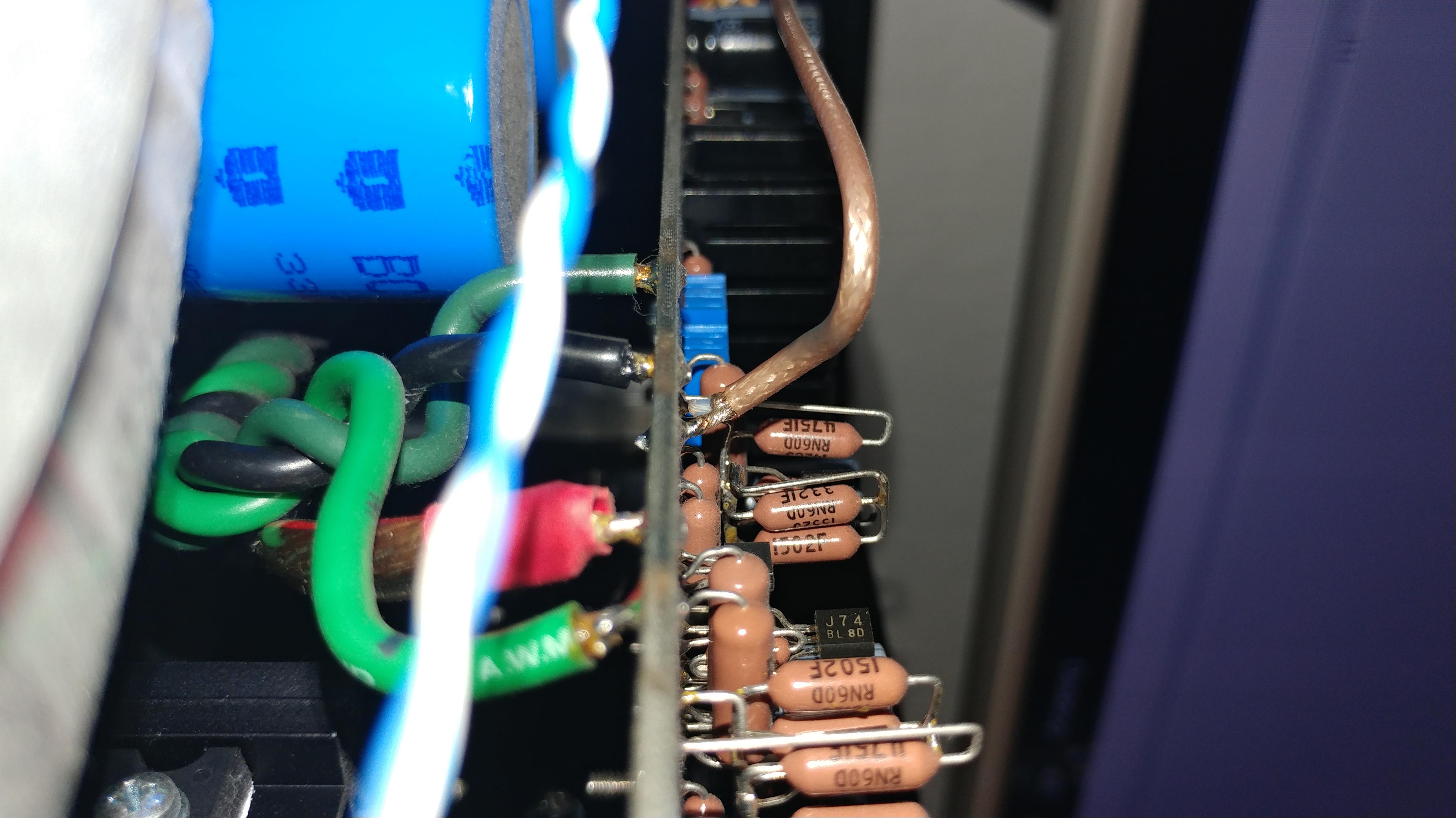

It's a bit hard to capture, but take a look at the attached pics. When the pcb eyelets are too small for the cable diameter I want to use, after stripping the insulation I simply remove as many of the exposed litz wires as necessary to be able to fit the remaining ones in the hole.
In other words, don't use all the strands for making the solder connection, just as many as fit the eyelet, and cut off the rest (before soldering of course).
I do the same thing, but wish PC board designers would up the hole size to at least 14 gauge wire. Or give us two holes for each connection with a larger one.
